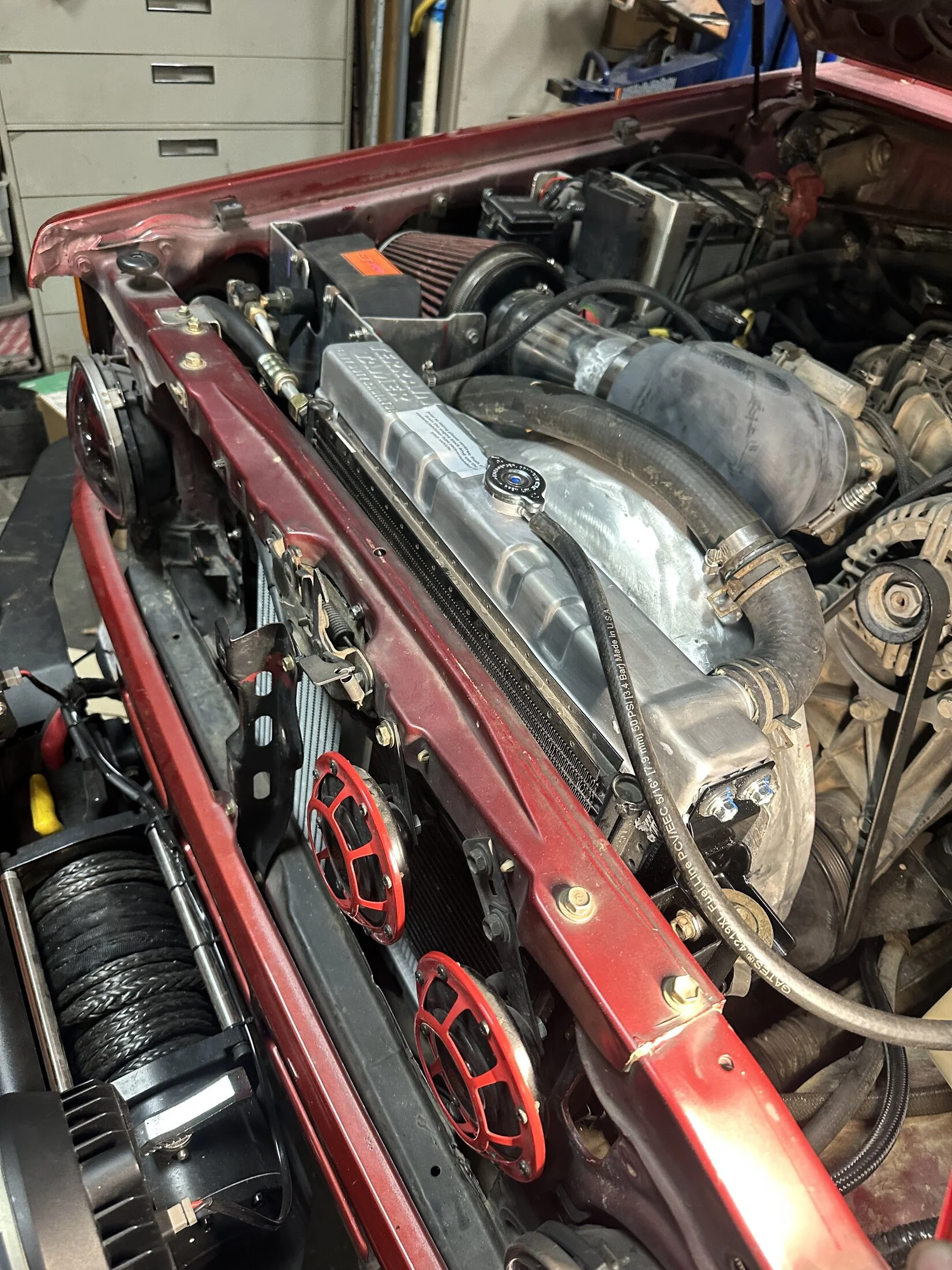

Ended up buying a terrain tamer radiator…. It appears to be a very nice radiator.

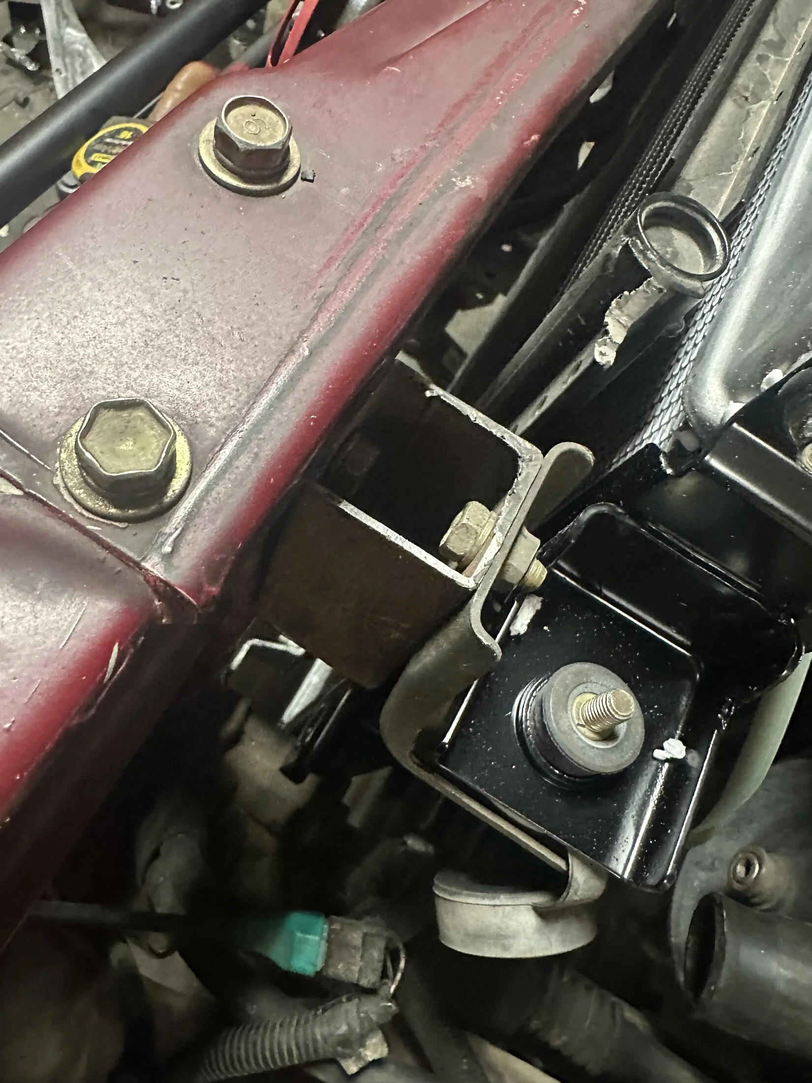

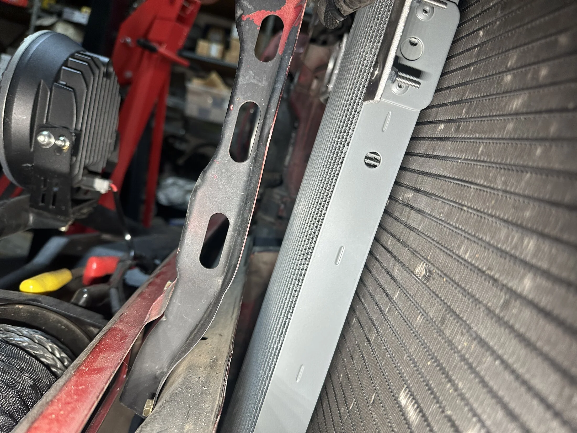

Because the original OEM radiator set up had a different spacing from the front, added inch and a half spacers. And my original shroud seems to work fine, had to modify all the attachment points.

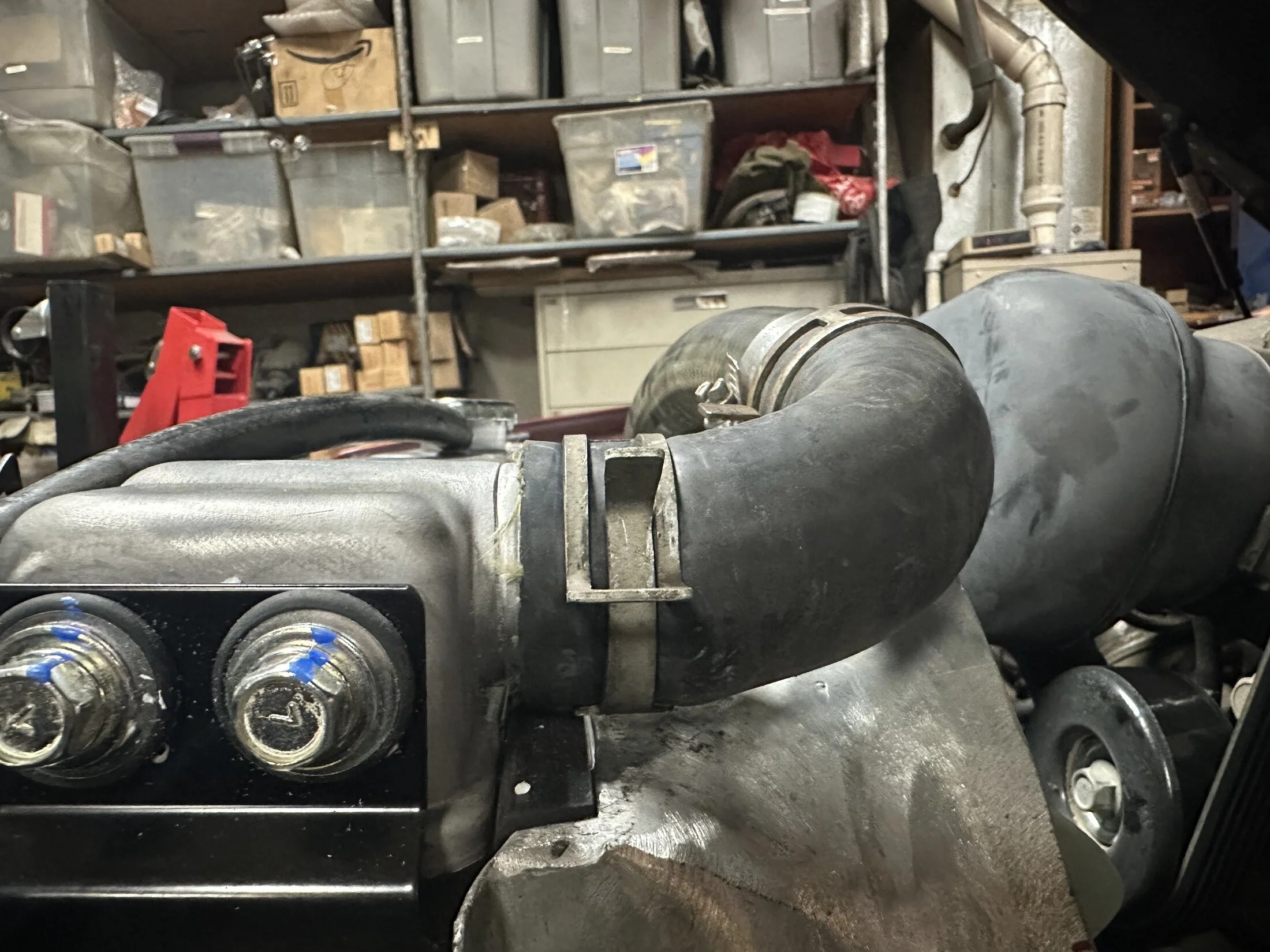

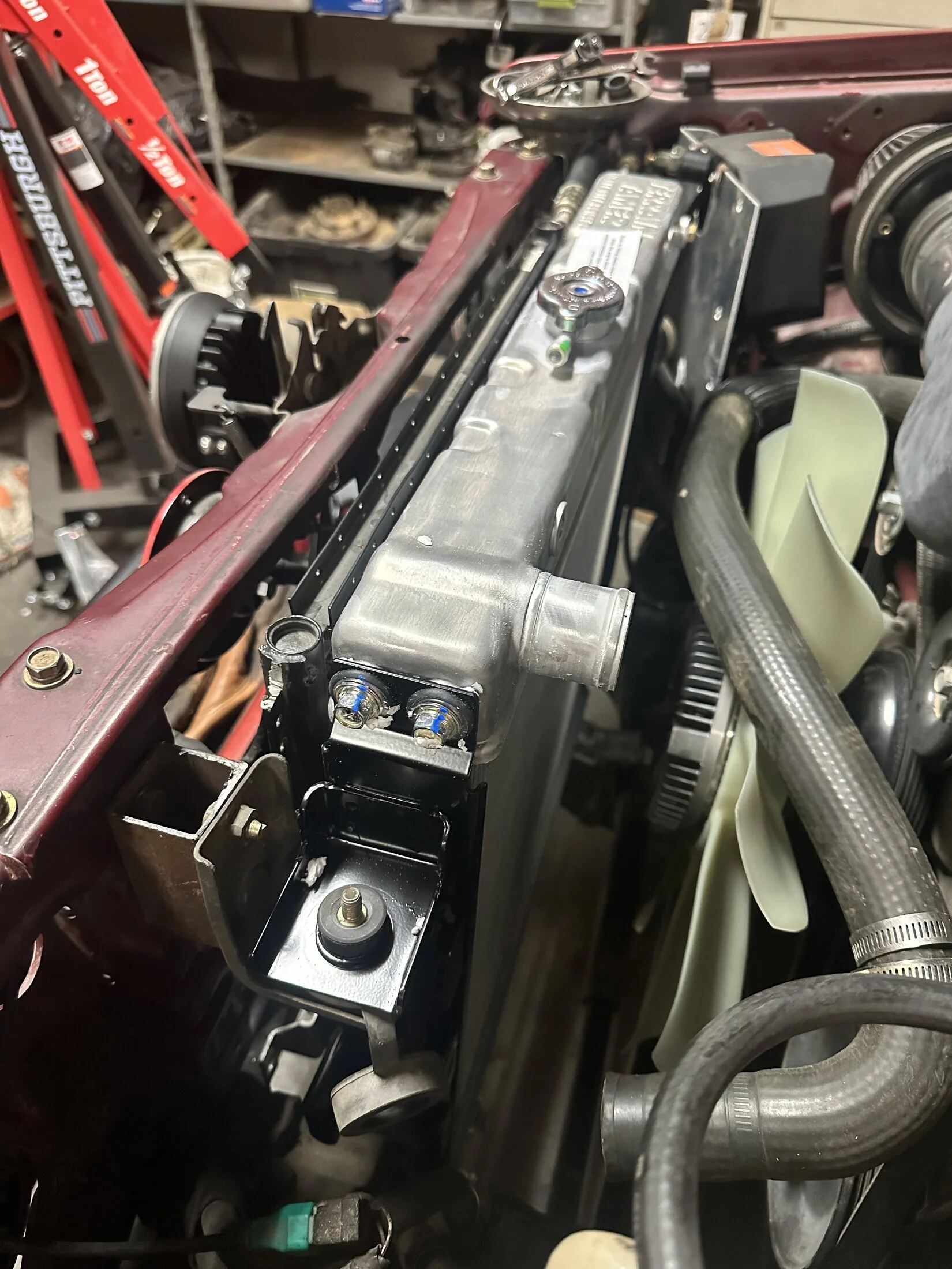

For those that want to know the inlet and outlet are both 1.5” as you see on opposite sides of the radiator. LS swaps need inch and a half at the top so bought an adapter and an inch and a half 90° rubber hose. Dayco 70541. It also has additional ports of the top. I believe they’re 1/8 inch NPT, will confirm after I buy some parts, as it did not come with any extra plugs or barb fittings.

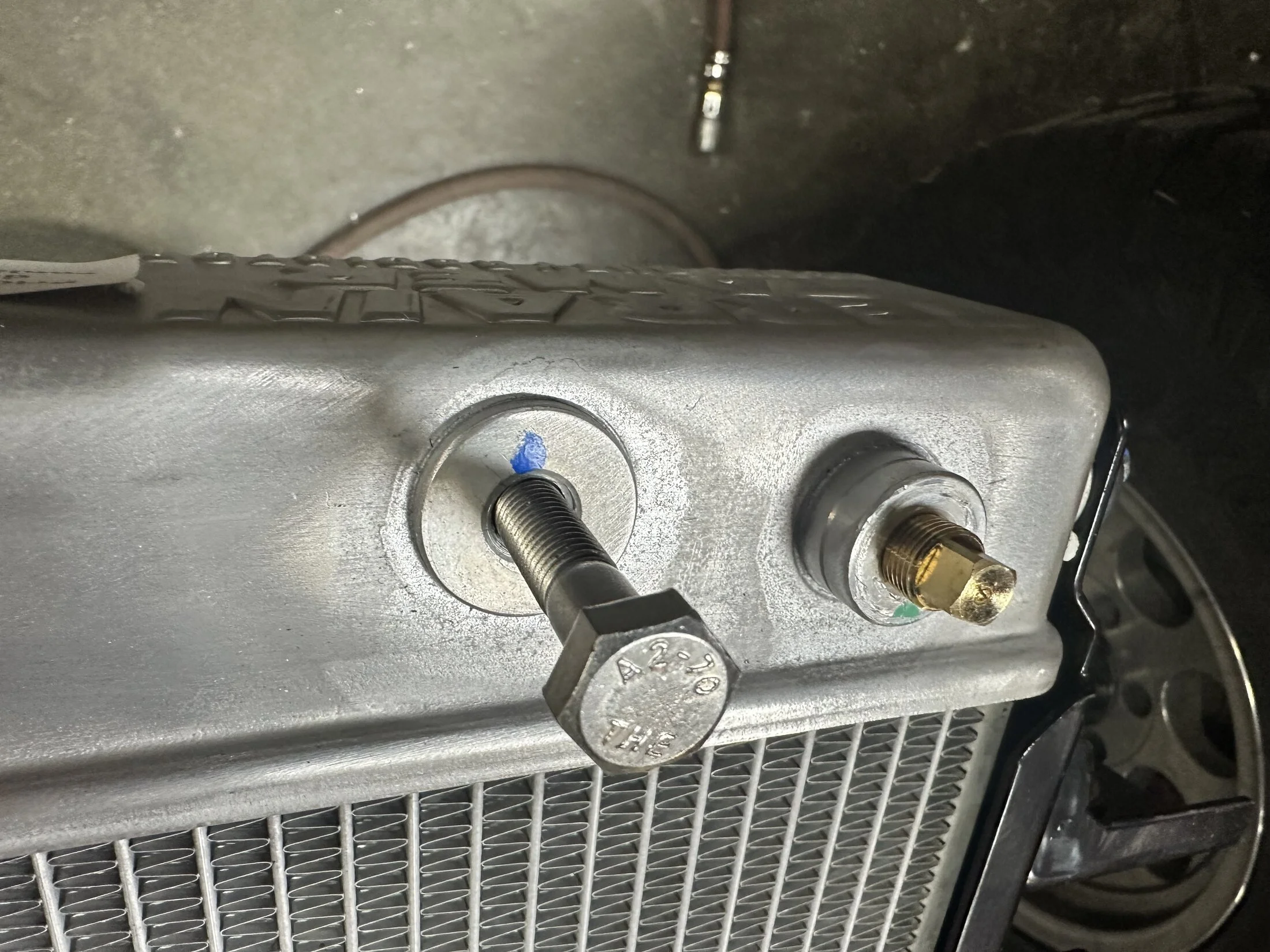

Well, the fittings are not 1/8 npt. Anyone know what they are??? I’m guessing metric…. I could tap them, but really on a brand new radiator….
Well, silly me, two of the three ports the top are just made for bolts so they don’t go into the water chamber. M 8 x 1.25. The one on the right is 1/8 inch NPT.

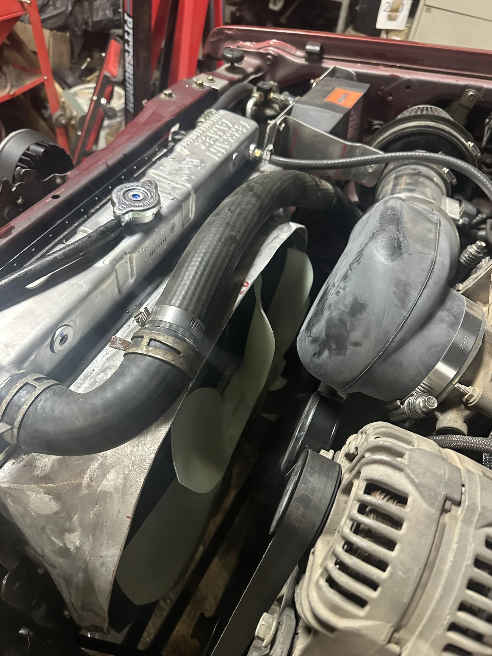

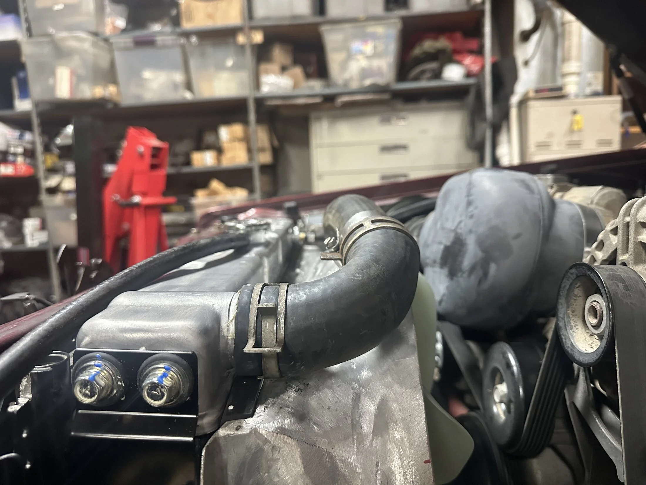

Got a few other projects going on, but finally made time to get Inigo put back together. I used an Amazon sourced transmission cooler…. No longer have a cooler in the radiator. I’m going to have to watch to make sure it is enough. Question to the masses, is it going to be an issue that the radiator hose is higher than the radiator? If so, is there a different 90 degree elbow that can get me tighter to the radiator?
Maybe a small metal section with a bleeder valve at the highest point?

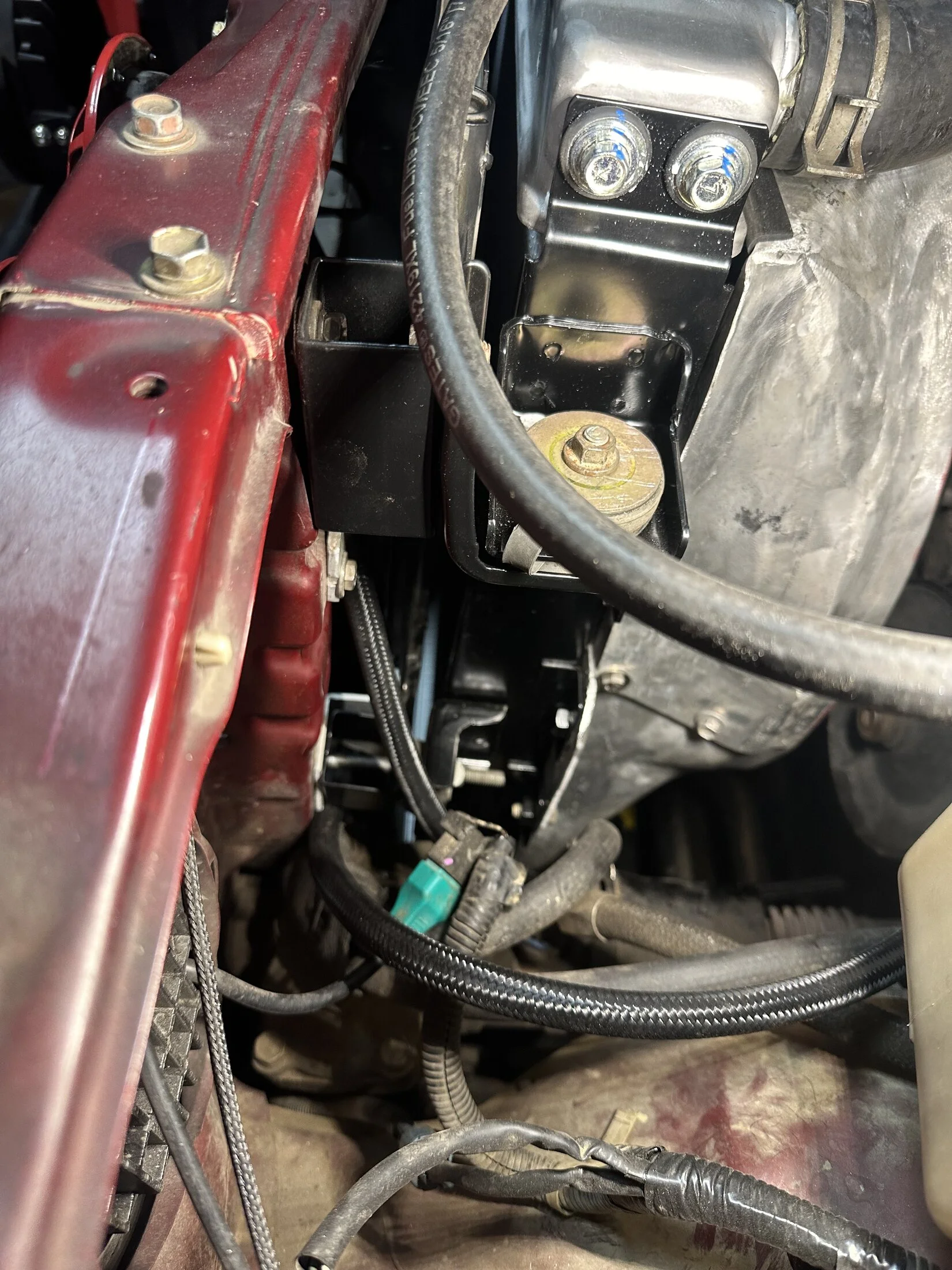

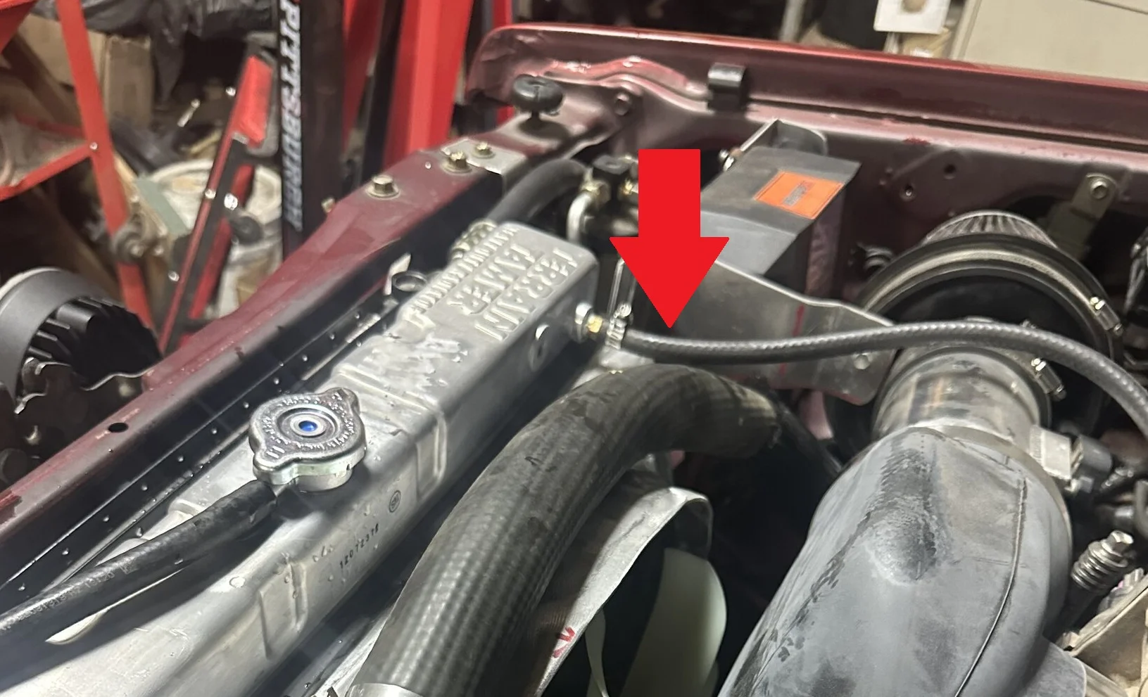

Considering the HD TT radiator as well. What are you using the low level sensor port for on your build? See you had it blocked off in one picture and now a hose runs over your air cleaner piping and down.
Wondered if that port would be a decent enough location for a temp sensor vs. the adapter and sensor in the upper radiator hose.

So your new rubber line on the TT radiator runs to an aftermarket gauge?
This line. Terrain Tamer lists it as a low-level sensor port >>>

Not ideal but use a 2H radiator, don’t know if the 3B has same as a 2H
I should have been more specific incase you aren't familiar with the 2H. the inlet is on the same side as the outlet on your engine, therefore you don't need to have a long hose crossing over and being too high to prevent properly burping the coolant.

Sorry, that line goes to the LS engine top of manifold connection. This is an LS 3rd gen, so does not have the 4 bleed points on the top of the intake manifold, only one on the top right side of the engine.
Pretty sure the LS has two water temp gauges going to the computer, then I added the Toyota gauge to run the dash cluster. Really don't look at it much, I use an OBDII reader to see the actual temp and other stats.
