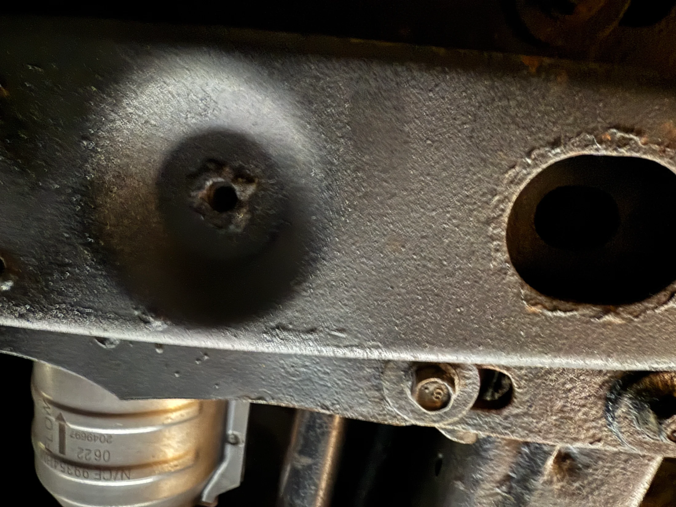

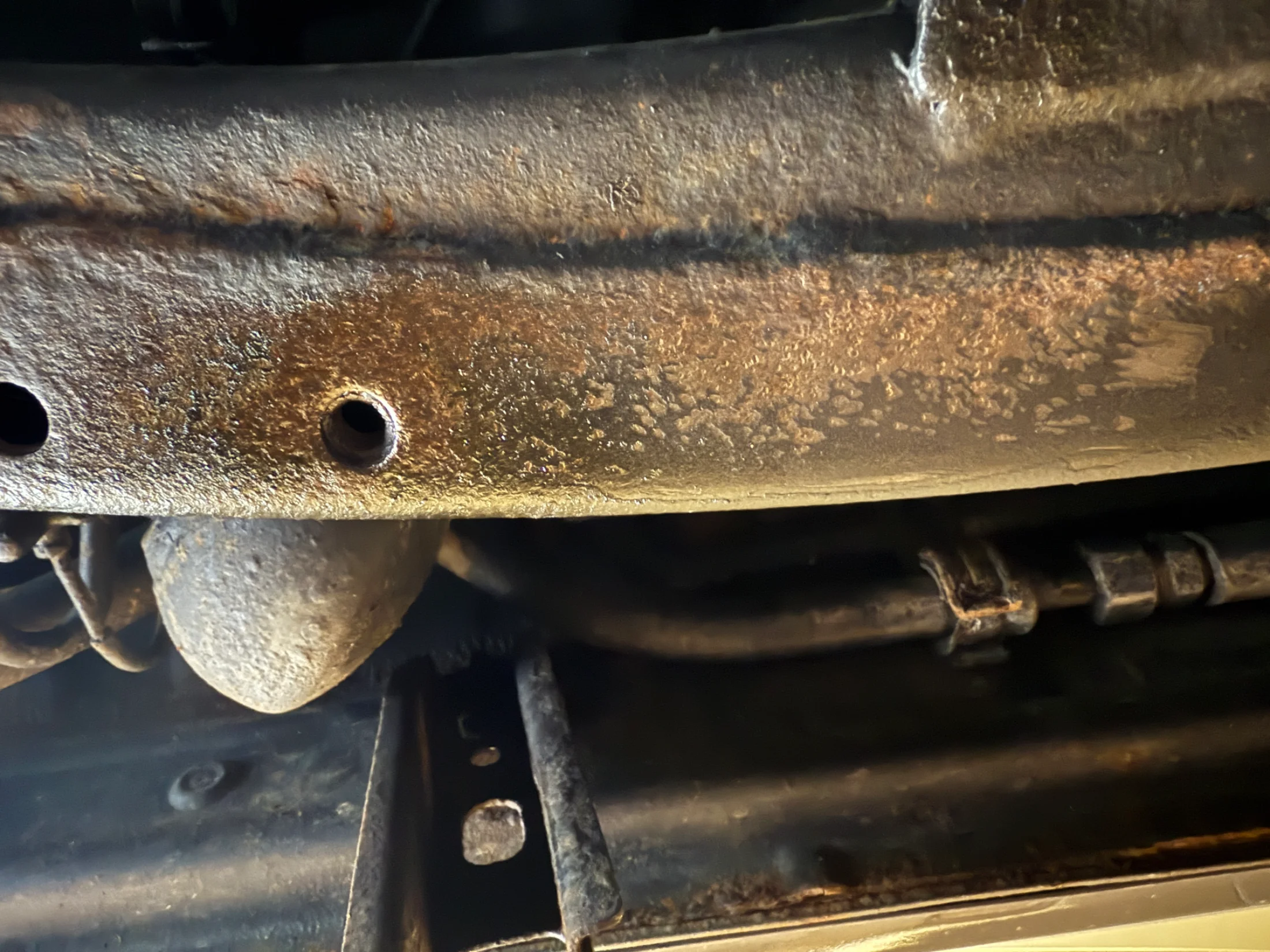

Please post pics for a clearer picture of what we are dealing with here.
Here are pics- drive shaft, passenger frame rail, passenger rocker panel.
Ya- good question. I’ve started using an angle grinder with a rope wire brush. I love this thing, but it’ll take forever. I’m also using a hand wire brush, screwdriver, hammer etc. I’m 71 next week, so I don’t have the stamina or strength of you young studs. Not complaining, just sayin.
I used dry ice blasting. It got me down to a super clean surface. I then treated it all with rust converter. After that, high solids black paint. Totally worth it.
