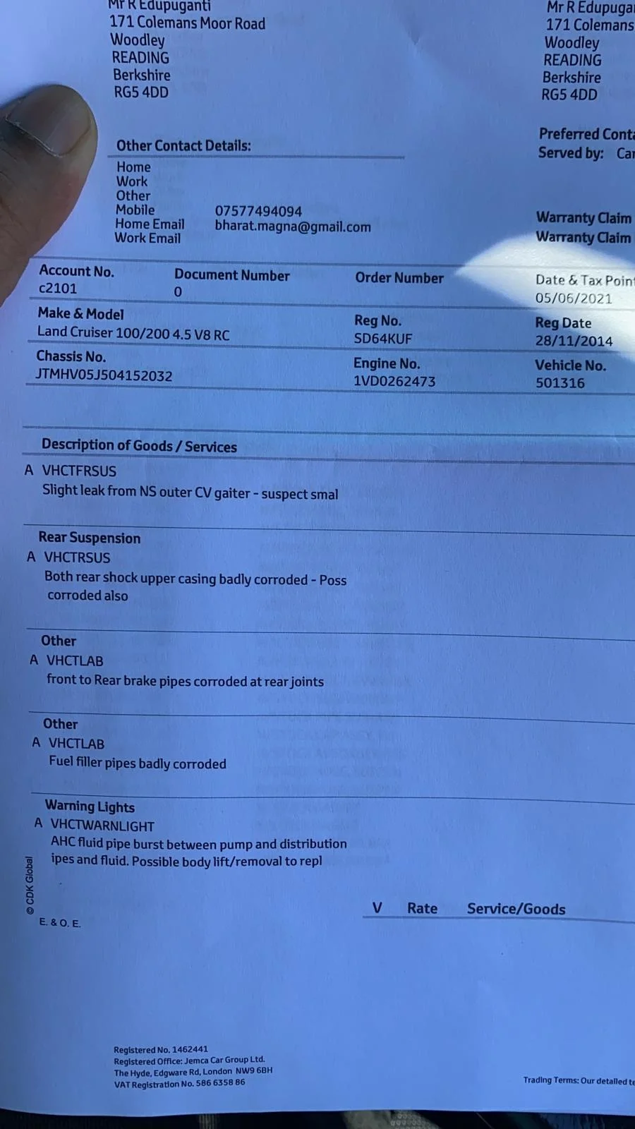

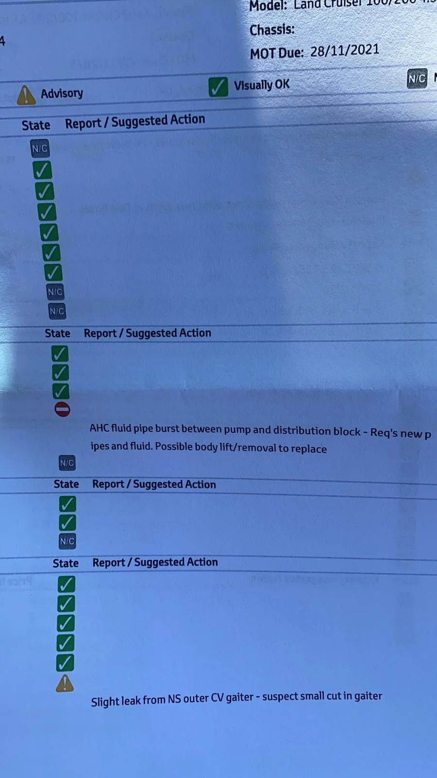

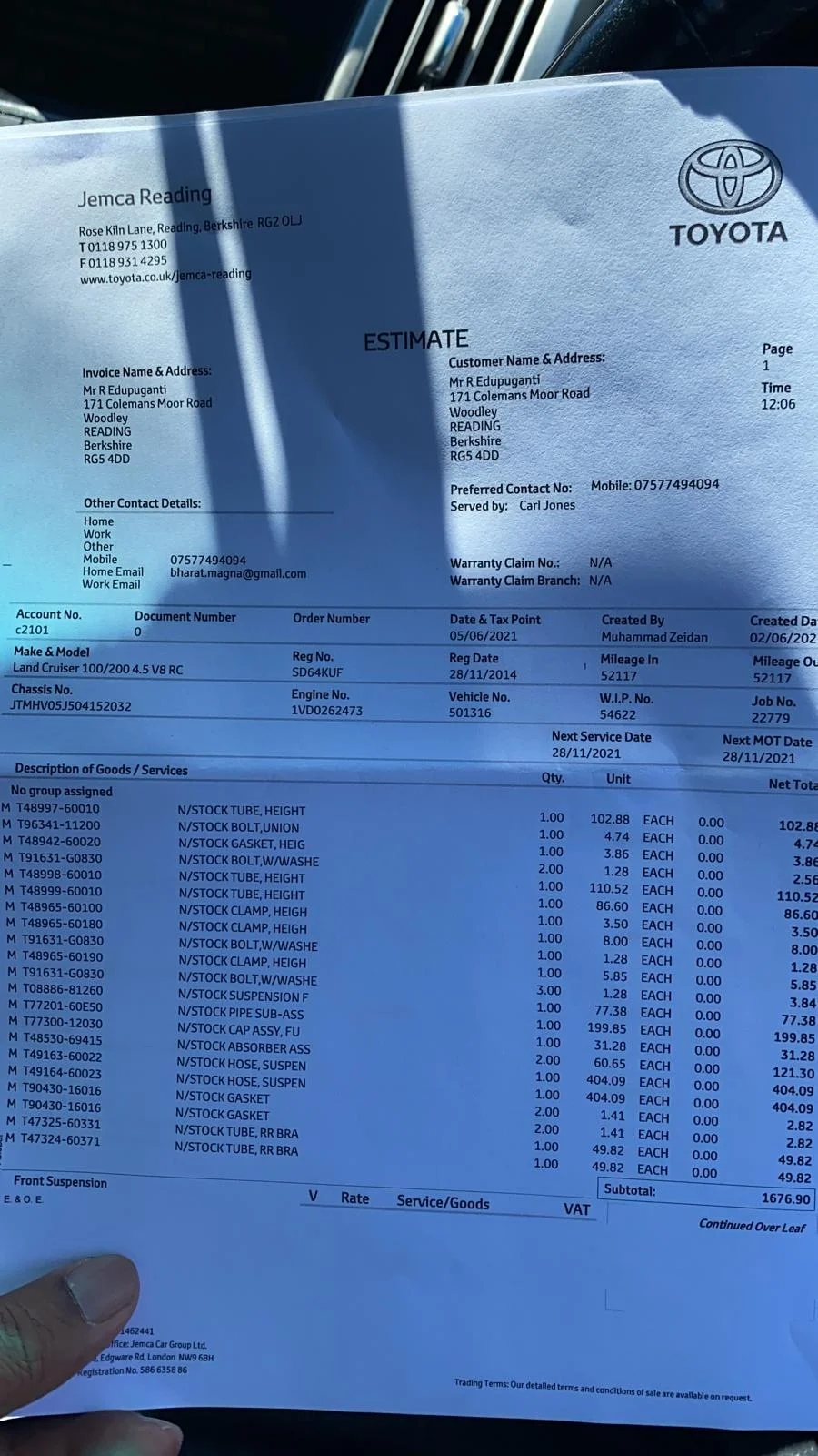

Got my car on 17April21. Its a diesel 4.5V8 with AHC suspension system. In UK market we dont have KDSS. After driving about 1000 miles on good roads, I got '4 wheel AHC system check' warning light. Front end came to its lowest position but not scraping wheels. Rear part looked fine. Took to a garage near by and he told all suspension is rusted, hydraulic fluid leaked so change suspension system. I was bit doubtful about it and took it to Toyota dealer. Dealer called me the next day and explained me that the suspension fluid pipe burst due to rust. All the small pipes that run from front to back, like break pipes, fuel pipes are also corroded badly and to do repair body has to be lifted from frame and all things to be fitted. It might cost about 15000£ to start with and can go up as the work progresses. I was told, even after all these repairs there is no guarantee that the car will be good enough or reliable. In a way I got the message its not safe to drive even after all those repairs and its gone case. The engine starts with one click, sounds good, all other systems work good.

Hey, for 15k gbp, the shop just doesn't want to do the job. You can source all the lines for far cheaper off Partsouq or Amayama.
Alternatively, you can AHC delete compeletely. It used to be you'd have to drive around with the warning light but Turbo8 on this forum figured how to delete. I've seen UK 200s with AHC deleted. If you want theres a shop in Southampton that I know that did a AHC deleted 200 series.
Not the end of the world. 1500 gbp in parts and some labour, and you're back on the road. I don't think you'd fail MOT if you had dummy warning light on.
Here is the thread: Disabling the AHC and AVS systems, no warning lights. - https://forum.ih8mud.com/threads/disabling-the-ahc-and-avs-systems-no-warning-lights.1164357/
Its your choice of AHC delete or if you want to redo your AHC system. AHC rides heavenly whereas the traditional suspension will be rougher.

The Toyota dealer said all the pipes (break pipes, suspension fluid pipes and fuel pipes) to be replaced. I have no idea how a rusty pipe looks. This is the first time I am even looking at underside of a car.

This looks like truck that was frequently driven in Ocean salt water and never rinsed off... never seen this much rust on the lines even on my Chicagoland driven 21 year old Land Cruiser

If thats a 50k mile 200 series with that much corrosion, thats definitely a mariners Land Cruiser. It definitely lived by the seaside coast where the ocean water splashes on the ground during heavy weather, hence 365 days a year of exposure to salt.
Sure the US people see cars that have lived by the coast but UK coast cars are a different story with the amount of rainfall and heavy weather they get near cliffside places. You still have a lot of life in the Land Cruiser. But hey, since you're in the UK, you've got less than 10 LC200s for sale at any given time.
I agree with others regarding removing ahc and moving on to a regular suspension. I prefer ahc, and it is typically economical to repair, but with imminent failure of multiple hardlines I think you should go with a typical shock and spring system.
As to the brake, fuel, and other hardlines, those are safety concerns and must be replaced to remain in service. Whether the body still needs to be removed at that point I don’t know, I guess a lot of it depends how much effort you can do yourself vs a shop and how bad it really is. Definitely you’ll want multiple bids and will hear several different approaches on how best to repair. I suggest a couple collision shops for estimates. The dealer will not be the correct place regarding cost.
You also need to consider how you will mange this already well along rust in the long term. It may be worth it to pay several thousand to have the rust ground off and the frames and body repainted. Otherwise you will be facing additional cost yet issues over time.
This isn’t a Toyota problem, previous owner was not responsible regarding rust prevention.

The video didn't load for me yesterday, it did today. It looks like the first failed AHC line is one that has rusted through on a few other trucks, this line is paralell to the rear crossmember. If so, it can be replaced without a body lift and the cost is not too bad. You'll find a couple threads on this issue.
Doesn't address the other rusty bits, but it may get you back on the road while you consider options.
