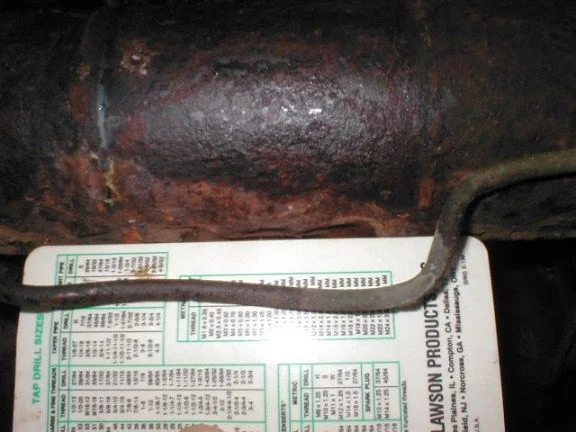

This is why I laugh when people think they're getting a deal with that "ultra low mileage plow truck". Compare this to your FJ25 rear axle.
Sure, rotted out backing plates are fairly normal:
I've seen some serious rot............but a rotted away axle tube? :confused:
I think there's about a 1/32" of tube wall thickness remaining here. :eek:
I'm sure gald you posted these pictures up otherwise I would never get a change to see anything like this out here in dry Arizona. Is this off of #48?
