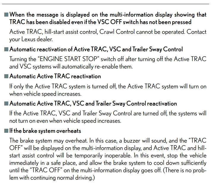

From the 2014 LX570 manual
TL;DR - At a stop
- Short press of Trac Off button temporarily turns off Active Trac systems. It will re-enable automatically when speed increases (~40mph)
- Long 3 second press of the Trac Off button turns off Active Trac, VSC, and trailer Sway Control. It will not automatically re-enable.
