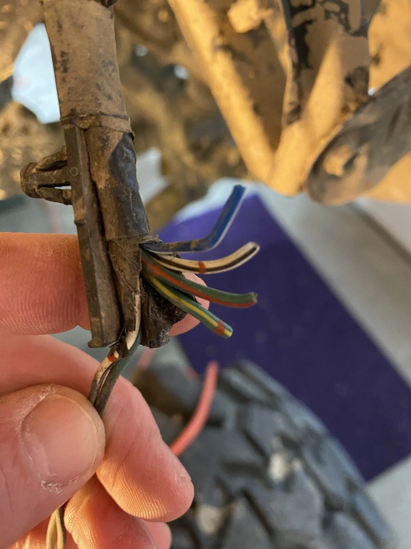

Would someone possibly have the wiring manual similar to a 1989 truck? I can’t seem to find a Toyota wiring diagram that matches up. I have these 4 wires on the passenger side as opposed to the two on the drivers side. Trying to figure what goes to what. These are for the turn signal light that would live on the front of the truck below the headlight. Thanks.
Horn wires. WB is ground. Green red goes between the horns and green white is the feed from the relay.
White blue goes to the a/c pressure switch maybe. Do you have a disconnected ac system?
If you think they are to the lights, green black (rt) and green yellow (left) are TS power and green is clearance. White black is always ground
Thanks for the response. I have no AC. Theres not even a compressor on the truck. I’ll do more homework on it.
