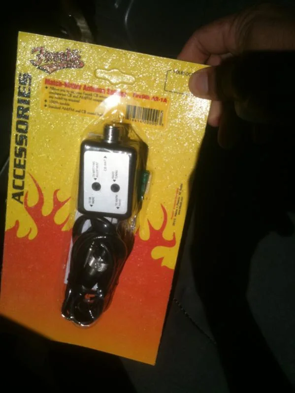

Anyone has the device to properly tune this thing.. Also connects to my am/fm radio

Thanks Jon, yeah my kids gave me the set up so it's going on the truck, as far as the am/fm, it came with the splitters so the antenna can be used for both..
If it's hooked up with the splitters you're not going to be able to tune it to get a reasonable SWR. So you'll be able to hear but other's won't hear you unless you're close. An antenna has a basic design to be used with an 18' cable. Once you change that significantly, you won't be able to tune it properly.

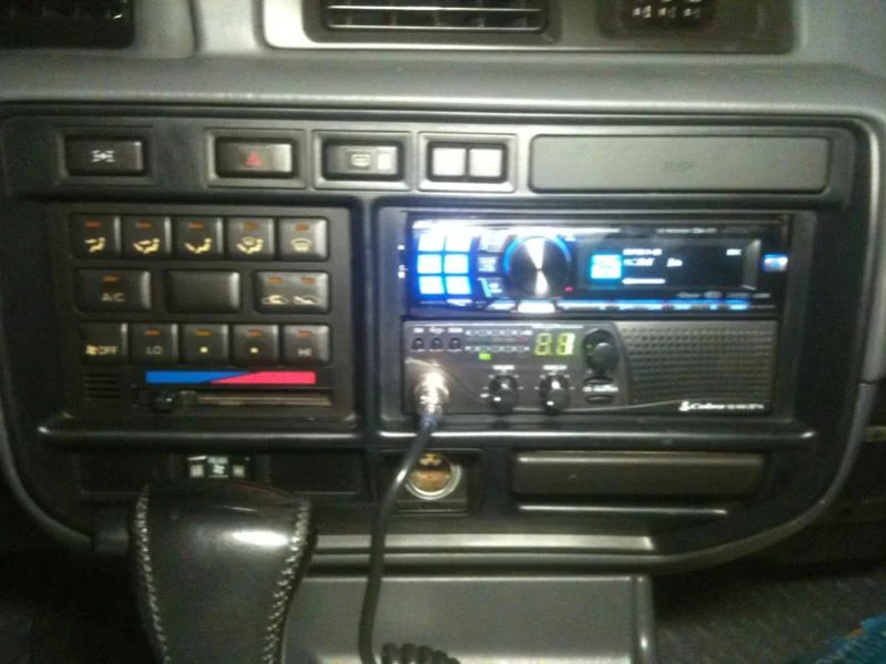

I'm also not sure how your head unit will like getting 5 watts of transmit power into the antenna port when it's not designed for that.

Didn't realize you were using an active product. When you said "splitter" I thought you meant a cable pigtail.
I read up on this on the Firestik website. As long as you follow directions and tune the antenna before installing the splitter, you should be OK. You'll need an SWR meter for sure with this install. Still don't know how efficient this will be, but CB pretty much sucks anyway ;)

Installed.. Gotta wait for a swr meter since no store in my area had one, so yes I gotta take it apart again when it gets tuned
