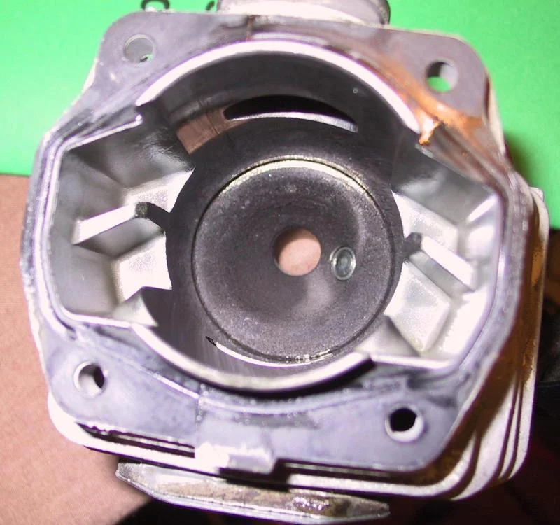

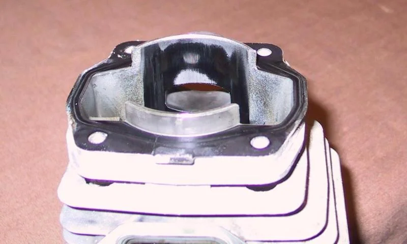

I attach photos which I hope someone can judge. There is a light half-circle under the intake port, and on the top of the cylinder on the intake side, a light scoured half-ring (not carbon like the rest of the top).
2 Scoured, light partial ring top of cylinder head above intake port (lo-res).webp
The intake side of the cylinder is worn out. The white scuffing you see is the chrome worn off.
Look at the bottom edge of the piston skirt. It should be the same thickness on the intake and and exhaust.
The skirt is the same thickness on both sides, at least to within 0.004".
Since the intake side typically gets more wear (airborne abrasives), how far would you typically let the cylinder wear out before replacing cylinder and piston?
Apart from that, with compression at 120psi, is the cylinder wear likely to be the cause of the won't-idle problem?
On account of obvious wear on the piston skirt (worn semi-circular area on cylinder below intake port), I installed a new cylinder-and-piston assembly, but that did not solve the problem.
