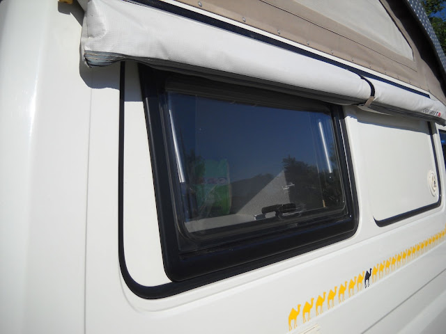

I'm looking to change my rear troopy side windows from the classic sliding to openning out camper type, anyone have experiance of doing this and are there any dedicated window conversions for the troopy..
something like this .... but due to the uneven size of the window frame, looks like I'll need to make it myself...
Cheers
Matt
OK second part of the question, found my prefered windows (Germany SEITZ).... so I'll cut a thick sheet of ali to use as a frame... but I'll need replacement window rubbers as mine wont work...
Any ideas of the Toyota part number for window blanking rubbers ?? no idea of the correct name...

Found the rubbers, I'll post it here if ever anyone needs it..
The window rubbers:
3 weeks delviery after order - price each - €39.12 excl. VAT (Netherlands)
The partnumbers are:
2x 52741-90K03
2x 62252-90K00
cheers
