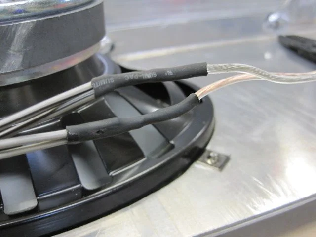

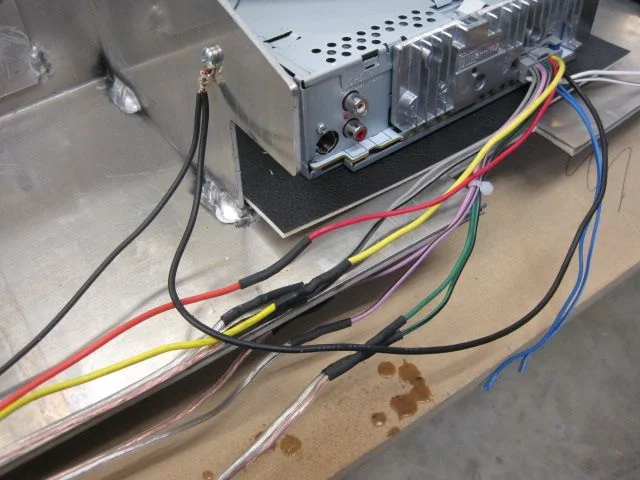

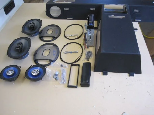

the parts for the upper console stereo ...

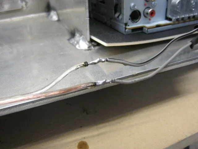

solder the wires
shrink wrap
next

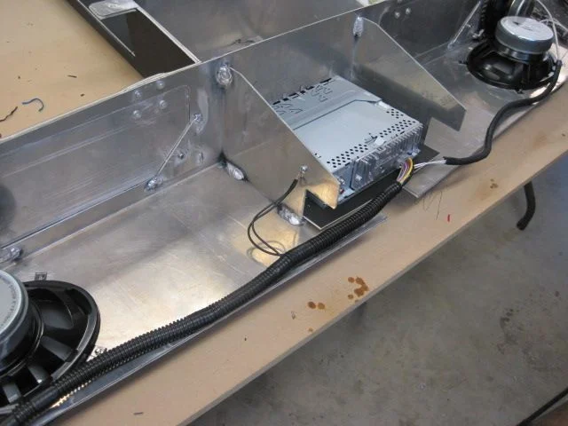

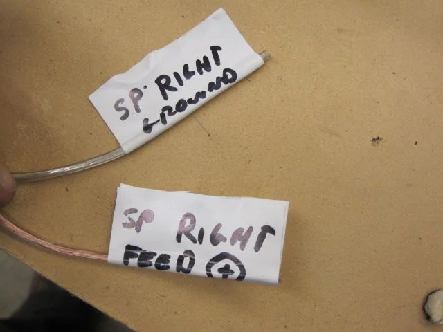

i will be running the wires to the rear console in case the owner wishes to install the 6X9s into the cut outs. marked and ready to play, no need to pull the front console to make it happen.
a mess
cleaner
need to wait for the wire looms, antenna extension and then finish the sound deadner and install.

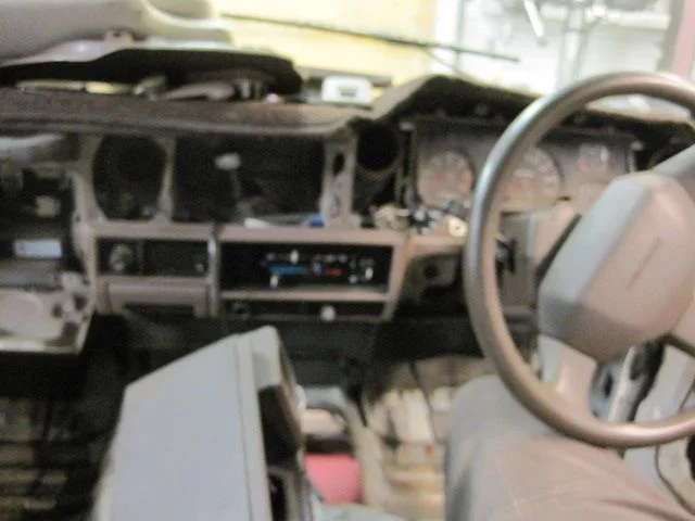

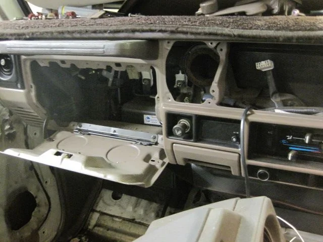

getting ready for the guages and switches ...
sorry for the out of focus pic, not much to see other than the dash torn apart ...

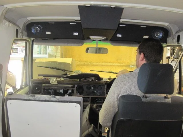

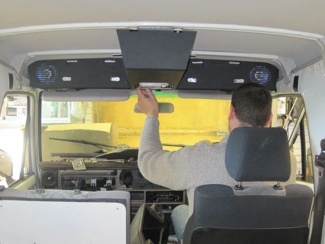

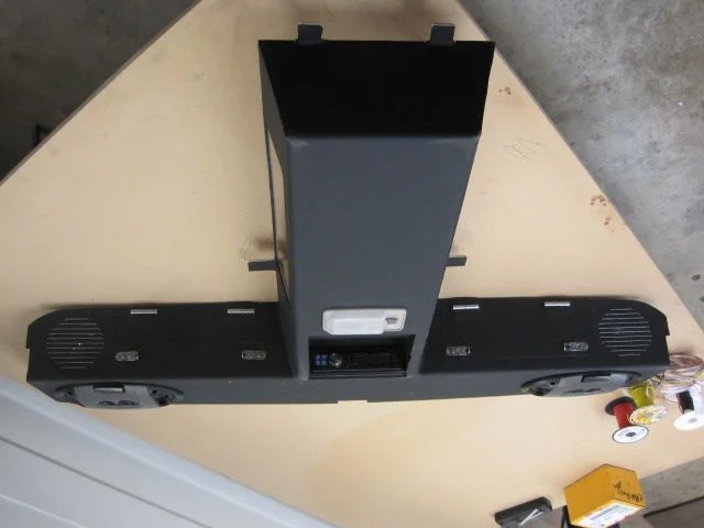

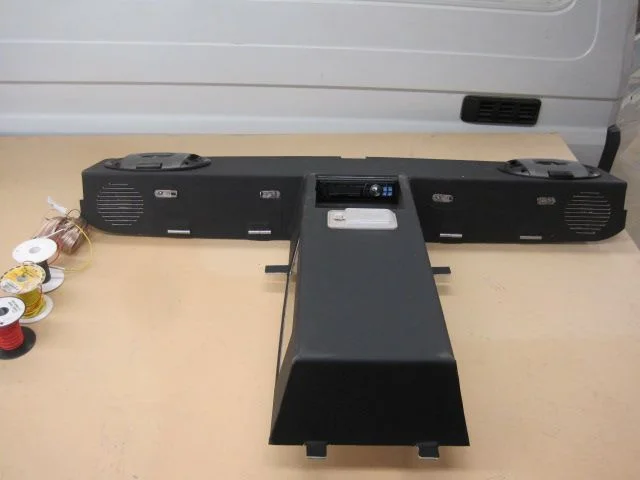

test fit
acceptable, i designed it for the visors to lay flat onto the bottom of the console but the 6X9 speakers sit about a 1/2" down so they now sit on an angle. :mad:
liveable - yes :meh:
happy - not really
i could have done better. :o

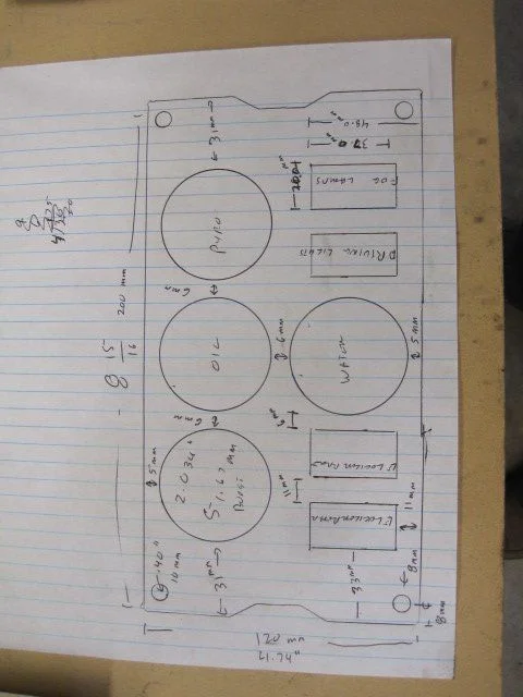

diagram for the gauges and switchs where stereo used to reside...
suggestions are appreciated
sadly, the mounting points are half under the console. i might look at mounting them to the console itself and see what happens.
thanks
:beer:
Some spacers under the outboard attachment points of the visors would likely let them rotate up flat. Not that I'm qualified to be giving you suggestions :D
Is there enough height to mount the 6x9s inside the over head consol so the sun visors can sit flat again . maybe some mesh size 7x10, same gauge as the original speaker covers paint it black and from the inside, sit this over the orignal speaker hole
So from bottom to top you would have sunvisor then shelf then mesh then speaker.
Or do what most over head consol have here in Aus and mount the vison to the consol, just test before you cut or mount ,i have seen one mounted to the consol and it somehow lost the ability to rotate the visor around to the door glass
actually a solution came to my sick mind.
i pulled the arm off the visor and took it to a machine shop. they are going to replicate the arm with a 1" drop so the visor will sit flat onto the speaker.
there is not enough room to mount the speaker inside the console, i looked at that.
i tried putting the visor onto the console but no change was the result.
i will give this a try and ... to me ... it seems like it will work.
