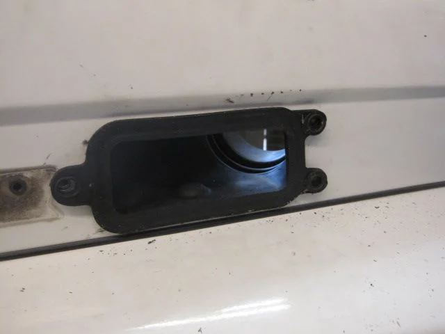

installing the factory snorkel...
no template came with the kit, i knew this when i purchased it from Micheal at West Coast Cruisers. the factory air box wasn't included since he was out of stock, fortunately i had one sitting here for another truck of mine.
make a template
locate it properly
tape off the sheet metal to protect it ...
drill the 4 corners with the proper radius bit.
cut out with a jig saw and clean with a die grinder
fit the rubber connector...
install the steel retainer
install the snorkel (notice i used the nutzerts with SS bolts)
install the factory snorkel air box.
done.

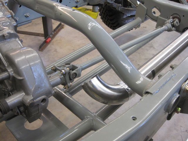

well, i decided to try something i have not done before ... :hhmm: exhaust work.
after getting permission from the owner i located some 16 gauge SS 2.5" pipe to work with ... damn that stuff is not cheap :eek:
i had an idea of how to run the pipe to keep it high and safe.
so one hole needed enlarging, it is reinforced by the bellybar so strength will not be compromised.
so this is a start...
so along the frame and up and over the driveshafts. tons of room around them and between the frame cross member and the t/case.
the front section that came with the turbo kit from Radd Cruisers is an excellent piece of art but since we are going stainless might as well replace it will SS as well.
we will installing a second wall of SS 3" pipe where the exhaust goes through the cross member, where it runs between the cross and the t/case, where it runs next to the shock rubber boot, and anywhere else needed.
there will also be clamps where needed to be able to remove sections.
the hangers will be quality units.
also the SS magnaflow muffler will be installed between the rear shock area and the drilled hole cross member.
more pics later.
of course the whole taped exhaust will go to a profesional welder to be tig together.
that is it for this week.
