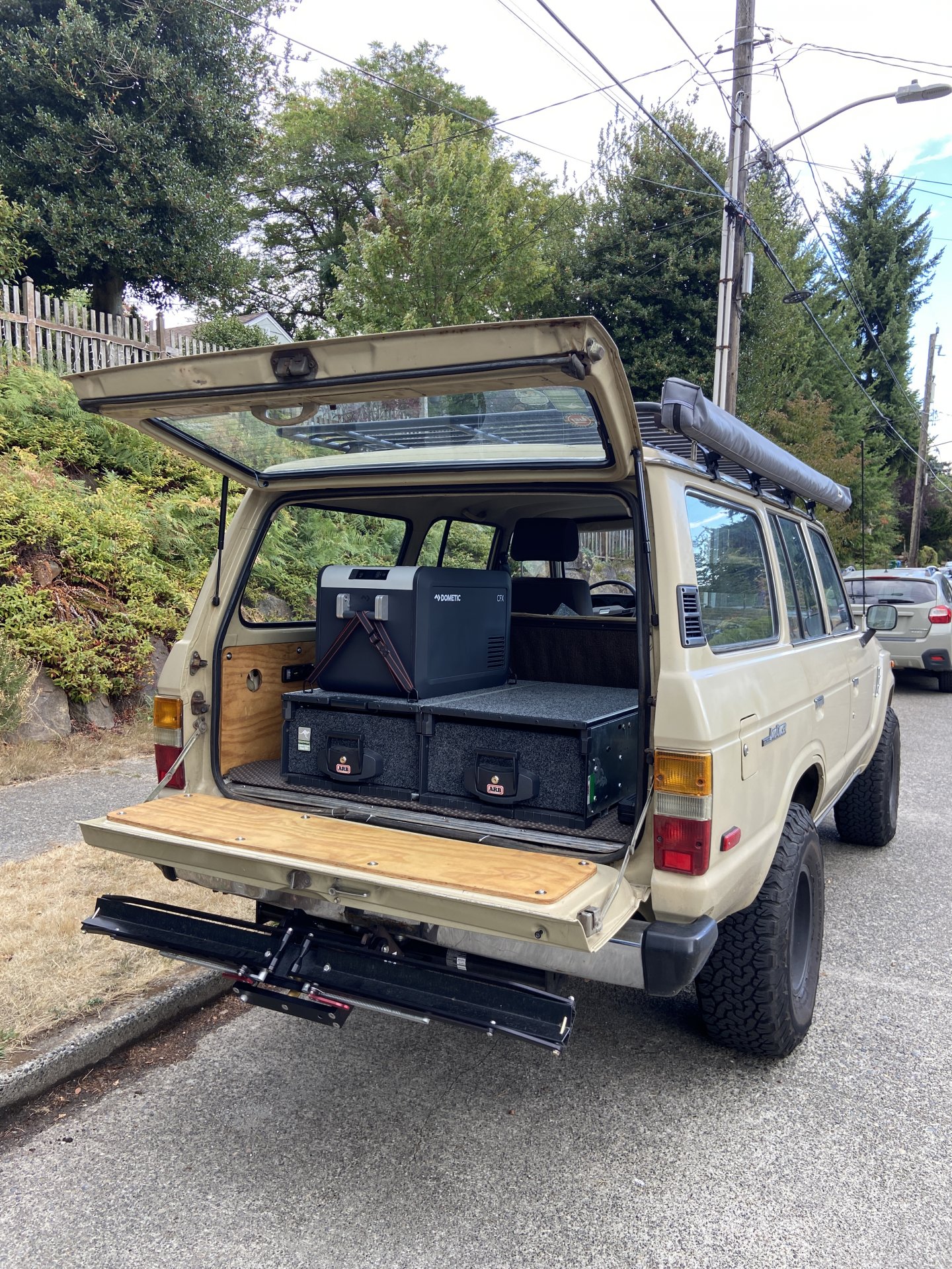

Tonight I tried to make progress on bolting the drawers into the truck. This also ended in disappointment as I lacked the necessary hardware and felt that I was cutting it too close to the gas tank to make the holes I needed. I'm going to do the trip without bolting them down. They'll be loaded down, I'll keep the rear seat back in place, and I'm going to be doing mostly highway miles. It's not ideal but I think it'll be fine. Tomorrow I need to get some tie-downs installed on the roller drawer so I can strap my fridge in place.

One caution with having a drawer system unbolted is they may settle and rack, and the drawers may not open well. I have that issue with the KISS drawers in my 80, I must have not evenly bolted them in after the vinyl floor and they don’t slide well.

The ARB drawers seem pretty solid so I’m not worried about the tracks warping, at least not for a long time. Still… I’ll need to get this done someday. I had hoped I was done dropping the tank for a while lol.

Fridge and drawers look like they're working well!

The fridge and drawers are brilliant, I love them. I'll put together a longer post showing how that setup worked for me on the first leg of my trip.

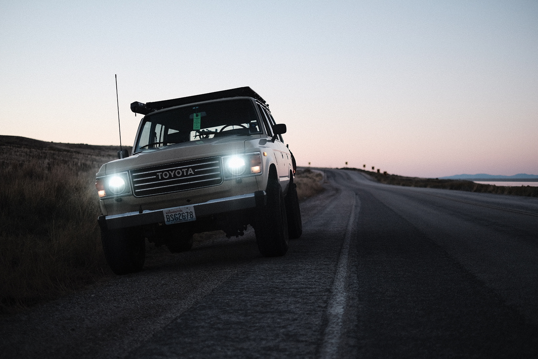

I got home last Sunday 10/17. The total mileage was 4,750 over 10 days of driving. The truck was amazing! The only thing that went wrong was that my front DS window stopped rolling up all the way. Thankfully I never got rained on. :) I want to post a much more thorough trip report but I may be recovering from the journey for another couple of weeks. Thanks for following along and for sending good vibes. Time for an oil change!
