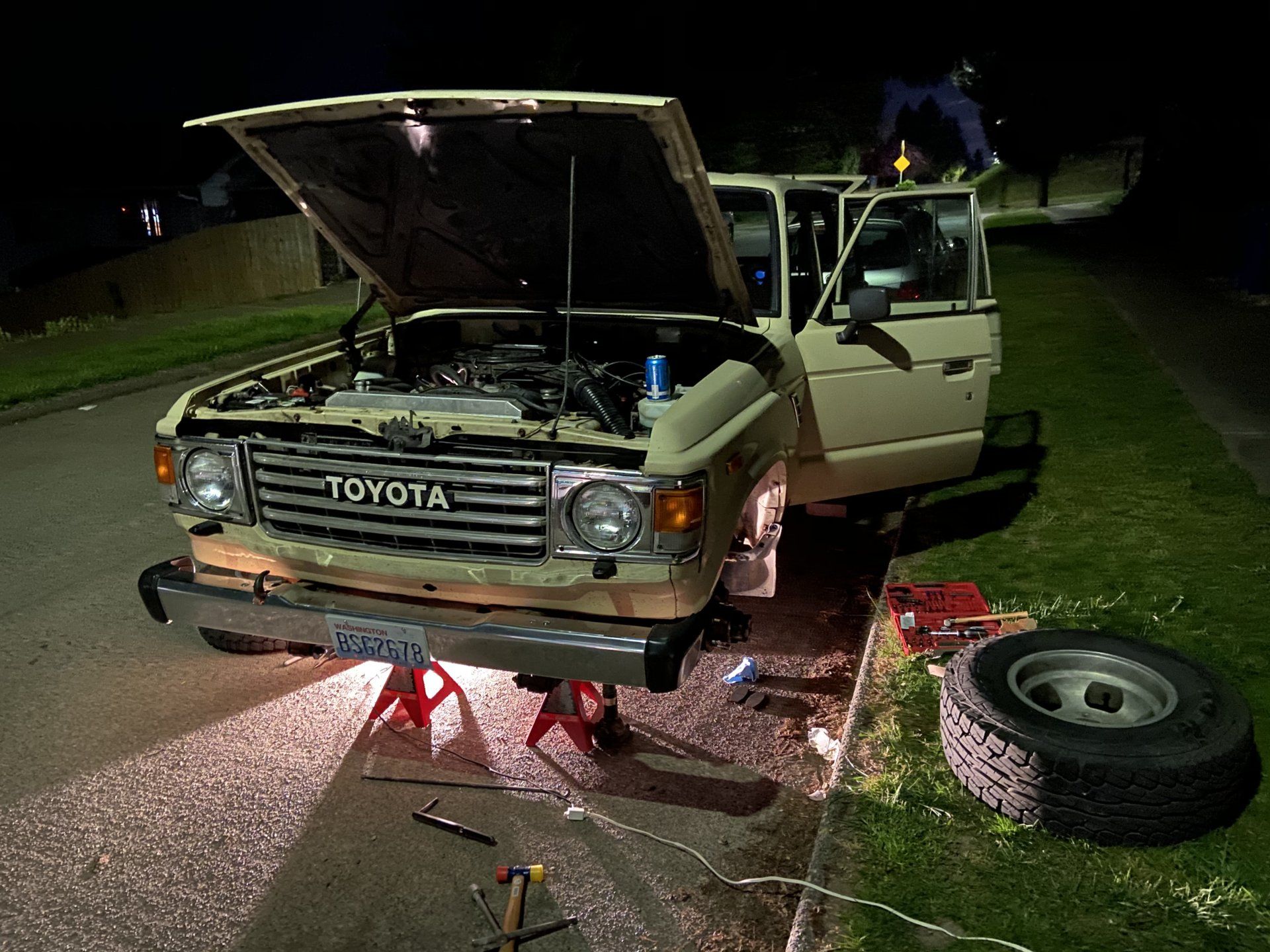

I have four things I want to tackle soon and I’m trying to avoid doing all of them at the same time... but they all involve getting the truck up on stands.
* Tie rod ends
* Brake pads
* Suspension
* Knuckle rebuild
I’m sure I need to do the knuckle rebuild but it also seems like the most likely candidate to put off a bit longer. Would anyone strongly recommend doing it along with everything else?

LOL, I did all of those when my 60 was up on stands
I thought I’d do brake pads and tie rod ends tonight but you all know how that’s going...

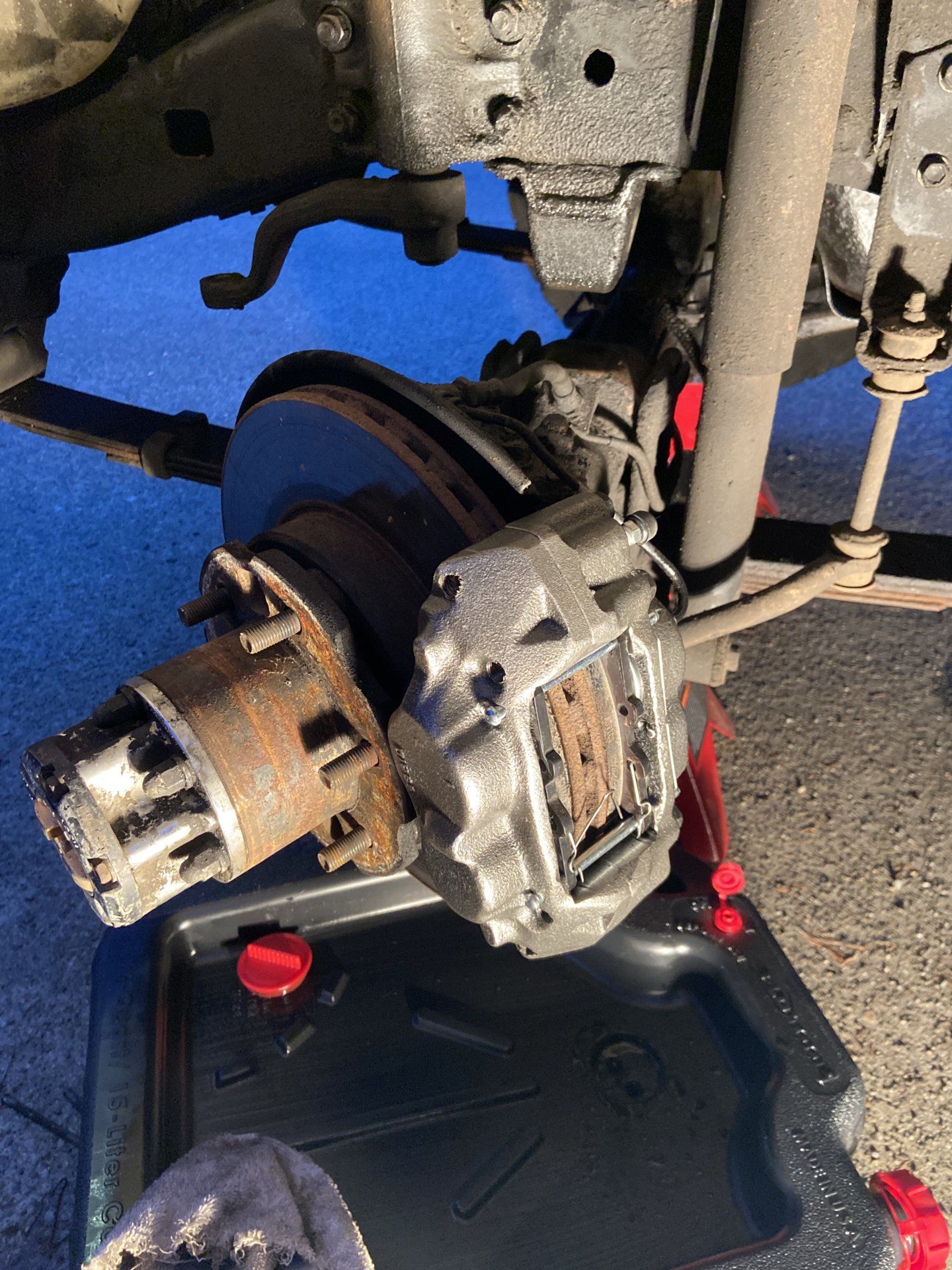

I got one side replaced just fine, once I got the pistons pressed in far enough. The other side (the opposite side of my brake pull) is not going well. I managed to get one pad out but the other is very stuck. Not sure if the pistons are bad or if the pad was just allowed to wear too far but I can’t find a way to create any separation. Any ideas?
EDIT: I managed to get the stuck pad removed but 1 of the 2 pistons on that side is super stuck. It may just be over-extended due to excessive pad wear... what’s the easiest way to get it to pop back in? I’d rather not buy two new calipers because 1/8 pistons is stuck. 😅
channel locks usually work.
Was going to mention to be careful if using channel locks they could damage the pistons and make them leak or stick.

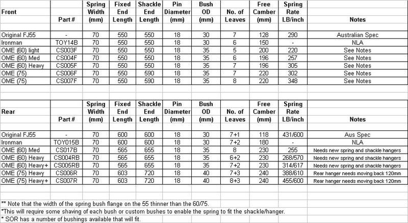

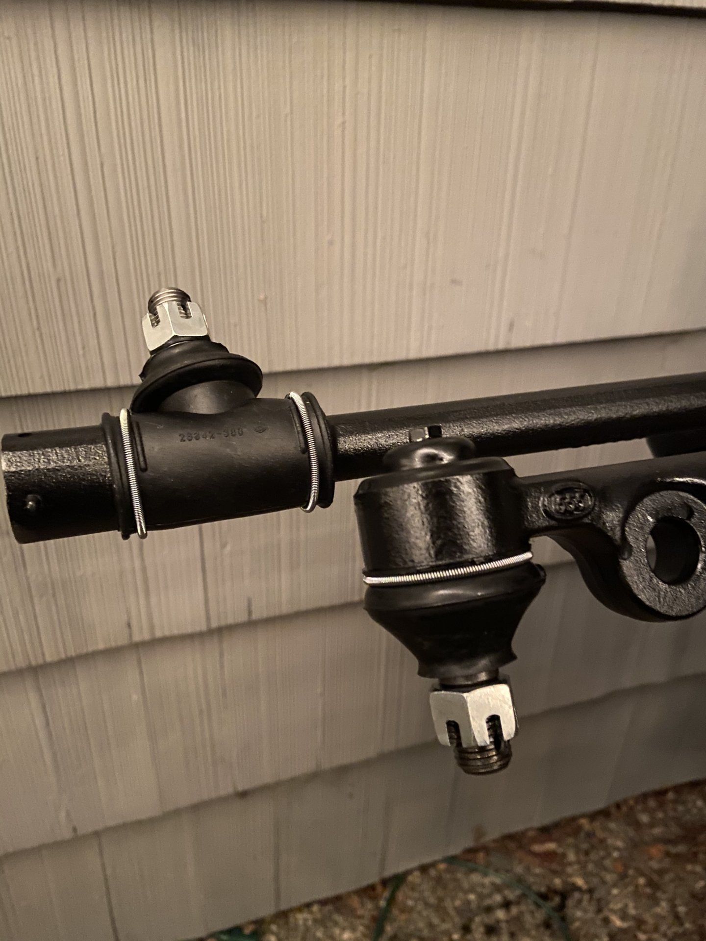

Today I met @NookShneer and traded some parts (hi Dave 👋), picked up my OME heavy kit from @torfab (004 front and back), painted my new TREs (just to prove I can full-ass SOMETHING), and installed new brake calipers and pads. I’m hoping to get the truck off jack stands tomorrow. The lift will have to go on soon because I have nowhere to store these springs. ¯\_(ツ)_/¯
Are OME CS004R A/B springs supposed to have 9 total springs? I see 7 in stage one and 2 overload. Maybe there’s an extra leaf on these?
Getting it done. Nice work on the TRE’s I missed the paint part and they look sad and rusty.
Thanks @NookShneer! That’s a lot of springs for a stock truck but I think I’ll stick with it. They do look pretty broken-in and @lechnito’s OME install thread makes me think it’ll look great.
Today I installed the TREs, bled the brakes, and drove the truck again. I also found the source of a bad rattle... my AC idler pulley. I loosened some tension on the AC belt and that fixed it for now.
