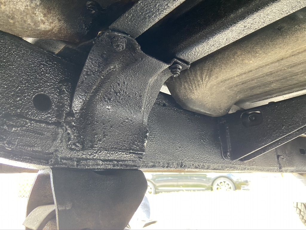

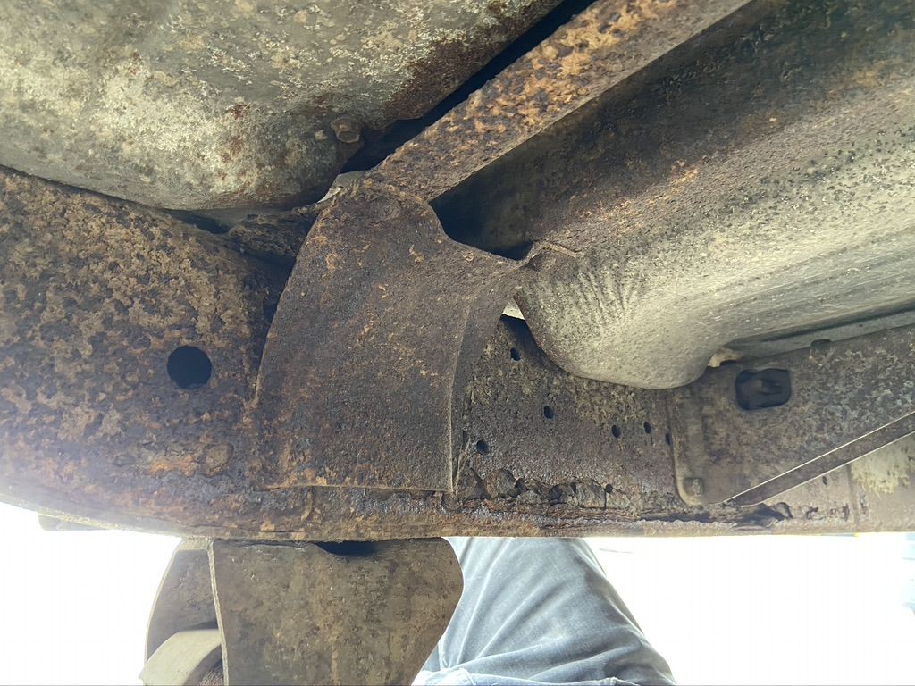

In other news, I found a small shop just a couple of blocks from me that advertises "frame repair" as one of their services. I took it in to have them work on the worst bit of my frame. Not bad for $275!

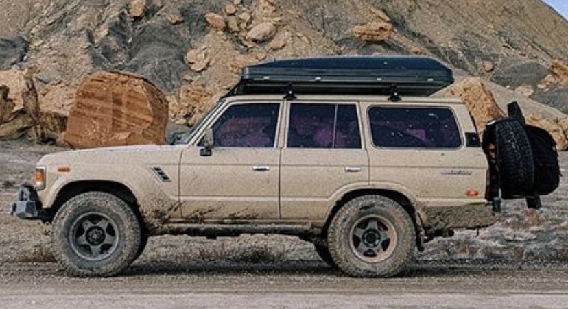

This past week @Jonathan Faunce and I got his rear springs swapped (no more lean) and got the rear portion of my OME install finished. The stinkbug is STRONG but the ride improvement is already incredible. I also bought some 33” BFG AT tires that I’ll get mounted and balanced this week!
