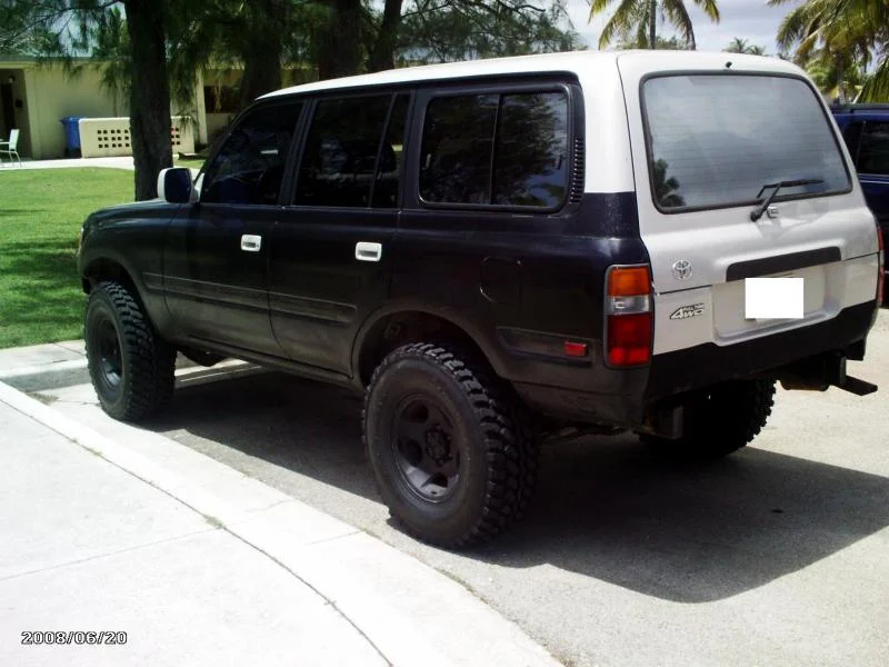

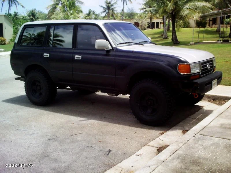

So here as some pics of the retread D/mud ultra grips in 305/70-16 from treadwright. They are nitto terra grappler carcass with a dunlop mud rover style tread pattern with crushed walnut shell for wet/ice/snow. The only complaint I have was that one of them went flat the first night they were on and had to be repaired in two places. That really got to me considering I flew them on a plane from Arkansas to Guam coming back from leave. I paid $477 shipped to my parents house in Arkansas for 4 tires so I shouldn't be complaining. The nitto carcass is E rated over 3500 pounds. I have a hybrid ironman 2'' front/OME 862 rear. The paint is an ongoing process as is the rear bumper so don't judge me just yet. I went with hippo liner at first on flares an rockers, then went over that with rustoleum gloss black industrial enamel up to the bottom the windows for some UV protection because the hippo liner is very tough but was getting jacked by the South Pacific sun. Anyways...long post and actually my first. Overall the tires are much quietier than I thought and that is without carpet. I really like how 305's look with this lift. This forum is amazing and I must say thank you! I'll keep updating on the how these tires perform. Out

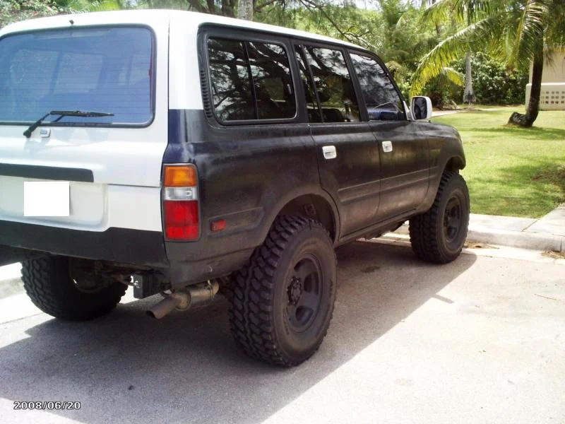

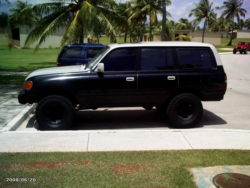

Two more pics...
Here are some better shots I just needed to erase my plate.

Looks good, I like it. I have virtually the same lift except my springs are OME 851 up front but give the same 2" lift. There is only one other guy that Im aware of that runs the 862's in the back with a 2" lift up front. Strange considering the stinkbug thing is such an issue.
Question about your rear bumper (or lack of it). Did you do any additional crossbracing that we cant see in the photo? The part you cut off is structural and I dunno that I'd wheel it like that since the chassis will flex more that way. Looks cool though. Another thing to consider is if you back into a tree, pole, or anything, your tailgate will take the impact (possibly crack the window).

Yeah the crossmember is important and I haven't wheeled it real hard though I did dig that right frame end into the ground and bent my resonator up a little but I will be getting the bumper going soon. One thing that is still irritating is that one tire still went flat after I had it repaired in two places and the guy really invested a lot of time in making sure it was good to go. Maybe it is the valve stem because when I went to check the pressure when I put the mounted tire back on, the valve core stuck open and I had to mess with it to keep it closed. I hope that is it because if it is still the tire I am going to really hammer treadwright. I measured these tires unmounted and they were just a hair over 33'' tall. Pretty big for a 305.

Hey, an elusive 2-tone!!
