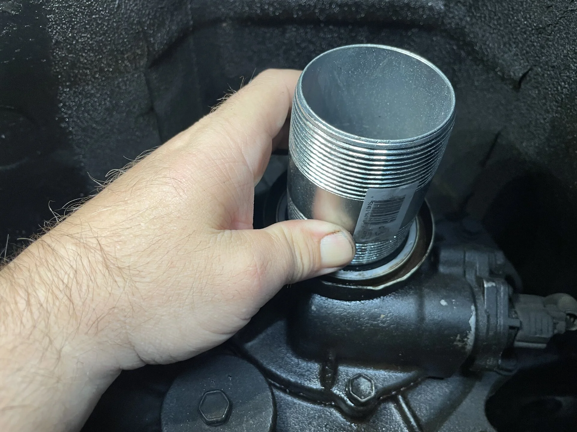

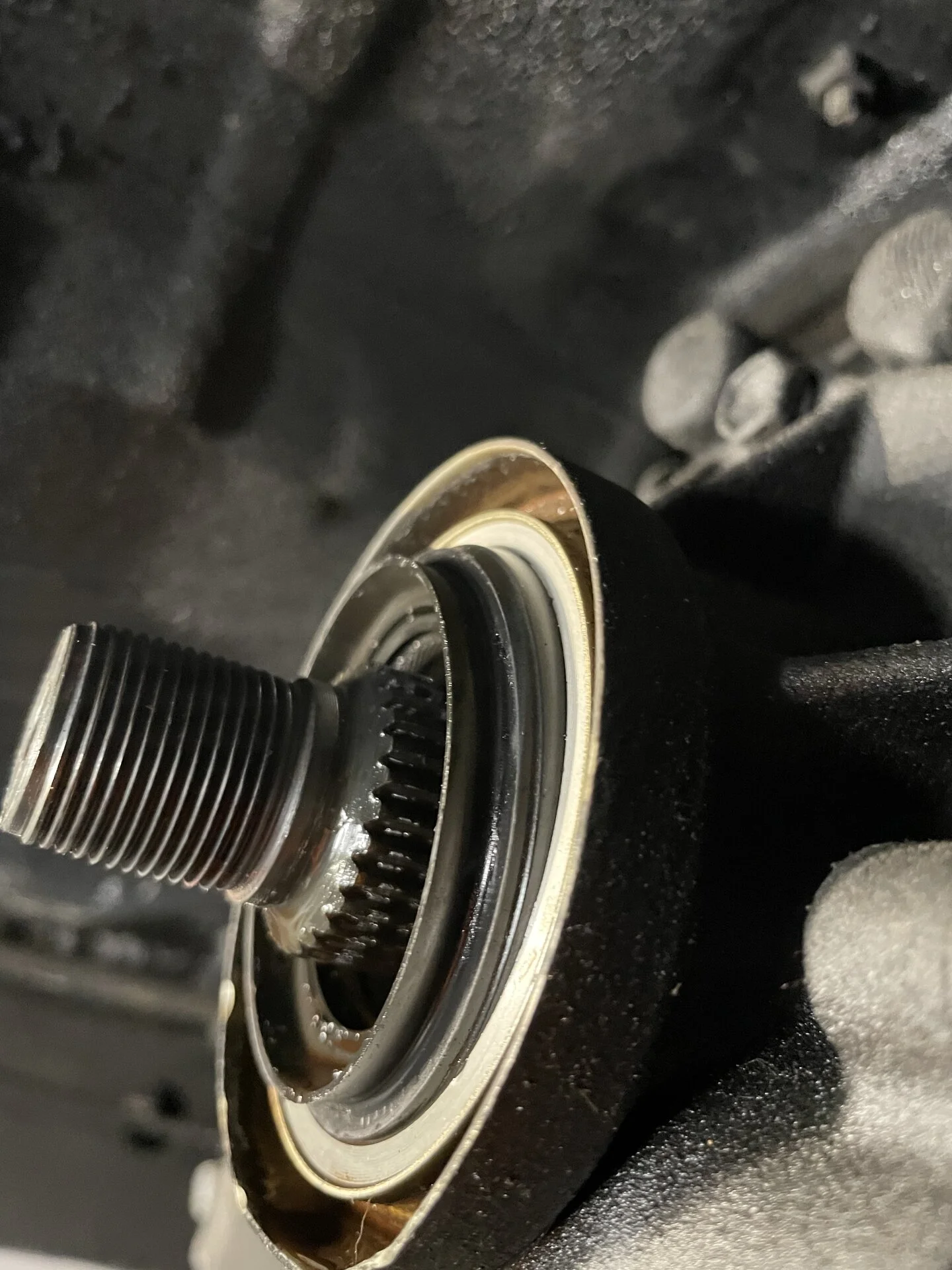

Replaced the rear output seal on my KZJ90 today and it looks like the person in there before me was late for a lunch break or maybe needed more light.
Also wanted to report that I watched a video where someone said you can use a 2” metal pipe coupler from the HomeDepot to drive the seal on and it worked perfect.
