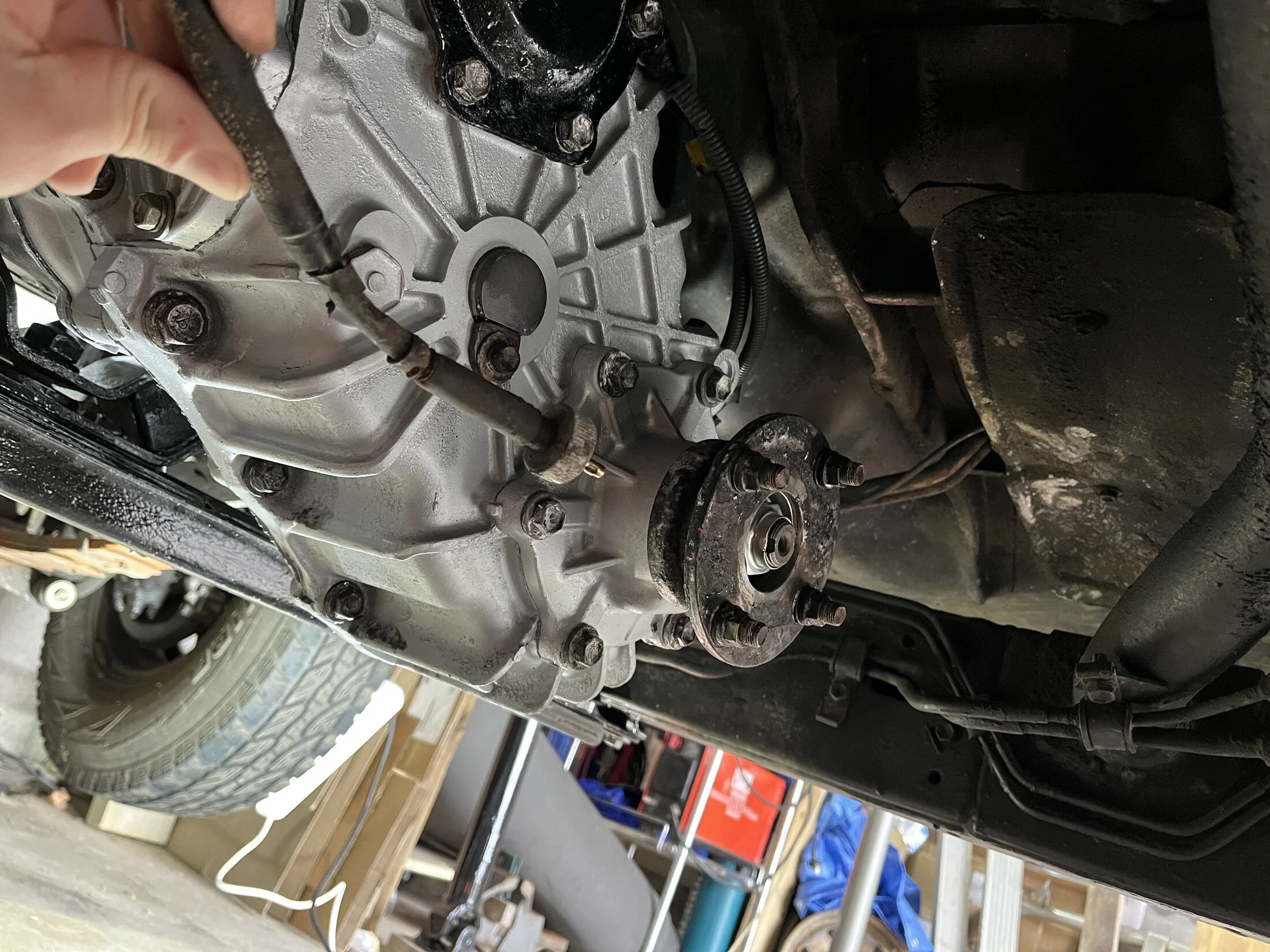

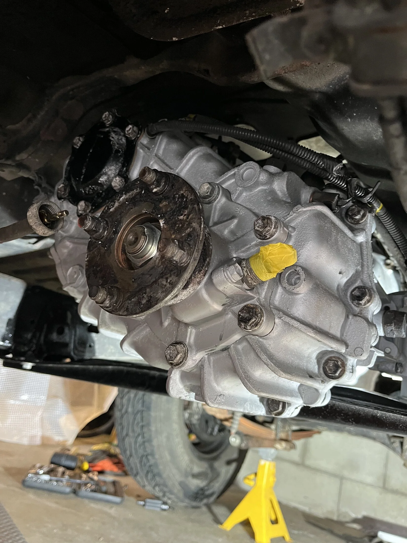

Hi all, I'm installing a refreshed transmission & transfer into my PZJ77 and have hit a snag.
In the rebuild the output shaft bearing retainer was installed ~180 degrees out, so now the speedo cable won't connect.
Am I able to unbolt the retainer, rotate & re-bolt while it is still on the car? Or will this require some specialist knowledge/tools?
I've just got it all back in, so having to do through all of the fuss of removing it again and getting it sorted by the shop is not a pleasant thought.
Thanks in advance.
No problem to turn it around whilst installed, but I do wonder about the quality of a rebuild where the retainer was put on in completely the wrong orientation. Do you know if the rebuilder set the pre-load on the output shaft bearings?
Thanks for the response.
The rebuild was done by a reasonably big/well reviewed shop here, so I assume it's all to spec otherwise.
The trans was sent to them seperate from the car, so I guess they didn't have the cable location on the car as a ref. Could have paid a bit more attention when dismantling it though.
You might be able to gently rotate it without tearing gasket. If FIPG used it won't.

Thanks Rick.
I did end up contacting the shop too for their advice. Though I’d better because I don’t want to void the warranty for their work.

I did get a hold of them, and will take it in once she’s back on the road so they can rotate it themselves and make sure it’s all sealed up properly once done.
