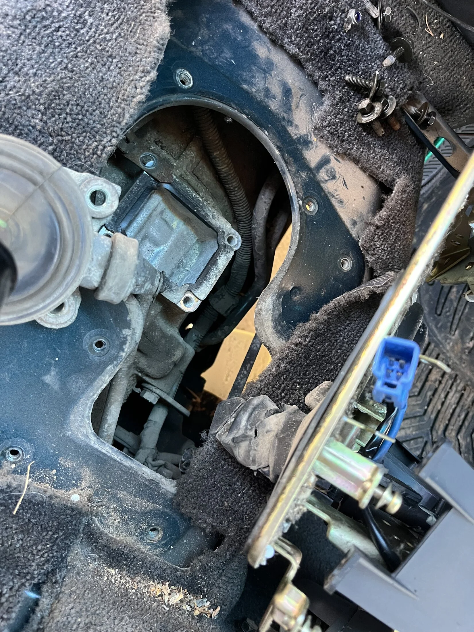

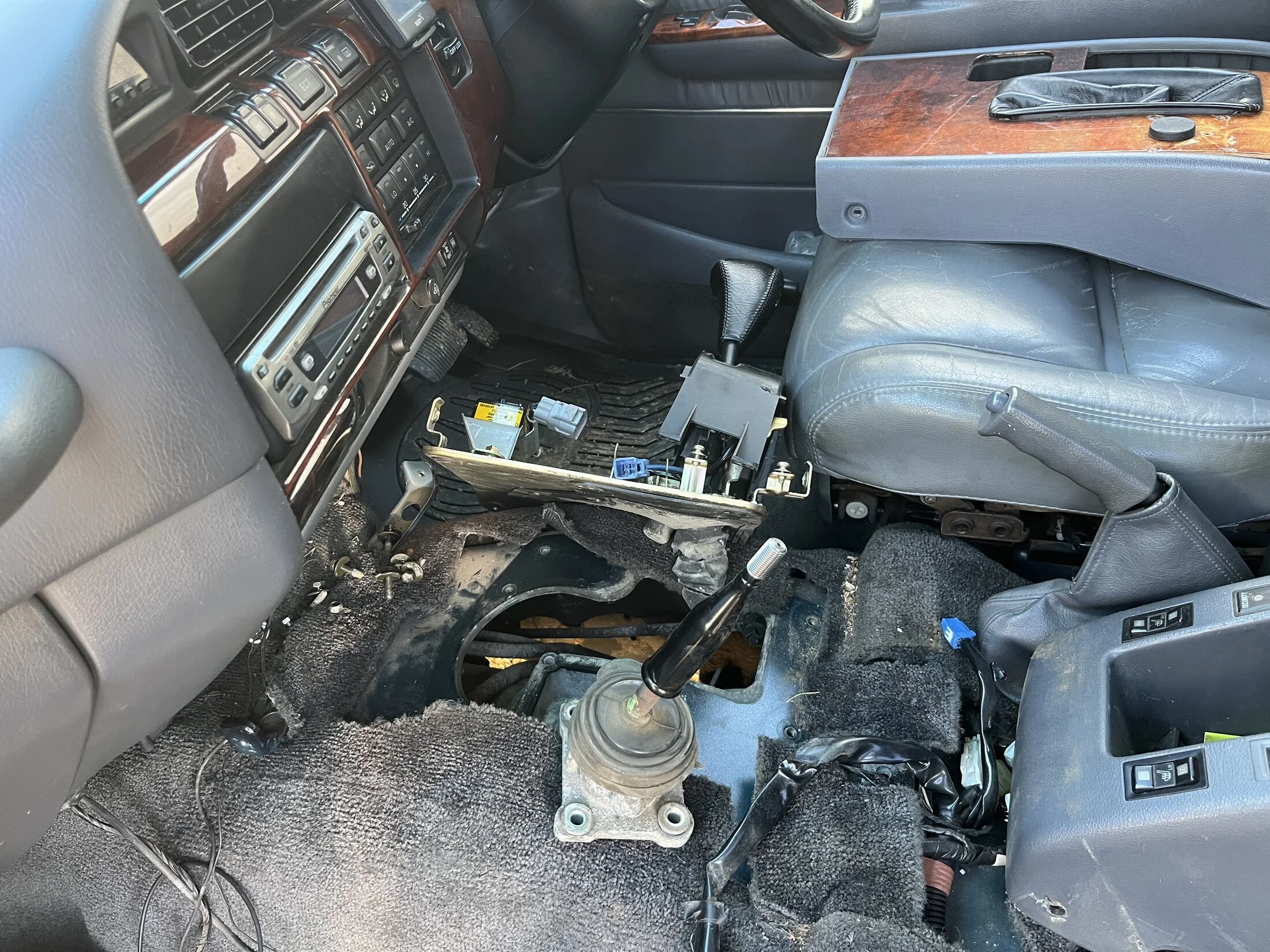

Yes, it's bolted to the top of the auto box. Then linkages accessible from underneath (take a pic before you pull the pin because it will scatter the washers and bushings all over)
The 4 bolts that hold it to the top of the auto box are accessible from the top inside the cab.
You can reach up from the bottom of the truck and reach to the top of the transmission to see if they are loose pretty tight fit but achievable.

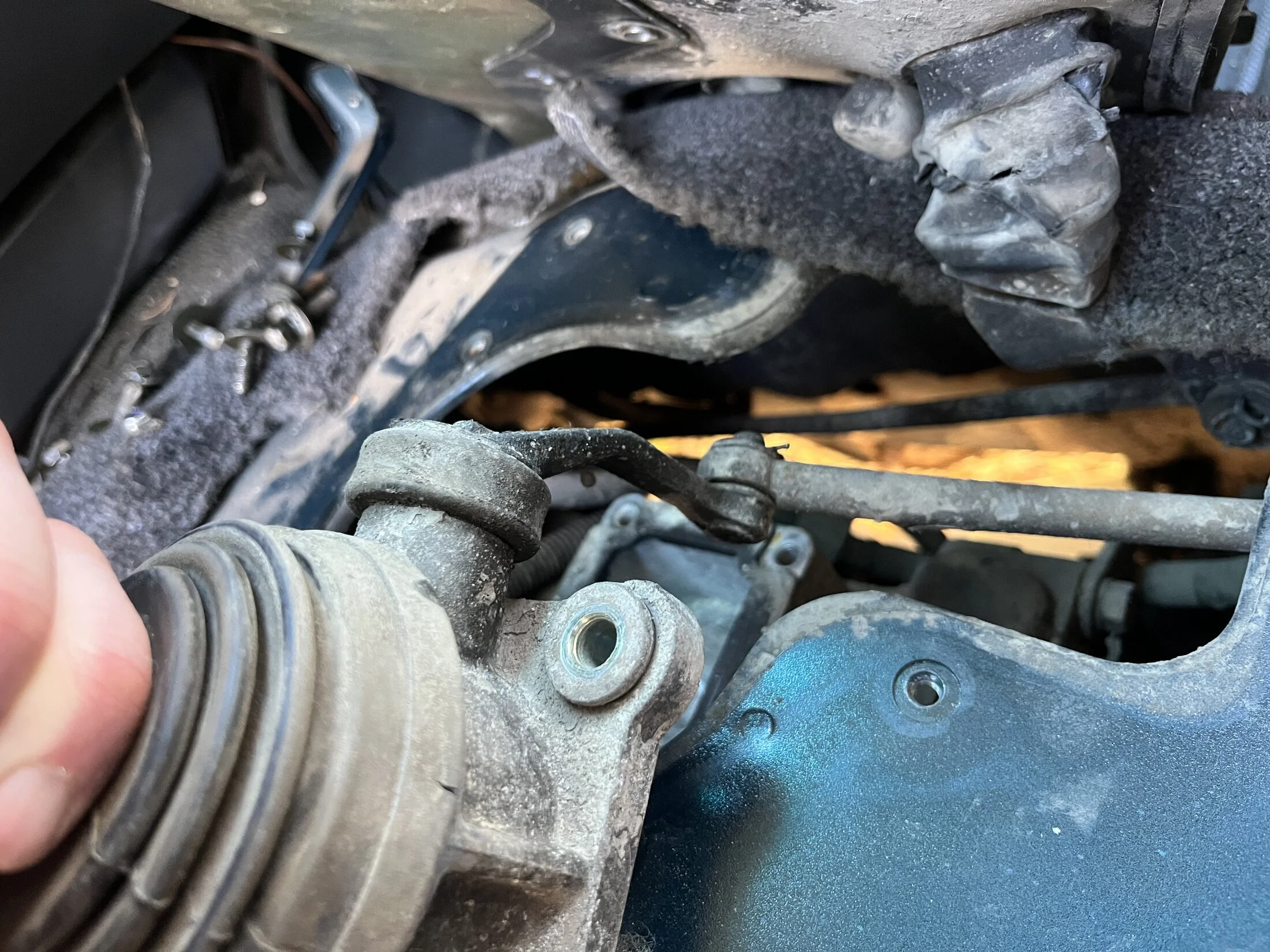

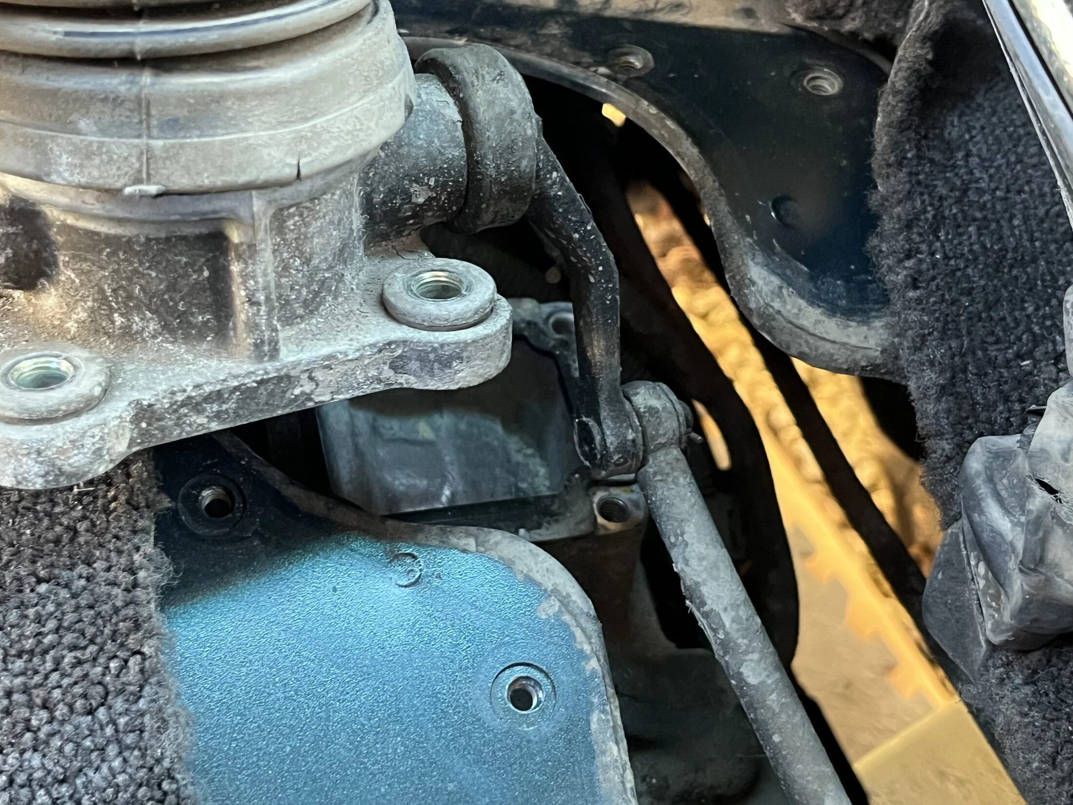

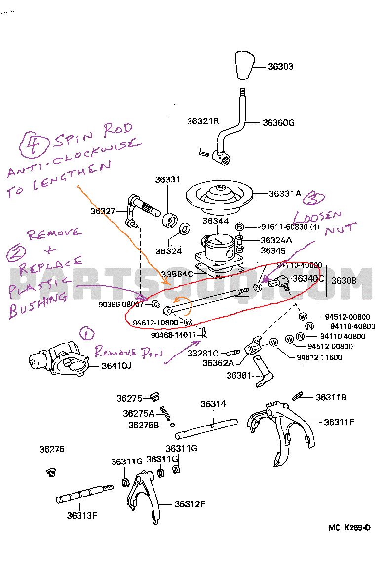

Let me see if I can walk you through this:
The shifter rod has a simple plastic bushing on one end and a ball joint (tie rod end) on the other. The rod itself is threaded into the ball joint. The rod length is adjusted by increasing or decreasing the number of threads screwed into that ball joint. Once adjusted, a nut is tightened to secure it from moving.
To adjust, first remove a small pin that holds the plastic bushing end of the rod. Slide the end of the rod off the shifter lever. That plastic bushing on the end is probably worn (or missing) so plan on replacing it. Next, loosen the small lock nut next to the ball joint on the other end of the rod. Now you can spin the rod anti-clockwise to lengthen the rod. You won't need much. Just enough to get the shift forks to fully engage. You may need to try this a couple times to get it right.

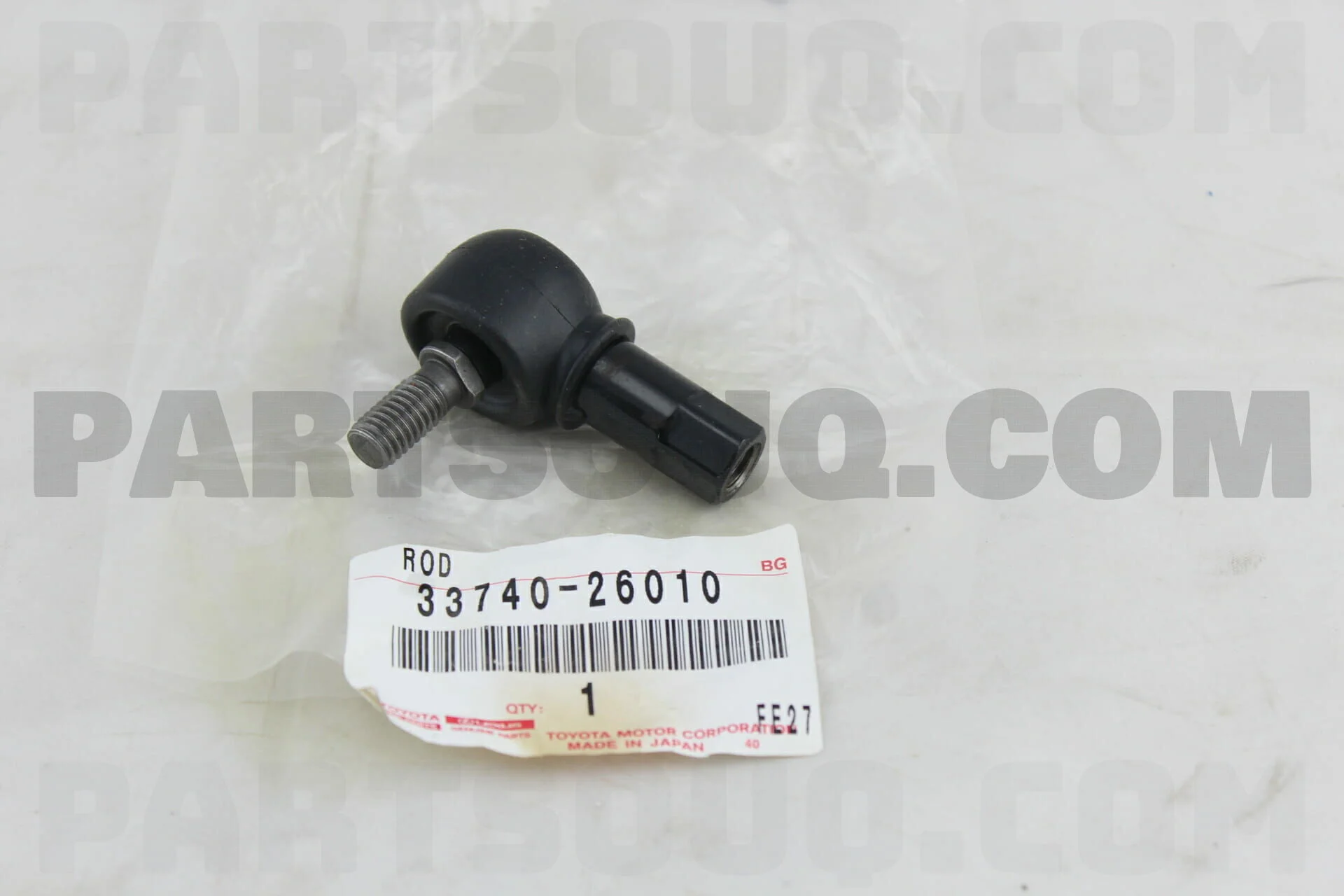

You can choose to replace that ball joint if you really want to be thorough. That would require that you remove the rod completely to replace.
This is all doable by reaching up above the transfer case. It is a tight fit, and a bit awkward if you have big hands, but you don't need to drop the transfer case to accomplish this. I once had to do it in the dirt, driving up out of the Rubicon trail when I had symptoms just as you've described.
I would also follow the advice given by @BILT4ME to replace the bushings for the shift plate and lever. Just a little bit of wear in any part of the shift system can be enough to prevent the shift forks from engaging fully. Only after fully overhauling the shifter linkages would I consider removing and rebuilding the transfer case itself.

Before you remove and tear into the TC, I would at least try to lengthen the shift rod. After 30 years of service, you should expect wear of the shift bushings, shifter rod end, and perhaps shift forks within the TC. Toyota made that rod adjustable so that you can adjust for this wear. It would be very difficult to notice any wear just by visual inspection or by wiggling things by hand. Just a couple millimeters can make all the difference.

It’s just too difficult to get to the adjustable end of the tc shift rod assy from underneath and getting a 12mm spanner on the locknut is virtually impossible as access is extremely limited due to the centre diff lock mech and trans tunnel however there is a much easier route… just remove the passenger seat, console covers and shift lever plates and you can get easy access from above. I used a crows claw spanner to loosen the locknut (as its under the trans tunnel on the far end of the rod) and adjusted the linkage as Shipwreck kindly described. The bushing on the lever was in perfect condition. The H/L shift lever yoke looks great and was securely bolted to the top of the trans (it does not have a gate or detent it’s simply a fire/aft lever) so the only restriction is can suffer is either trapped rubber gaiters or it hitting its own yoke mount but all was good. All in amazing condition for 30 yrs old!

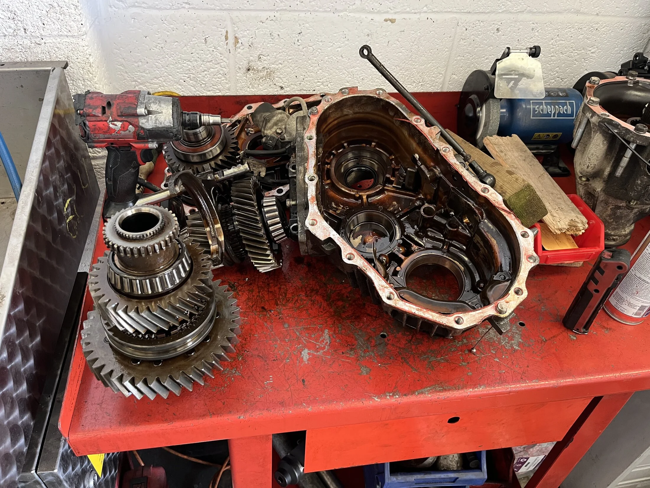

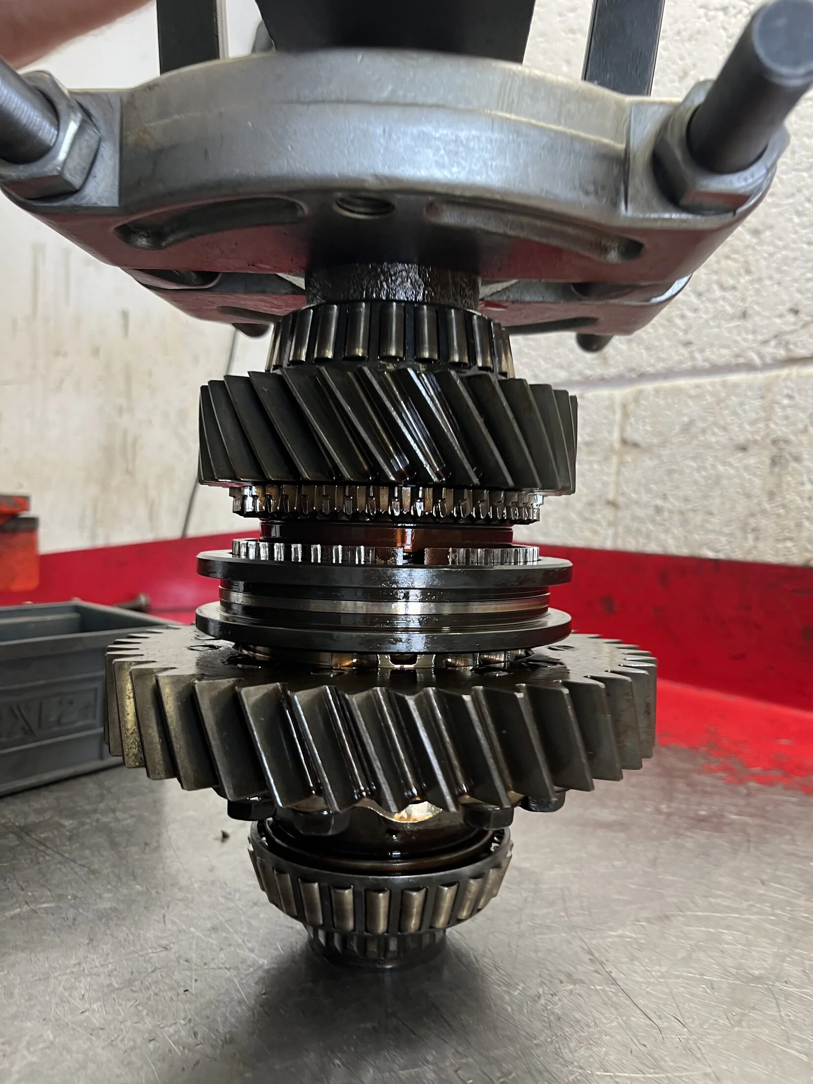

Update: we’ve now got around to getting the TC case out. A bit fiddly but managed to locate all the 6 bolts that hold it to the gearbox and overall pretty easy to do. Cracked open the TC case and with the help of a transmission tech and his tools we removed the innards and discovered bad wear on the dog teeth that locks the gear set to high ratio. The actual driven gears are all perfect it’s the hub and associated gear that locks in the H or L selection. But the horror really is the cost of the parts which amazingly are all available from Mr T. The selector hub is only £116 plus vat but it’s the actual high speed gear unit that’s frightening, it’s £1028! Any suggestions?
