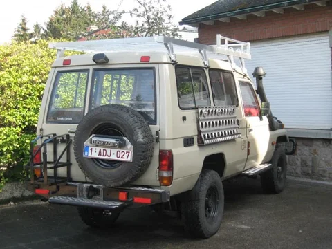

You might be having difficulty finding some items however you should be able to locate your air filter box ( even in the dark :D)
Nice looking Cruiser by the way.
yeah,it's given it a personal touch ,2 years of hard work almost done, than off to africa; this is my car before. 5 africa overland trips, now complete revision off everithing, reconditioned engine , the works.....Again 0 miles on the engine,fresh new cilinders,crankshaft, and many euros,but you know it's a guys thing and i always rebuild him
