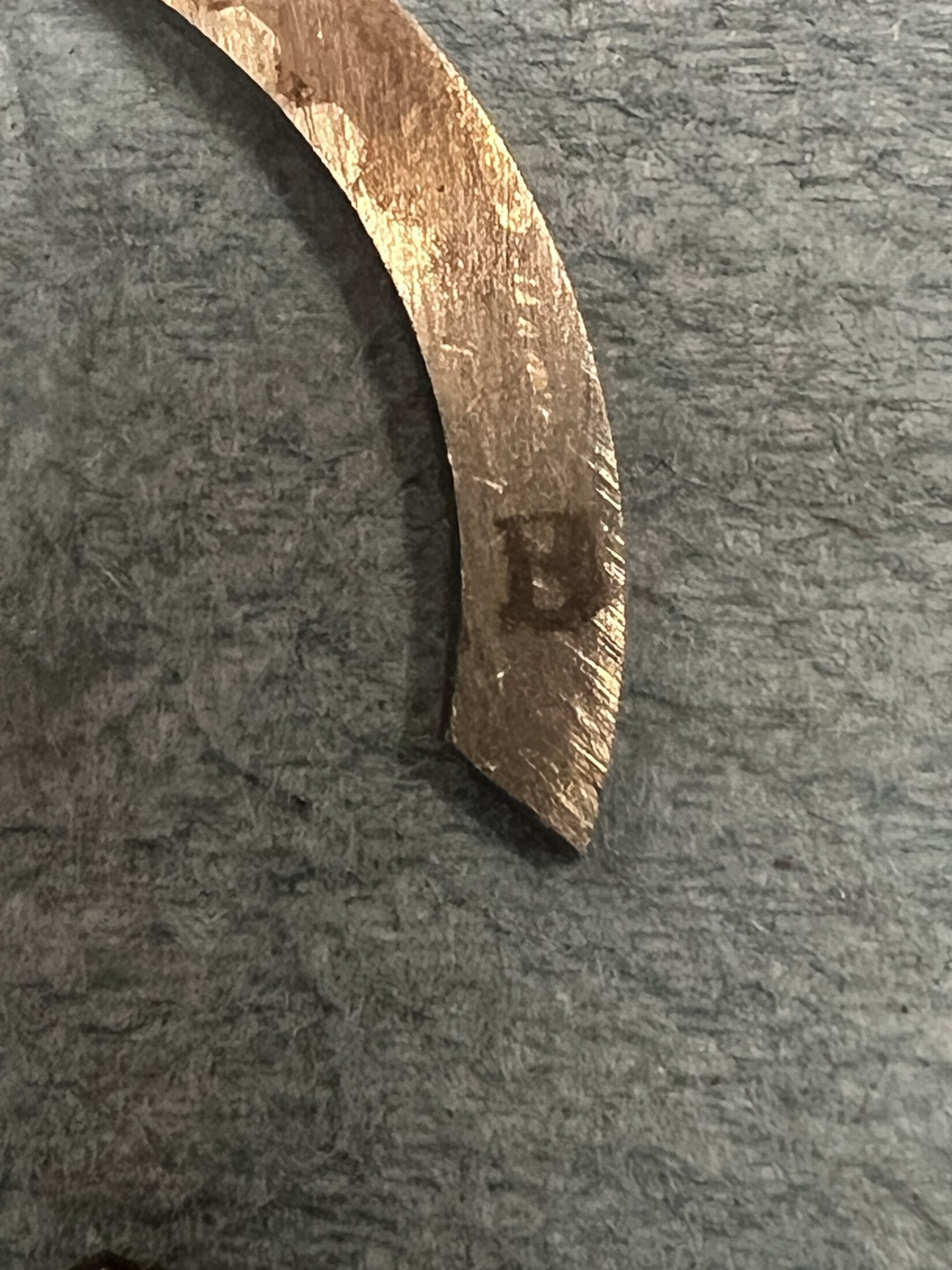

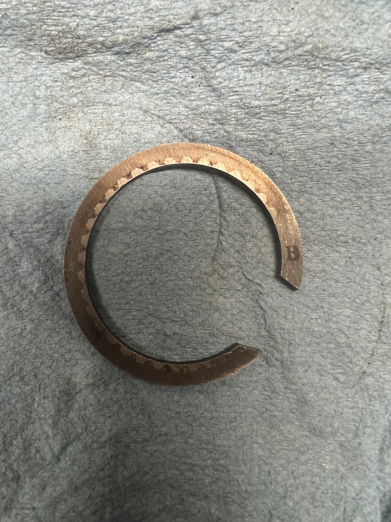

I tweaked a c-clip in dissassembling a transfer case that I am regearing.
I am positive that I've seen a listing of the part numbers for the various thickness clips on this forum, but I can't find that post.
This one retains a gear on a shaft in the front output housing.
I tried google: site:IH8MUD Forum - https://forum.ih8mud.com/ "80-Series Tech" "transfer case" clip
Does anyone have a saved link to that post they can share?
I need the 'B' thickness c-clip.

Thank you. I may be reading it wrong, but that doesn't look like the right c-clip. Is there a site you used to find that info that you could share?
I think it is the "snap ring" on the far right on this diagram from the FSM.

I think it is this one. Snap Ring options. I need 9052036020 (MARK B).
That area is the front output shaft, and the gear on my pictures is the hub transfer drive clutch (part 36239 in diagram above).
This pic just to show we are looking at the front output. They don't show the front output shaft in this diagram so it is harder to orient.
