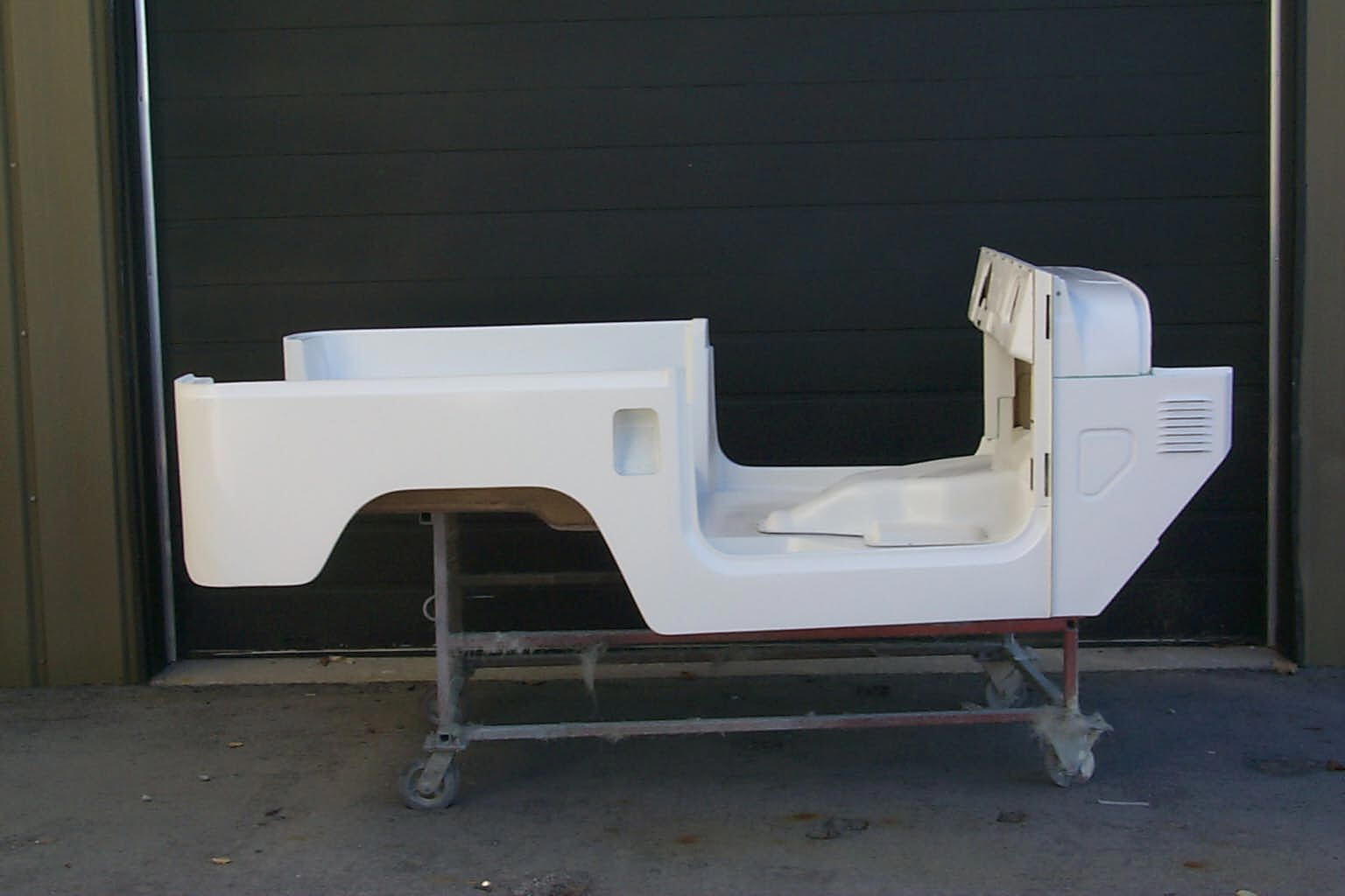

A fiberglass hump would be super cool. Its an option that has been at the back of my mind for a while... just was not sure the right execution. I definitely don't have the skills to mod my hump as skillfully as @Skreddy ( :cool:). Based on the interest thread: 4 on the tree adapter interest - https://forum.ih8mud.com/threads/4-on-the-tree-adapter-interest.1290951/ , most people were interested in just the adapter. If there is enough of a group interest (and I am definitely in this camp) then I think pursuing a group buy for a small batch custom hump would be in order to make it happen. I would imagine that would bring the cost of them down to tangible levels. That being said, I have no idea on how much a custom transmission hump would cost to produce. I would guess some good $$, Anyone have an idea? :)
If you zoom in here on the main photo, there is what I assume to be a loose fiberglass tunnel inside of the fiberglass tub - the description says it comes with the tunnel. I suspect modifications would be necessary to make the floor and firewall flanges compatible with the earlier tubs that came with the 3 speeds. Would be worth a chat with Gozzard to talk about rough ballpark costs. I talked to them about their fiberglass replacement caps, and they were great with communication, very responsive.
