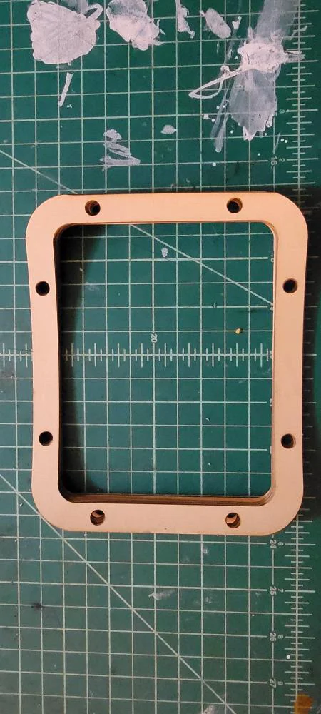

I am happy to report that the adapter is perfect and the rest will be on their way to me soon. :D I am having a gasket made that goes between the 3-speed shifter plate and the adapter. Currently the only want to get this gasket is to buy the whole OEM 3 speed transmission seal kit. Not ideal.
Plan is to offer the adapter, the gasket and the needed allen head bolts as one kit to make it as easy as possible for people. :cheers:

Ok so just trying to keep track of who is interested. 15 adapters are available. Please reach out if you want on or off the "list". Pricing is going to be $400. That will include the adapter, custom gasket for the column shifter plate and mounting bolts. Once I have all the pieces for this kit and they are ready to ship, I'll post a thread in the classifieds. Adapters are currently on the way to me. If there is interest beyond this initial batch, still reach out so I can get an idea on how big a potential second run would be (clearly the more the better for efficiency and cost sake).

Adapters have arrived! Once I get the top plate gasket for each adapter I'll get all these boxed up and contact everyone.
