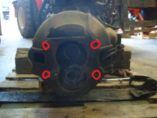

hey guys all i need left to yank out my motor is disconnecting the tranny with the motor but if i look from under the car i cant see any bolts whatsoever from the top i see like one any ideas? or a pic of where each bolt is??? need to get this motor out today =/

There are four bolts that hold the transmission to the bellhousing. You have to remove those four bolts before you can even begin to remove the bellhousing. If you want to remove the bellhousing from the engine, pull the engine out with the bellhousing still attached (transmission detached of-course) and begin removing the pressure plate, flywheel and the other clutch stuff. There are bolts located behind all the clutch components that will seperate the bellhousing andthe engine. Any more questions just ask. I can post a pic if I need to
Yeah once you remove the four bolts the connect the tranny and bellhousing (granted if everything else like any plugs or other such things are removed) you can pull the engine. The picture show the four bolt holes the connect the tranny and bellhousing (this was the best picture I had - the circles show the bolt holes on the bellhousing)
https://forum.ih8mud.com/attachment.php?attachmentid=53850&stc=1&d=1138119011
