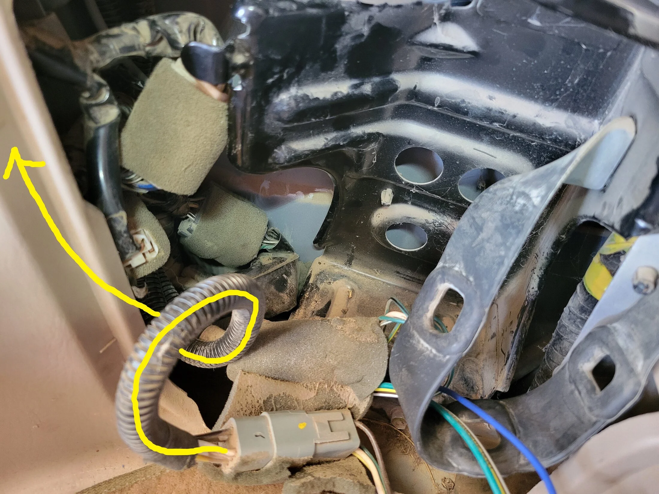

The 4-way trailer connector wiring on my wife's '99 was all mashed up and frayed and so I need to replace it for our boat.
I followed it to the jack compartment in the back, on the drivers side, and I spliced in new wiring and trailer connector.
Unfortunately, the brown wire for lights, does not work, has no power. I tried to follow the wiring further into the compartment but it disappears behind the exterior metal body and I have no idea where it goes.
In my search results, I read of a mix-match of setups in the '98-'00 models. Majority seem to have a converter box located either on the passenger or driver side.
Hoping someone can help me locate the converter / controller box? Where would it be on either the passenger or driver's side?
The later wiring supports a trailer brake controller - the early '98/99 at least only support a 4 flat lighting connector, or so I have read.
