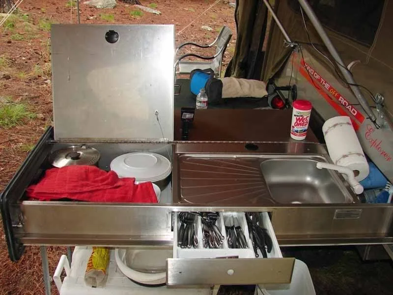

Oddly I don't have any good close-ups of my kitchen slide out. However I stole this photo of TucsonT4R's, which is identical to mine, from Exped Portal. Note the hinged long and narrow cubbie just behind the sink.
The slide out also has LED lighting underneath the slide out. At first I thought it wouldn't be useful but I do use it all the time for ambient/indirect light as needed. He doesn't have the slide-out fully extended...there is additional useable space to the immediate right of the sink for pump, filter, extra storage.
FYI: Here's Brad's complete thread over on EP: http://expeditionportal.com/forum/showthread.php?t=20712&page=7
There is another pic of the fold out shelf side of this slide out (Feb 2010, post #63). Note the nice integrated towel 'rack' on the end of the fold out shelf...super handy for a cook.

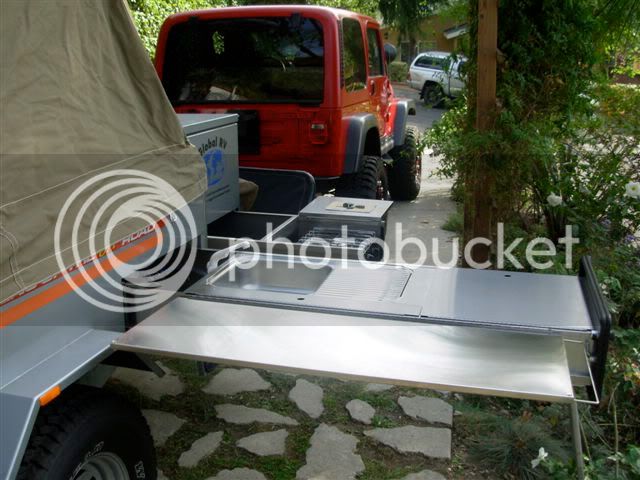

Since my KK is a little older than Dan's it's set up a tad different. Here is the kitchen/stove extended. Both the counter tops hinge out from the work areas. You could easily incorporate the sink/stove in the same slide and only sacrifice the pots/pan storage in the drawer. You can also see the silverware drawer on the drawer side and the cleanser door on top of the slide above the sink. You can also see the top red end of my water pump next to the faucet that pivots down out of the way. Also in view (Barely) is an exterior faucet that's covered in the canvas hood. It's a hand pump, so you can get water without extending the drawer slide.
The p.o. was a jeep guy. These are pics from the sale ad.
