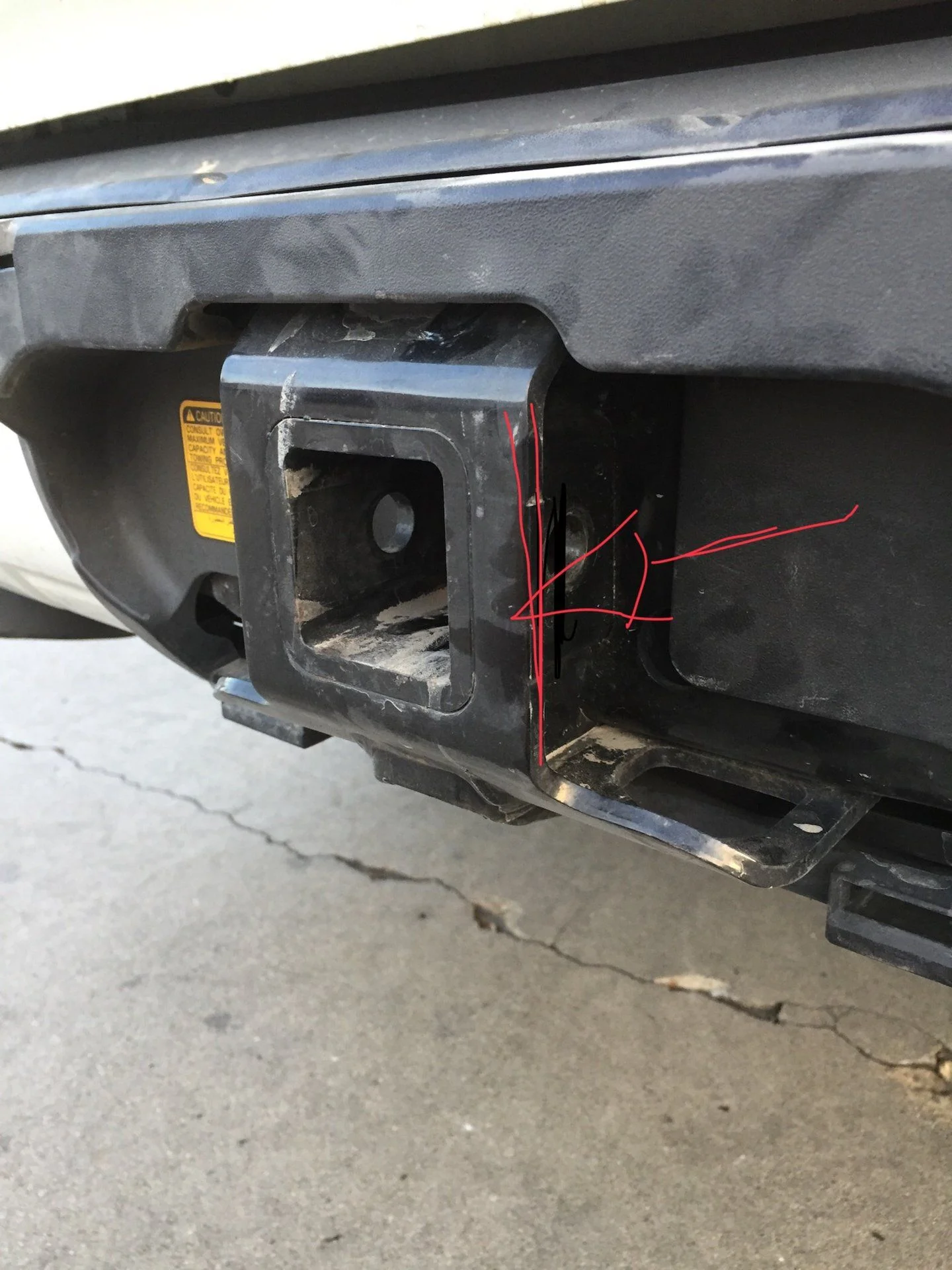

On just about every receiver I ever owned there was an extra layer of steel welded to the rear opening for reinforcement, which allows use of a u-bolt style quieter. The 200 factory receiver is WAY different. It has a flush face in back, and an actual skid plate/ slider underneath, plus what I think is a rectangular hole for a jack. On top the reinforcing plate slopes back to join the rear cross member. There is no direct way to attach any kind of aftermarket “slop remover” to this... it is a pretty darn cool design however. But a frustrating one!
My receiver has oversized pin holes plus all kinds of clearance between the square hole and the ball mount. Plus the left pin hole seems extra worn....

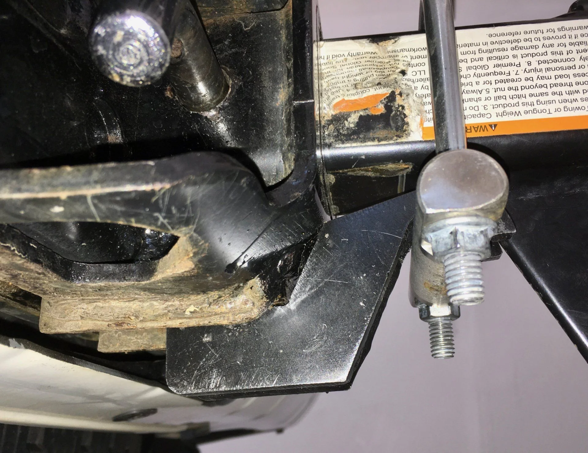

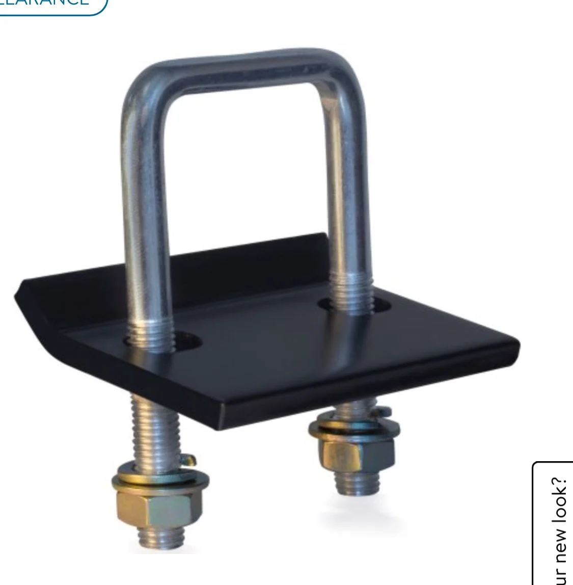

Ignore the blue plastic, I broke the retainer removing the stupid plastic shield. This is what I would like to use:

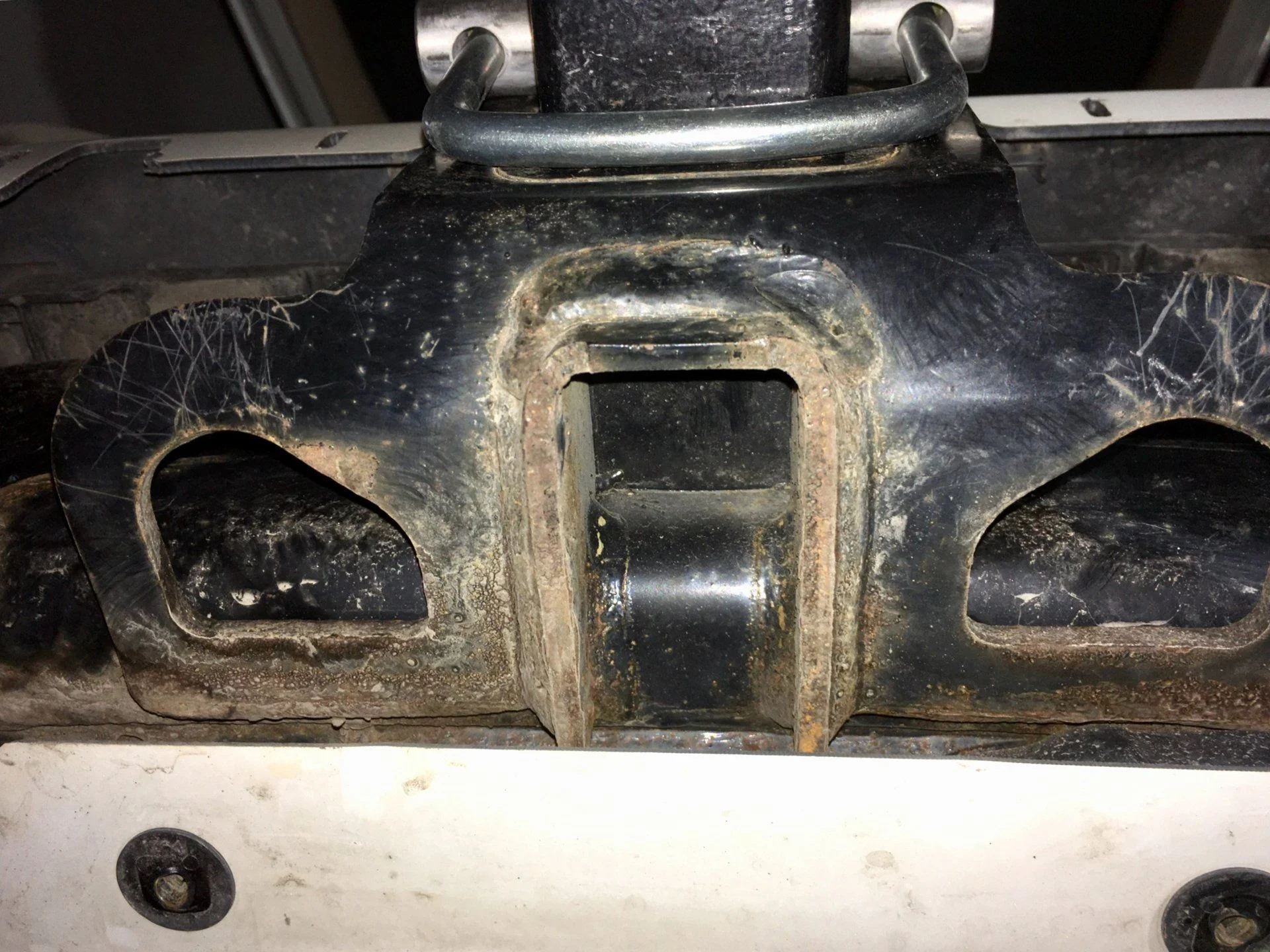

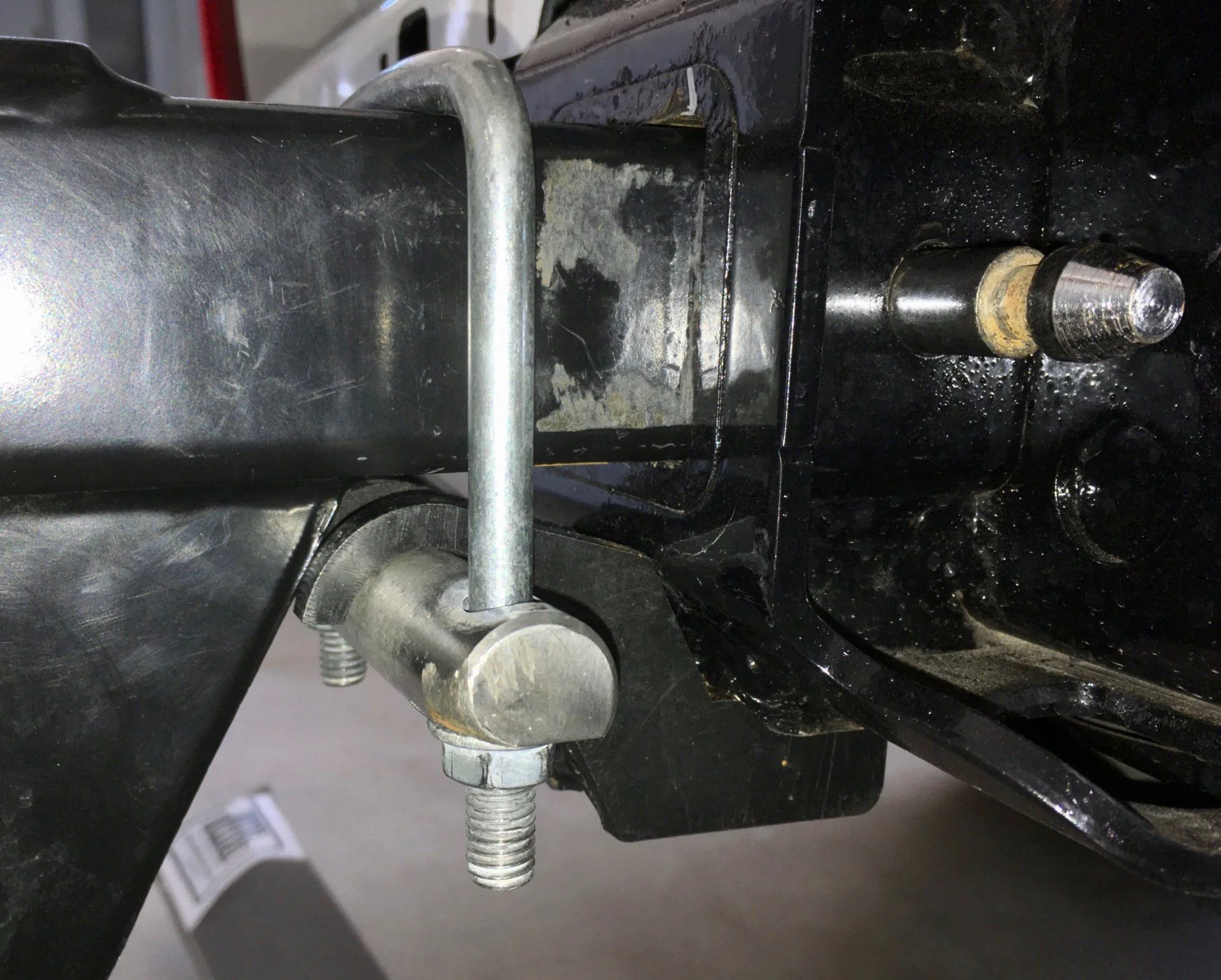

But there is nothing for the u-bolt to grab on to. Bottom of receiver, showing the jack hole (?):
I need to be able to anchor the ball mount DOWN when not towing using the weight distributing hitch (when I am using it as a dead weight hitch, or with no trailer at all). Normally when towing with my Anderson Hitch all the load is directed straight up and there is zero movement. When not towing, there is an inch of motion at the ball, which I want gone.
The best thing I could think of is to fabricate a really heavy duty S-hook from, say, 1/2 x 1 inch bar stock, one end would insert into the jack opening, the other end would lie under the u-bolt. But not actually touching the ball mount.

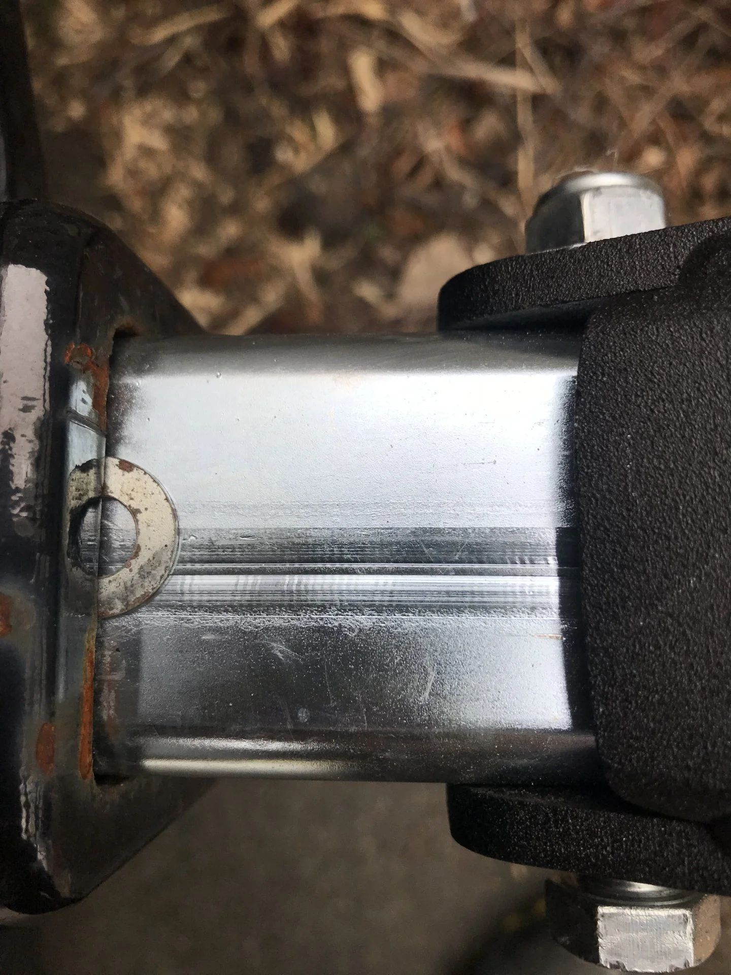

Instead of welding the receiver, you can instead opt to put a bead on the shank/stinger. Perhaps even a larger bead, then metal file her down to a nice snug fit. That's prob what I would do as it avoids the extra tightener gadget. And the shank/stinger is easy enough to bring to just about any welding shop.

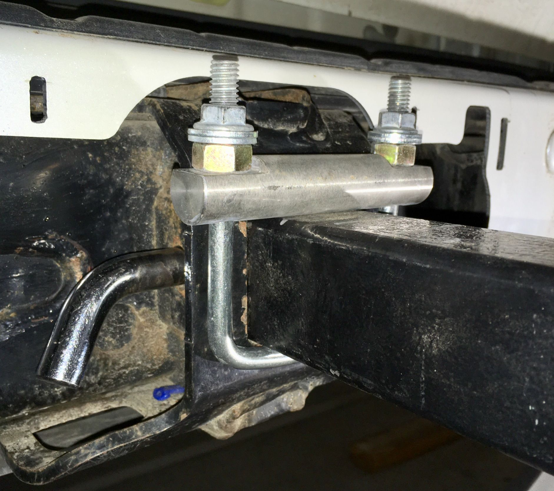

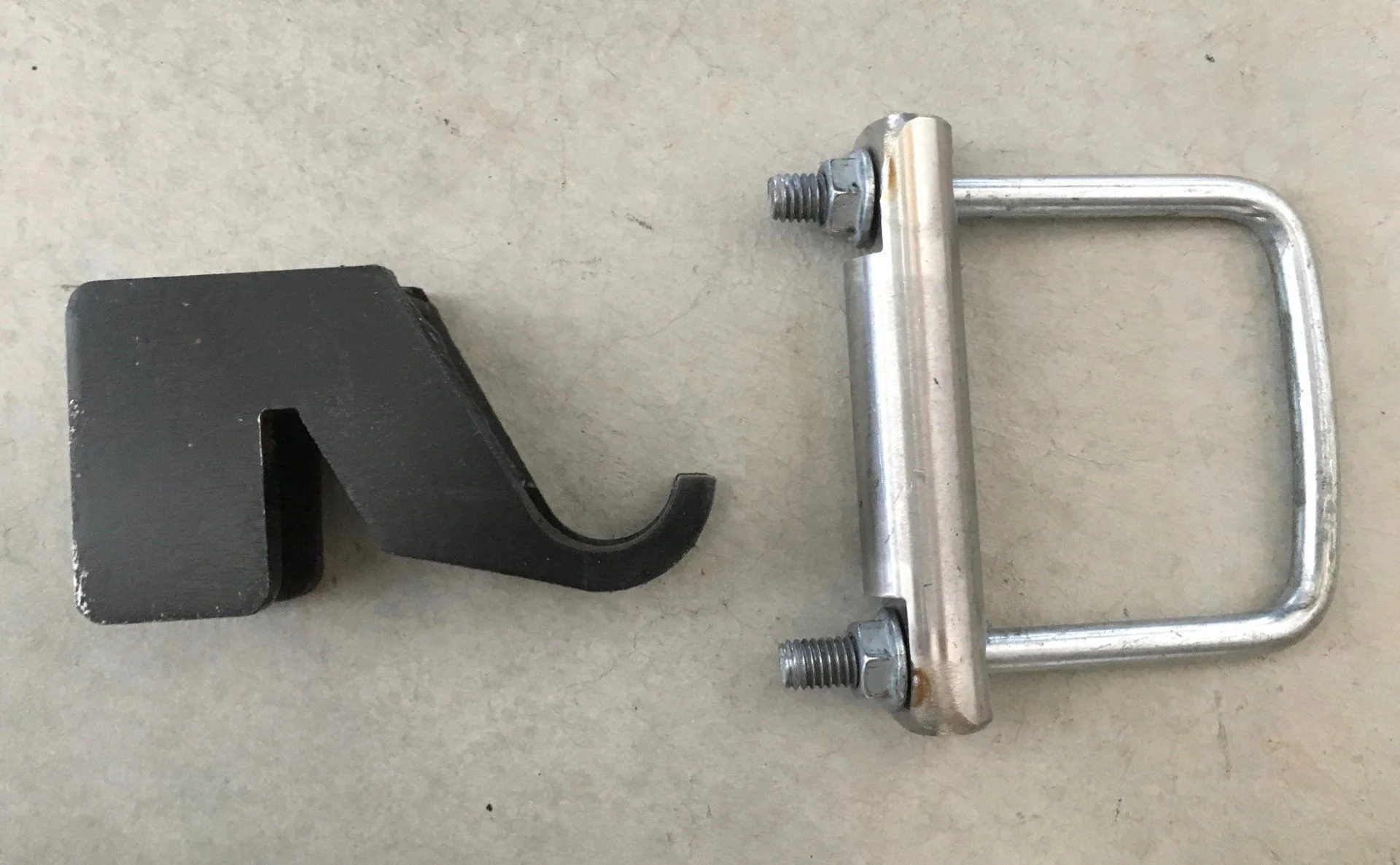

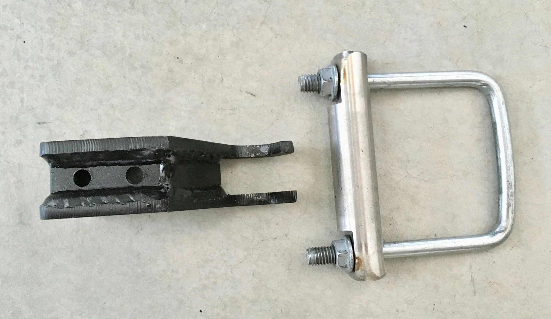

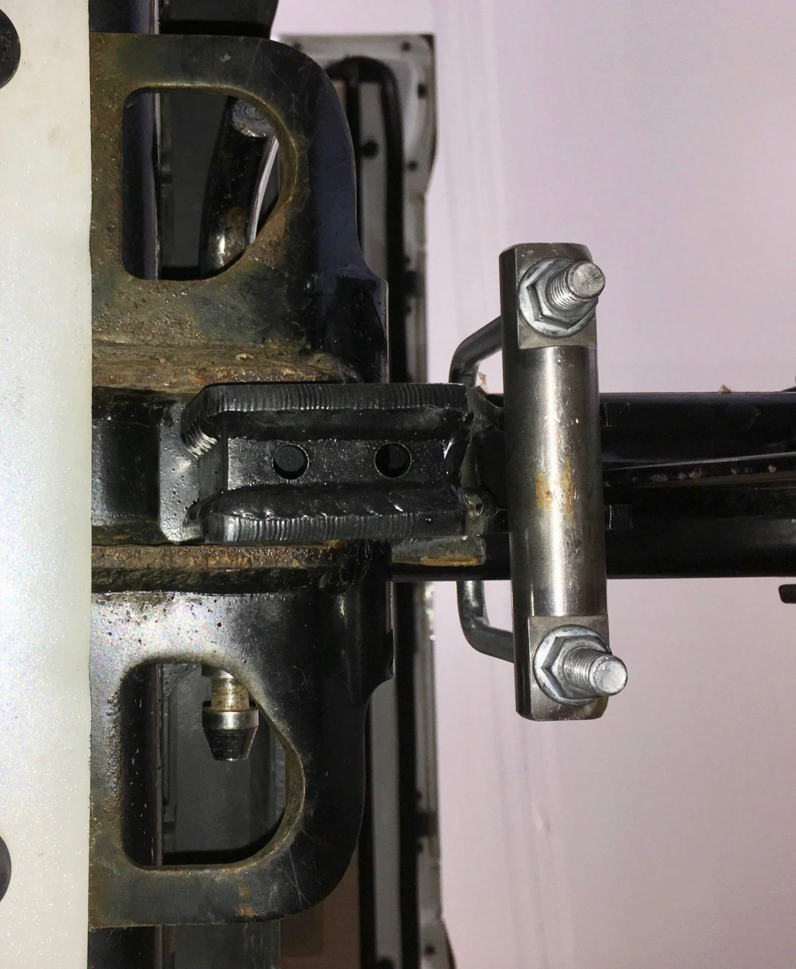

I had my airbags installed today by a local race shop (Hazzard Fab Worx - a great bunch of guys) and they made this up for me for $50. It plugs into the rectangular cavity under the OEM receiver and supplies two beefy hooks for the U-bolt style tightener to attach to. I have not towed anything with it yet, but it appears to be beyond rock solid.... no dinky spot welds from these guys. LOL.
Thanks for the comments, I am now good to go, without rattles.

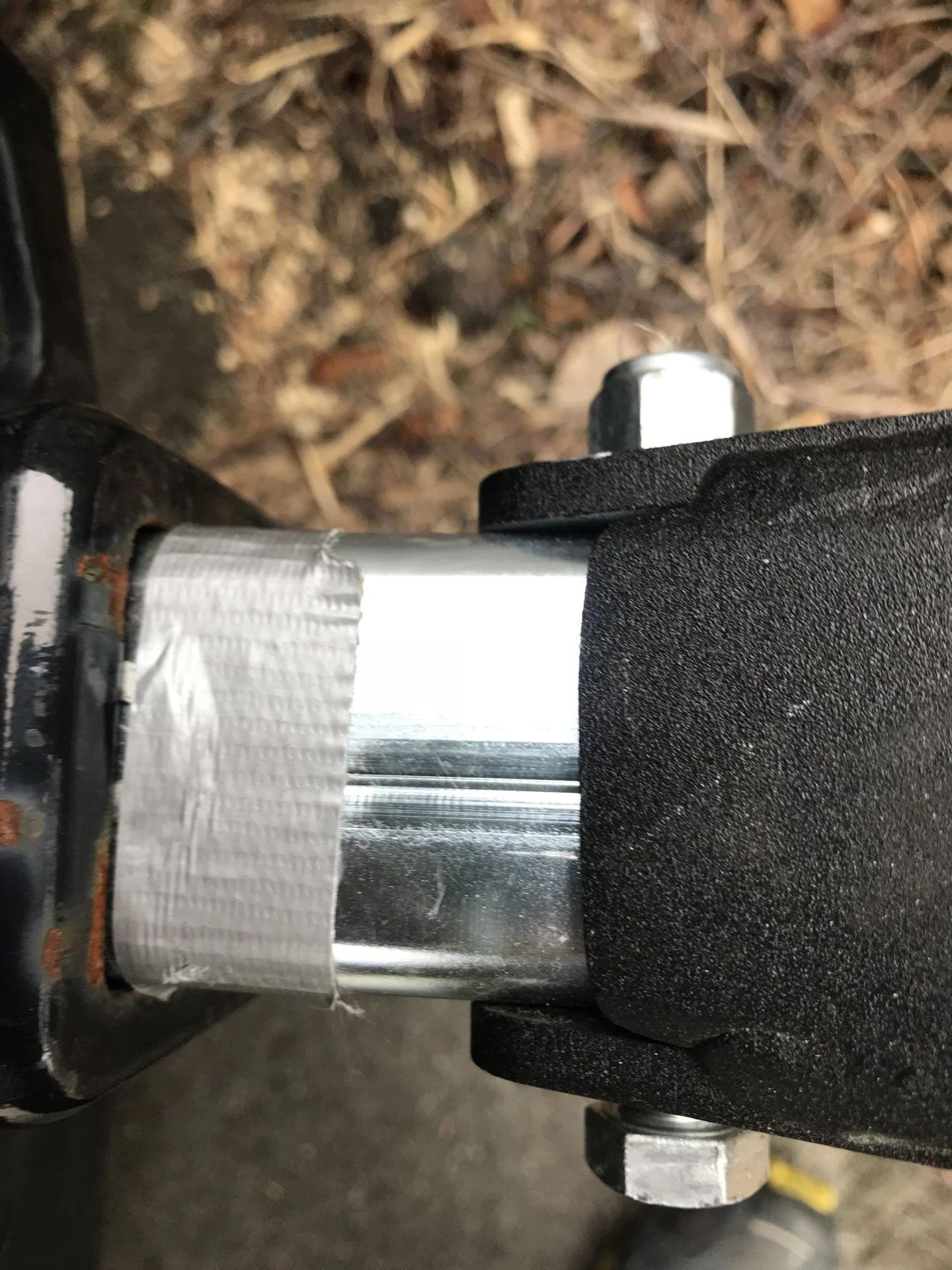

If you only have a little movement, wrap the end of the receiver hitch that you insert with a couple wraps of electrical tape. I did that on my old hitch with my Acura and it eliminated the slight movement and kept it very quiet as well (and cost about $0.03).
I wanted to thank John E Davies. I contacted his fabricator and they welded up one for me. I used it this weekend for a rattle free tow experience! Thanks for posting up....
Can someone share the contact for the shop? And also what are they calling this so I can know what to ask for.
