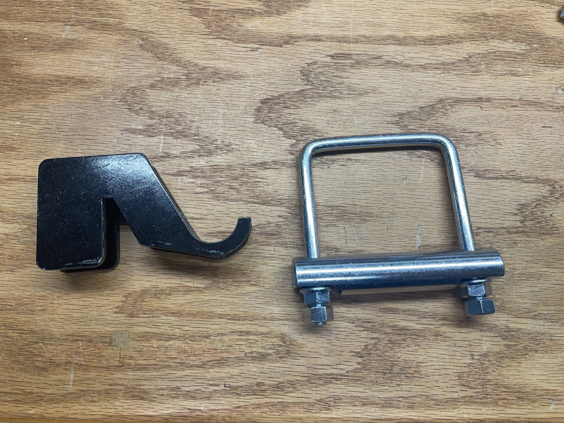

I don't think that anti rattle hitch will work on the 2016+ versions as the frame on the 2016+ doesn't have the same build under the hitch for that part to grab onto. If you are going to go order one I would suggest first look under the receiver area on your LC and see if that is also the same as pictured.

i am a little surprised that they are selling these over the counter. I thought mine was a one off. I suggest that you just describe it as a Land Cruiser 200 hitch anti-rattle device, send copies of the pictures I posted here, and a picture of your hitch. Mention my name if you like.
Other than this, I can’t do any more.
I can comment that no tape, stuck down washers, eTrailer side mounts, bead welds or other devices will be as solid as this once it is in place.

Any decent steel fabrication shop should be able to reproduce this if they have your truck there to guide them. It isn’t rocket science. It doesn’t have to look exactly the same, it just needs to be a stout S shaped hook that can enter the bottom cavity while giving the antirattle u-bolt something to grab onto.

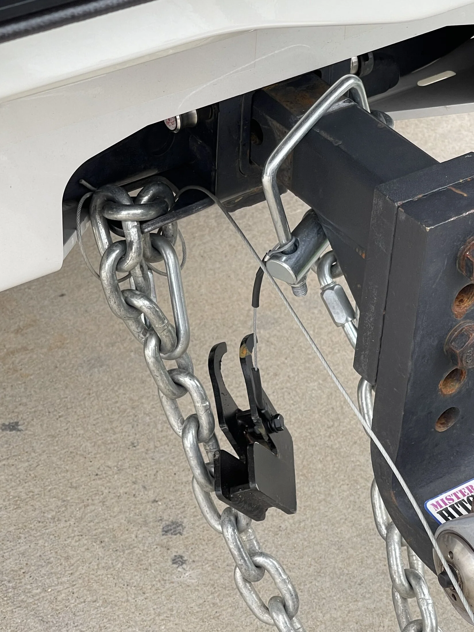

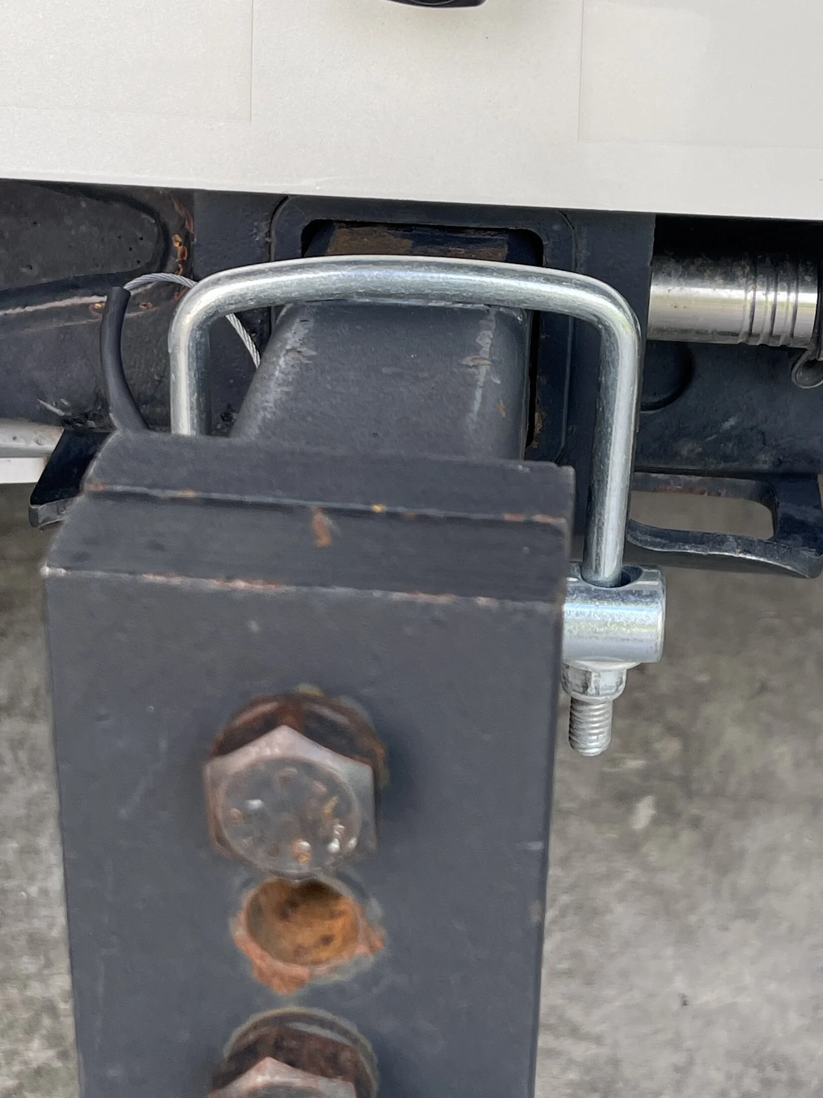

I just can’t seem to get this thing to stay attached. My first one went AWOL completely so I reach out and they sent me a new one with a retention cable at a discount. It works for a while then slowly loses purchase and works way off.
When it does work, it’s rock solid.
I doubled up on the U bolt with nylon locking nuts. Works great.
I have nylocks on there and it’s so tight that the U bolt will bend. I think my issue is the other end where it goes up inside the hitch towards the towbar. Does it need to make contact with the towbar or is it just hooking there… it’s not tall enough to make contact with the towbar.
