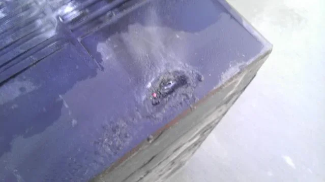

So your motoring around the woods(mall) just go done shooting guns(finding a parking space) and all of a sudden you become very happy that you bought all the fire extinguishers from GI Joes before they closed and you now have a hole in your battery.

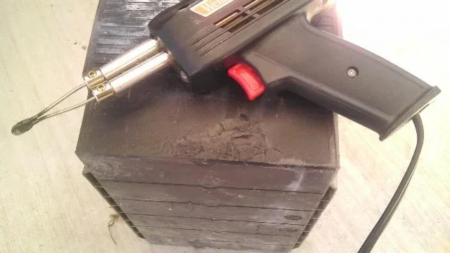

Required item: rag, side cutters, fire, something metal with a handle and a flatish end, water(distilled).

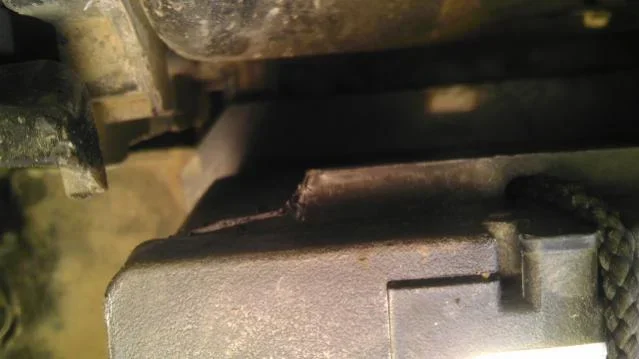

Action: Clean hole with rag, cut piece of batter away to be used as filler and trim to size of hole, start fire, heat metal thing up many times to melt filler plastic to the body of battery, top off battery if no leaks, get home and use trusty Weller solder gun to clean up battery and forget about it for the rest of time hopefully.
