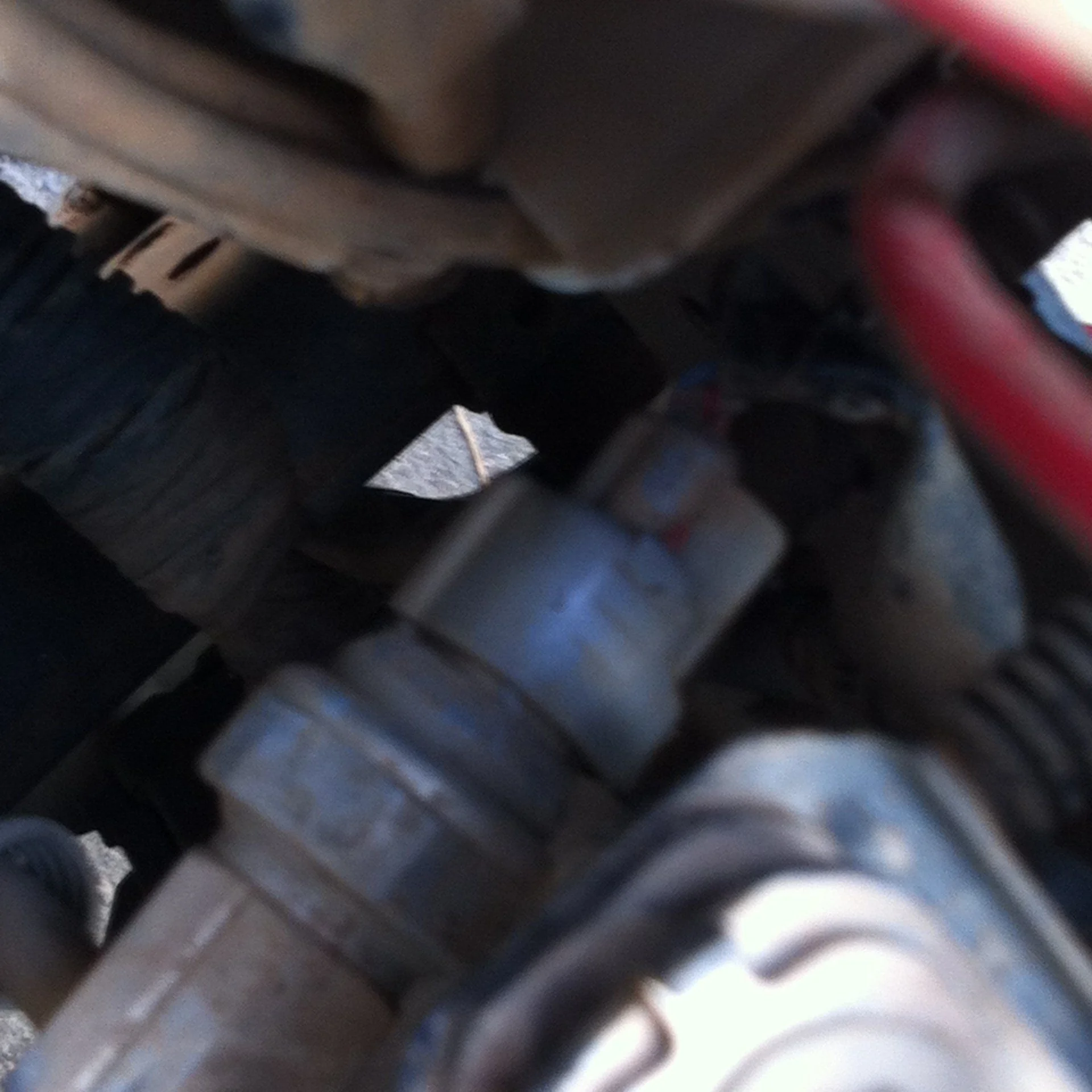

My air con in my 2008 vdj79r has stopped working and the fuses are ok here are some photos of the ampl
be my next job .any idea where the pressure switch is .a suggestion was at the front near radiator .also received a suggestion to check behind the battery or relay or fuses.

Picture of the pressure valve near the front radiator .on one side it has a blue and red wire which had 13v on it and a red and black which had 0v when motor was running and the red and black wire was connected to battery + .the compressor started ok so it looks like i have lost the gas .
