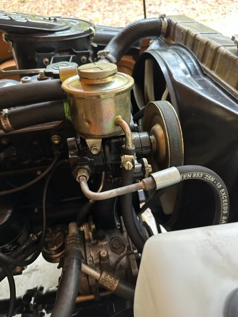

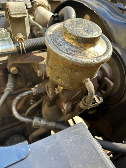

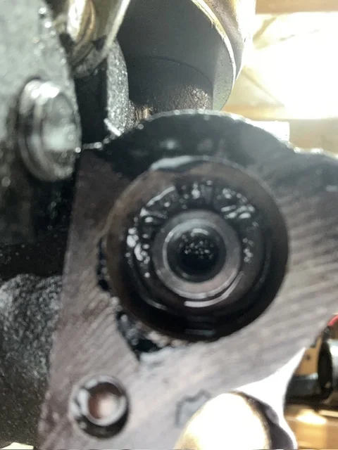

Does anyone know the toyota part number for a power steering pump rebuild kit and whether or not is is available through a dealer of toyota parts vendors. My particular need is for the flow control valve assembly. my problem is a drip while the truck is just sitting in the garage…not under pressure ..it’s just hanging out
the 2nd photo is where the leak is.

Good luck to you. Keep us posted. I attempted to look up the part number at NAPA that you referenced, but came up with no matches. Many of us are looking at alternatives to the 60 pump. Ours are old and failing and the new ones are super expensive if you can even find them. In your second post, you mentioned finding new ones from between $325 and $825. That has not been my experience. Rebuilt possibly, but not new TOYOTA. Rebuilt pumps will likely not have the brass bushing replaced, which is often times the source of leaks on these pumps. New pumps are $1,500.00 and out of stock in the places I have looked. The best solution that I have found is a Saginaw conversion using the conversion kit from Georg.
@roadstr6 i have seen each of the pumps you mentioned. The pump for 325 is the vane pump minus a reservoir and pulley. Amayama SAYS its Toyota and is something around $833.00 with shipping to the USA. I found the NAPA pump on their web site using the #38-5475 with a simple search. They have 2. One is $114.95 and the other is $329.00. I am taking a chance with the NAPA pump first. If it works , it would be a simple option. I have also seen the $1500.00 out of stock units on web pages and out of stock does no one any good.
it appears the o-ring on the reservoir needs to be the correct fit to prevent leaks. The best video I have seen is the one from @40channel who details every aspect of the re-build very clearly. I have inquired about the rebuild kit part numbers but have no answer so far. The biggest detail there is that brass bushing. I don’t have any machining capabilities here but if those dimensions are readily available, I’d have no problem finding someone to make a 100 of them 😀 …. I am sure that many others could use them

the NAPA pump arrived the next day… when comparing the fittings to the original, there are differences due to the later year FJ45 I am using this on. The photos below show the differences in between reservoir tank mounting .
The left photo is a 1979 FJ45 …..while the right side photo is the pump I need to replace in a 1985 FJ45. If I was replacing the 1979 FJ45 pump, it would be a direct replacement….If the new NAPA pump had the mounting holes for the reservoir on the front and rear, it would be a very simple swap. However, it has the reservoir mounting holes on the front and side At 90 degrees. I am not even sure this is the correct power steering pump to this ‘85 FJ45
The rest of the pump will mount easily and the pulley aligns with the other belts. I am thinking to make a simple winged bracket that will bolt to the new pumps rear holes and extend to mount the wings of the newer style tank to this auxiliary bracket….so I am no artist but this should convey the idea..all predicated on the un-availability of the earlier reservoir tank. (they are available however) 44306-60031 Reservoir, Oil(For Vane Pump), Toyota. It just needs to be shipped here so this idea is only if the reservoir were not available

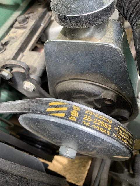

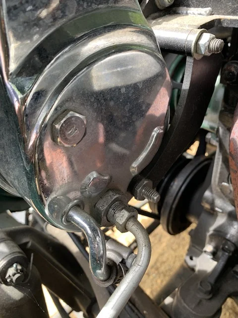

think this is on topic, but wanted to ask if any one knew the fitting sizes on an aussie hj47 "toyoda" steering box fittings, and the fittings for the other end at the saginaw pump? I need to get new hoses made at 60" as its RHD and I cant find any long hoses for sale. PO had the hoses just rubbing on the corner of the battery tray, and now its got a tiny leak in it :(
Sadly, I have 3 toyota power steering pumps on my bench and my FJ40 has a Saginaw power steering pump on it…the fitting are right in front of me but I have no idea how to properly measure them. Thread dimensions ALWAYS screwed me up. But, if there is a way to do it, I would be happy to give it a try
is it possible you can remove that hose and head over to a hydraulics place. When I built my log splitter…rather than take a blind shot, they did it all and it all fit
thanks for thinking about this. I called my local hose shop with some questions and there attitude was crap, and they said I needed to bring the hose in to make me a new one, so it seemed like more trouble then it was worth , os while i ordered my ubolt flip kit from manafre I got them to make me set of 60" hoses with the right fittings :) so no need anymore. weird that no one offers a 60" hose set for RHD trucks that have saginaw pumps? hose has to go all the way from the right side above the alt, under the engine and back up to the steering box.
@calen well if nothing worse, at least you have it solved
