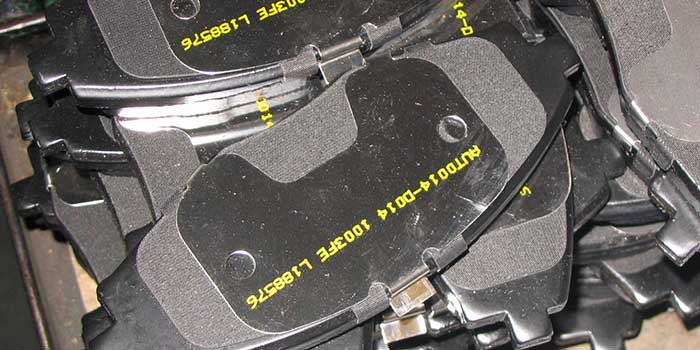

I just noticed that Toyota OEM brake pads come with a friction coefficient code of FG. Most OEM pads and aftermarket replacement pads are FF rated.
So the Toyota OEM pads are just a cut above most others in my opinion.
I really like FG for an all-around performance pad. There may be some EBC high-end pads that are GG. I try to run FG pads on all of my vehicles.
Here's a link to brake edge codes explained.
Looks like the OEM rears I put on in December are EE.
