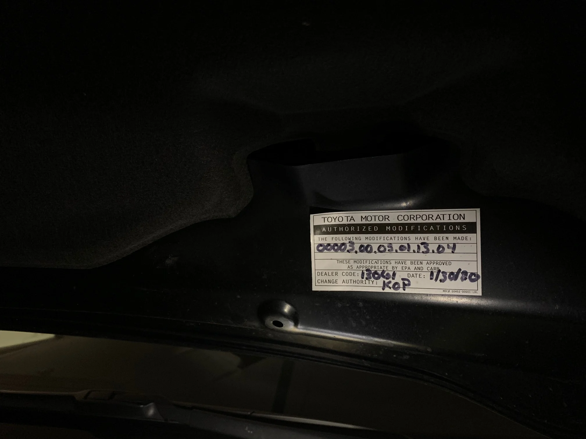

Any chance someone knows what modification was done by the Toyota Dealership? I bought a 2016 LC 200 recently and could not find anything on this (google was no help).

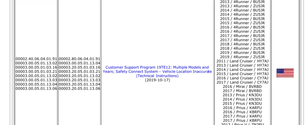

i believe this is it:Any chance someone knows what modification was done by the Toyota Dealership? I bought a 2016 LC 200 recently and could not find anything on this (google was no help).
Thank you so much, @Kinnada. Pretty sweet you were able to find this. How did you do it???service for dcm module and incorrect gps coordinates
googled the hand drawn code, filtered for land cruiser- VOILA!Thank you so much, @Kinnada. Pretty sweet you were able to find this. How did you do it???
