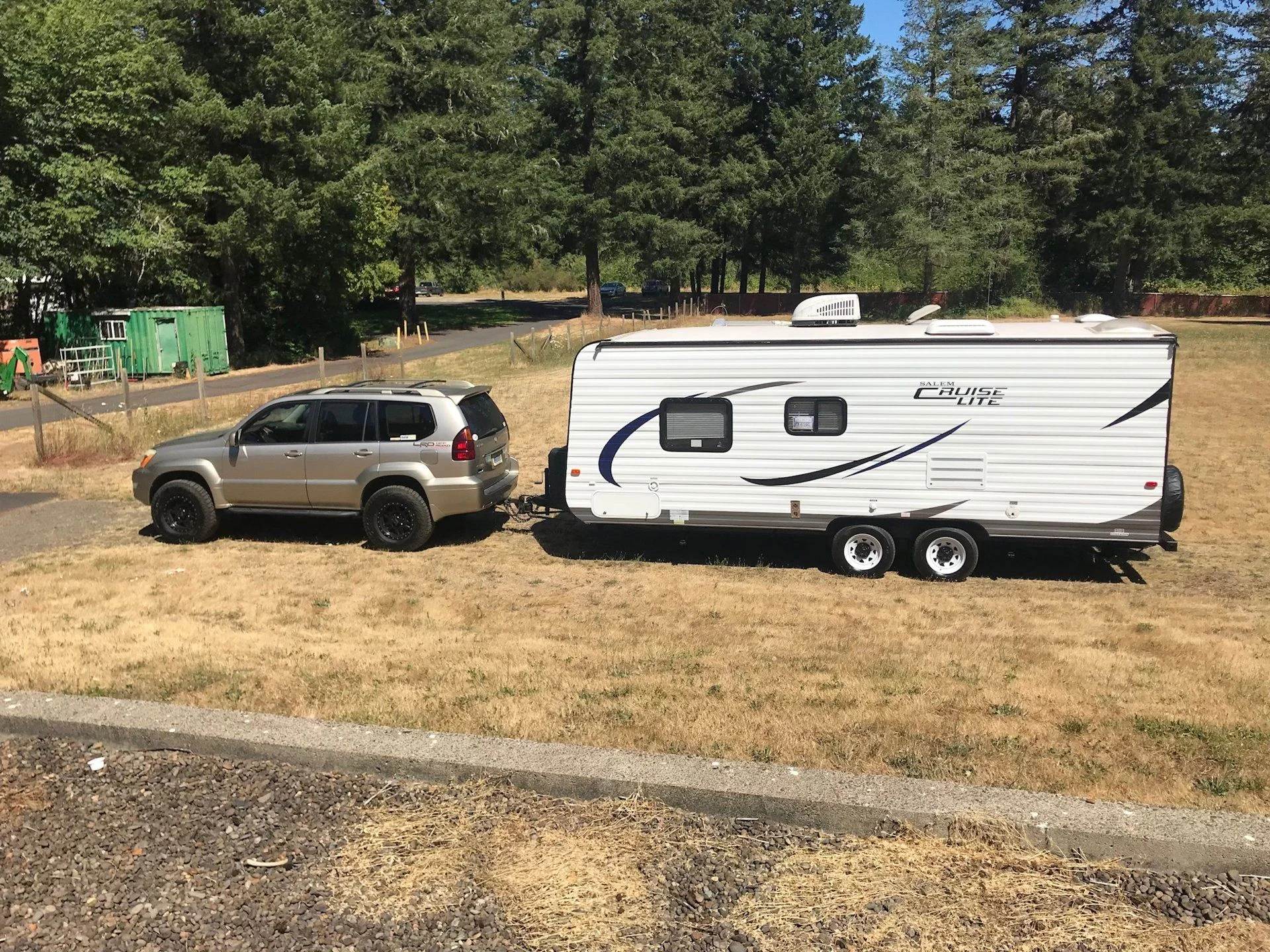

You will be fine towing that much weight. I’ve been towing a 2700 pound travel trailer for years and recently upgraded to a travel trailer that weighs 3600 pounds dry. I live in Utah and the GX pulls the new trailer just like the old one through the mountains. I also use a weight distributing hitch and brake controller. I’m also lifted and on 33’s.
The biggest issue, IMO, is how long/tall the trailer is. I towed a trailer ( once!) that had a 28’ box length and that was too much area if there was any wind. Then I went to an R-Pod with an 18’ length, and now I tow a Camplite that has a 21’ box length. The 21’ is perfect for me, especially in the mountains.

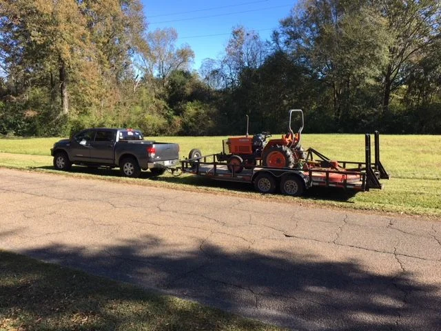

4.7 v8 will have no problem with that weight and weight distributing hitch and most important the trailer brakes and controller. I haven’t pulled much with my 470, I pull 4K lbs 25 ft pontoon boat with my 460 with no problem. Going to the beach tomorrow pulling small trailer with the 460, gas mileage will be about 14. I get about 6-7 mpg pulling my 33ft travel trailer, 8k lbs with my 08 tundra running 75mph, can’t pass to many gas stations when I do that!

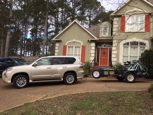

Pics, Toyota's pull great!

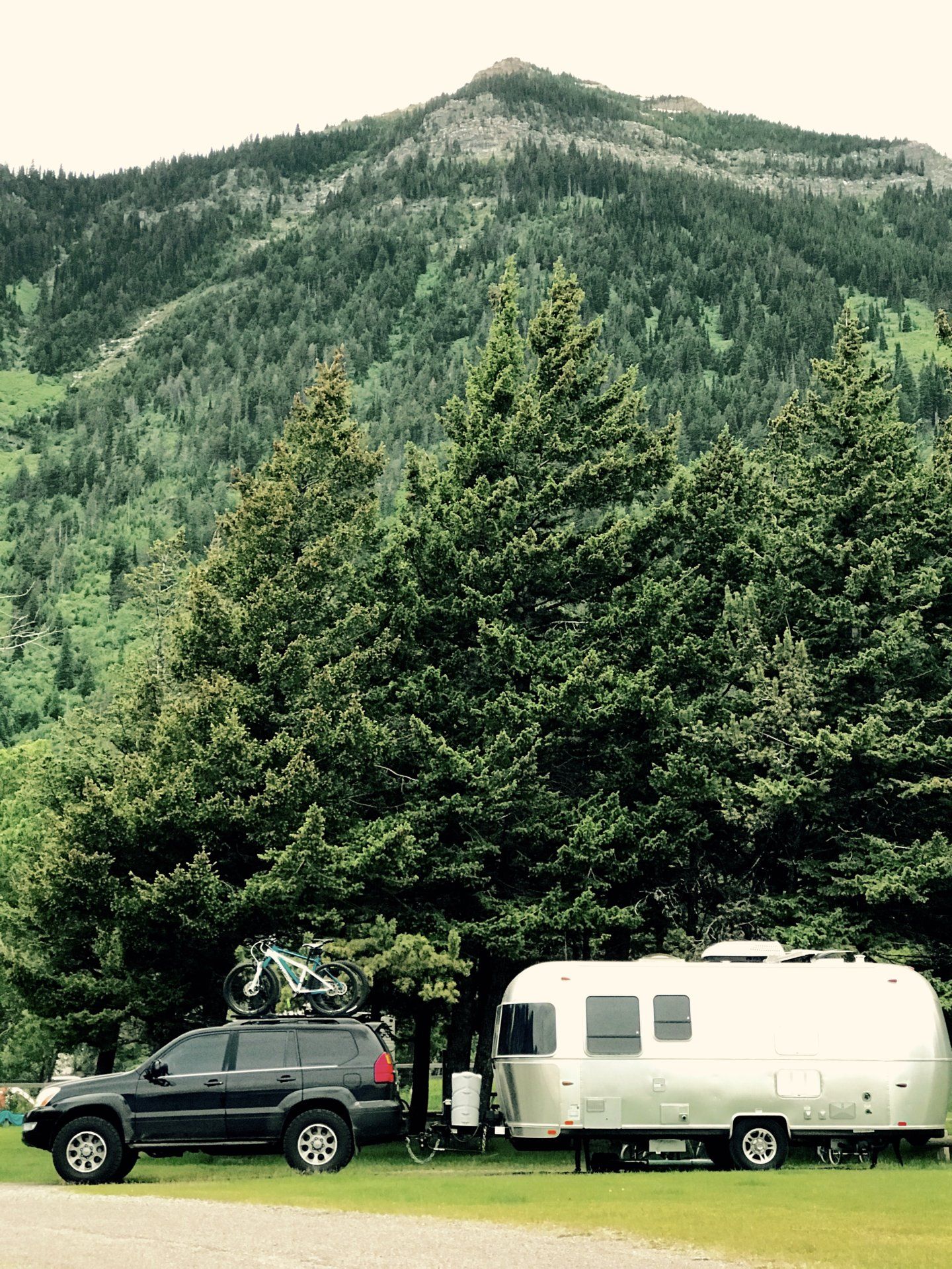

As far as I know, all GXs have a trans cooler standard. This is our setup that has been about 10,000 miles now through BC, Alberta, Washington, Idaho, Oregon, Montana, Wyoming and Utah. The GX is lifted about 2” with 285s. Take the time to make sure your weight distribution, sway control and brake control are set up appropriately and you’ll be fine. Mistakes here could cost you and innocent bystanders a lot.
I stay in 4th gear and the trans seems happy there (no hunting for gear and no overheating). I get 11–12 mpg on interstates and mountains. 13-15 on two lane rural highways.
All beautiful pictures, guys.
