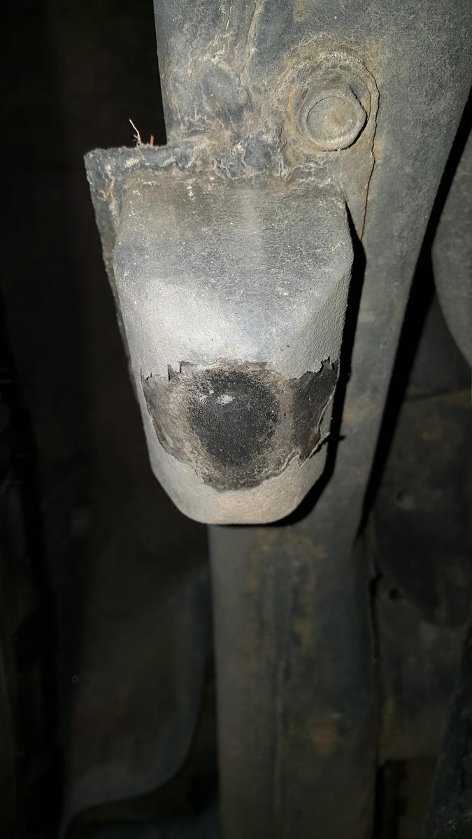

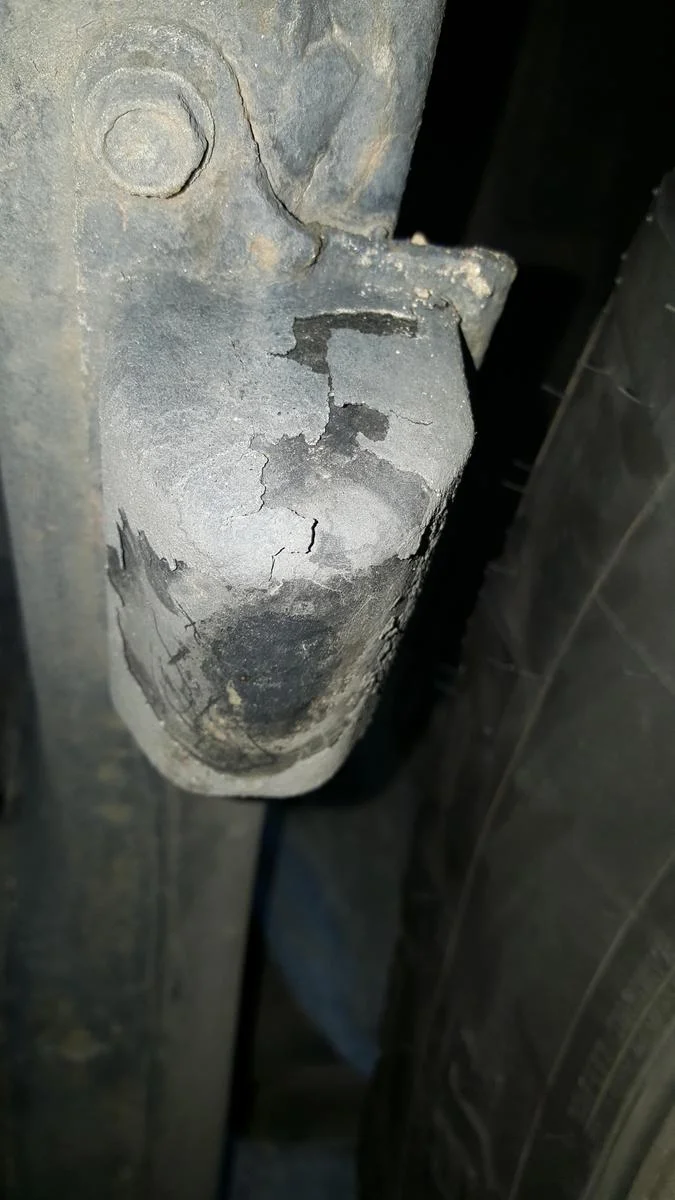

Had my 08 LC in the shop this week and they noted the bump stops were making contact. I mentioned I tow a boat and they commented it must be huge. The boat is a Yamaha AR240 that weighs around 4,000 pounds and (i think) a 300lb tongue weight. The backend definitely sinks a lot when I lower the boat onto the hitch. Is this common when towing? Any recommendations?

Do you off-road much? The bump stops you post pictures of are kind of the last resort on our trucks, and partially intended to limit how much we can stuff a wheel into the wheel well on rear axle articulation.
The bulk of the load handling and much, much more progressive “bump stop” action is done by the jounce stops within the springs. It doesn’t take much weight in the back to start to get contact on these, but they are designed specifically to hit early, and softly, and progressively get stiffer and stiffer assisting the spring rate as the suspension compresses further.
The frame stops should provide a significantly more harsh and sudden feeling when you hit them.
