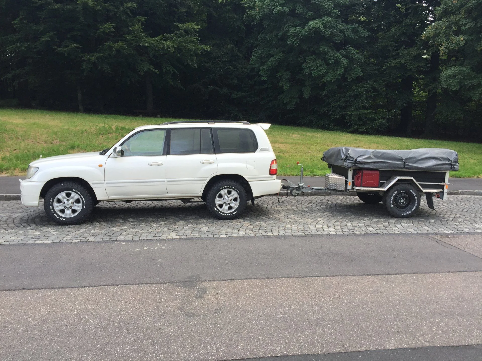

Look to the Germans, they have the best toys:
full
For you non outdoorsy types Holiday Inn is right up your alley.
You can explore other places all with the comfort of hot and cold running water, HBO and none of the hassle of renting a camper and figuring out how to tow it without grenading your tow vehicle.
