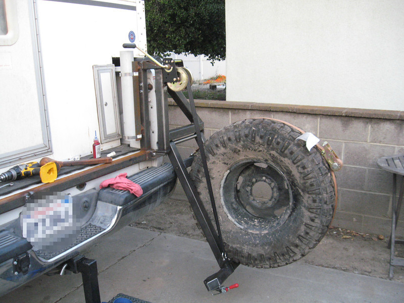

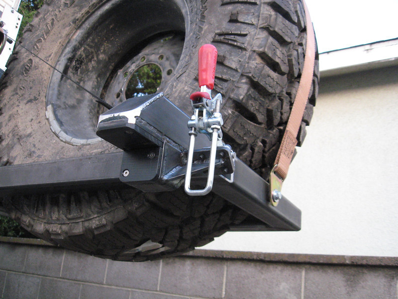

As far as rear bumpers go, the most common design fault that I see in those with swing-aways is how they latch them closed. Merely holding the swing-away closed isn't good enough. The latch also needs to share in carrying whatever load is on the swing-away. To do that it needs to pull the swinger into some type of notch or nest and hold it there tightly so that some of the load is transferred to the bumper such that the hinge isn't carrying all of the load.
An example from my previous tire carrier for our pop-top camper:
That open-ended tube was eventually capped with a plate that bridged across to the other tubes.

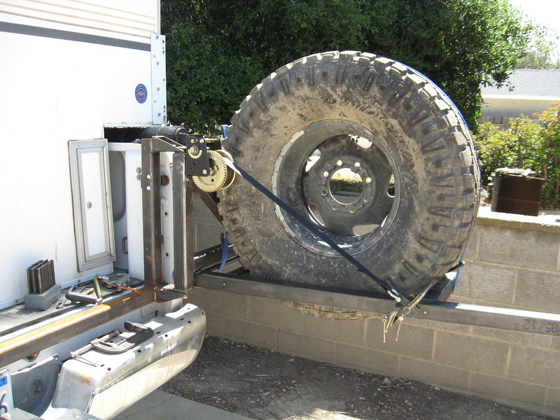

The next common design failure that I see is the hinge design. Can use a single shear design (like a trailer spindle) successfully IF it is sized correctly. This usually results in a bulky bearing housing and most scale that back to their eventual detriment. In scaling back, the spindle becomes too small in diameter and it eventually snaps off at the shoulder. This used to be a somewhat common event to read about on off-road forums. Trailer spindles have fallen out of favor for this reason.
Consider this though, do you really want a swing-away that might weigh several hundred pounds to be so free moving that a 10 mph breeze will move it? I do not. I want it to swing smoothly, but with more than a little resistance as I don't want the breeze closing the swinger while I'm in the middle. All of my swinger designs use bronze bushes for the pivot.
Example from the same carrier earlier in it's fabrication:
The pivot pin is Ø1.00", but it is significantly in double shear and the distance between the flanged bronze bushes is nearly 19" If you're wondering why there's a strap winch on the assembly, it is there so that my petite wife could change a tire if I were incapacitated.
With the tilting cradle, the strap winch, and the ratchet strap she didn't need to lift either the spare or the flat tire.
