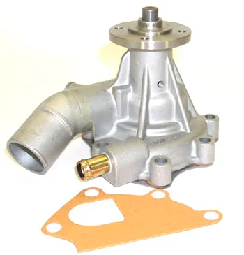

As some of you know, I'm going to be replacing some cooling system parts this weekend. Do I need a special tool to remove the pulley from my old water pump and attach it to the new one?
IIRC the pulley should just be held on by 4 M8 nuts (12mm wrench). The water pump will have 4 M8 studs on it that the pulley slides onto.
Got it, thanks. I thought I saw something in the Haynes manual about using a puller to get the pulley off. I'm glad to know that it's that simple.
