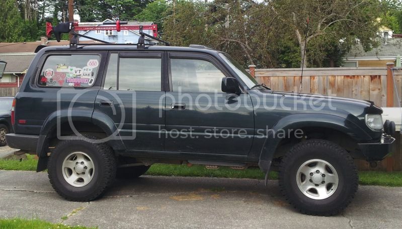

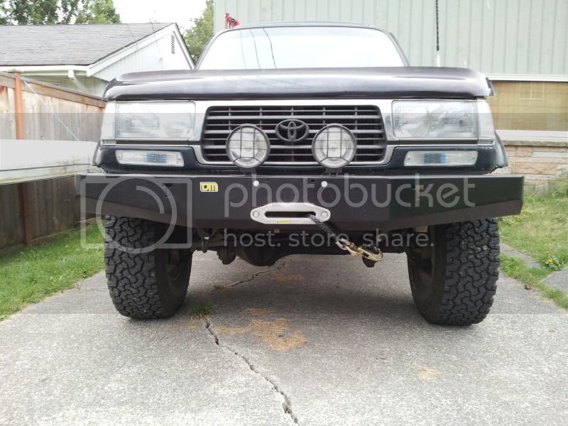

Mounted the bumper this morning. Obviously not the most protection, most jack points, or beefiest construction, but it will do what I want it to do. And I think it looks cool.
:cheers:
that looks awesome!!
like the minimalist approach.
where did you purchase? that will be the top of my list.
Nice clean and beefy, I like it .
Truck looks great thanks for sharing!

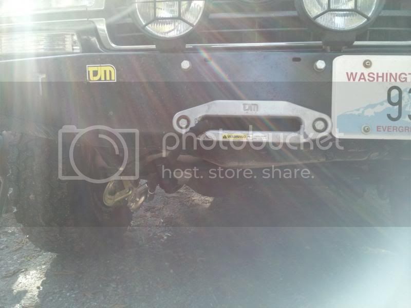

Couple of observations/complaints after mounting the winch:
First, the little plastic mount for the remote came out of the box broken. No big deal, but still.

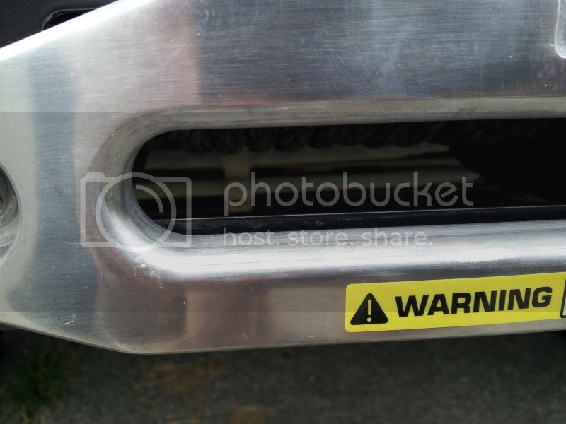

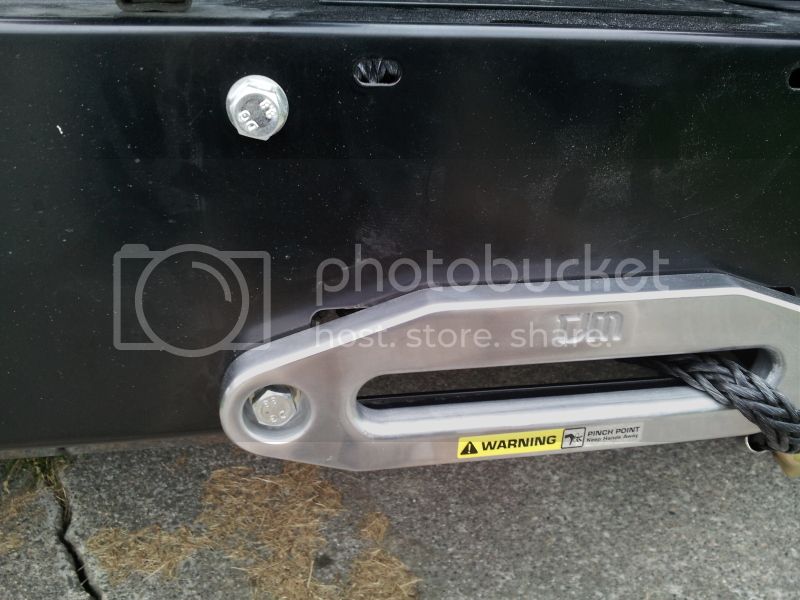

Second, the winch mounts through four holes in the bumper, the lower two are shared by the fairlead. There is little adjustment possible. When installed, the fairlead doesn't cover the entire opening for the winch cable.
On the lower end, it doesn't cover all of the metal from the bumper itself
I think I'm going to pull it off and re-size the mounting holes in an effort to raise the whole winch a couple cm.
I used the TJM T17 and 9500# winch this past weekend for the first time (outside of pulling a few stumps). The winch performed well, but the bumper... not so much. I managed to get stuck in about 2' of snow and used the line to drag myself through. The bumper got all torqued up.
I have contacted the vendor to see what they propose but I'm not happy.
