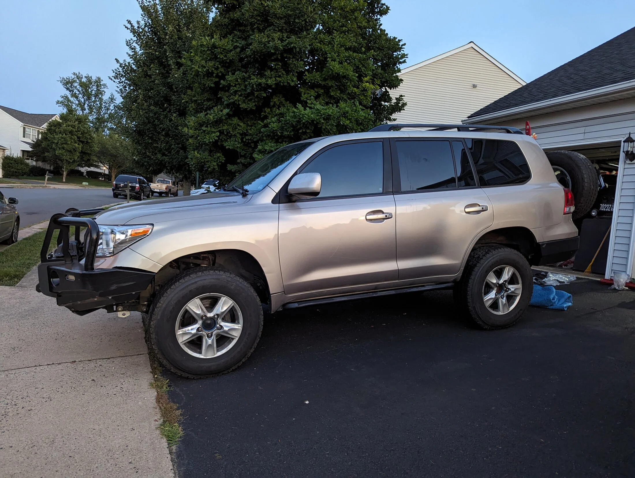

Here is what 275/70/18 looks like with an OME 2-2.5" lift. I think it's too small so run larger for wheeling.
Thanks for the reply. A thousand words…although they don’t look “too” small for my purposes, a bit larger would have advantages. I now I have to wring my hands over going 285/70 18 and hoping they fit without too much difficulty prior to the lift.

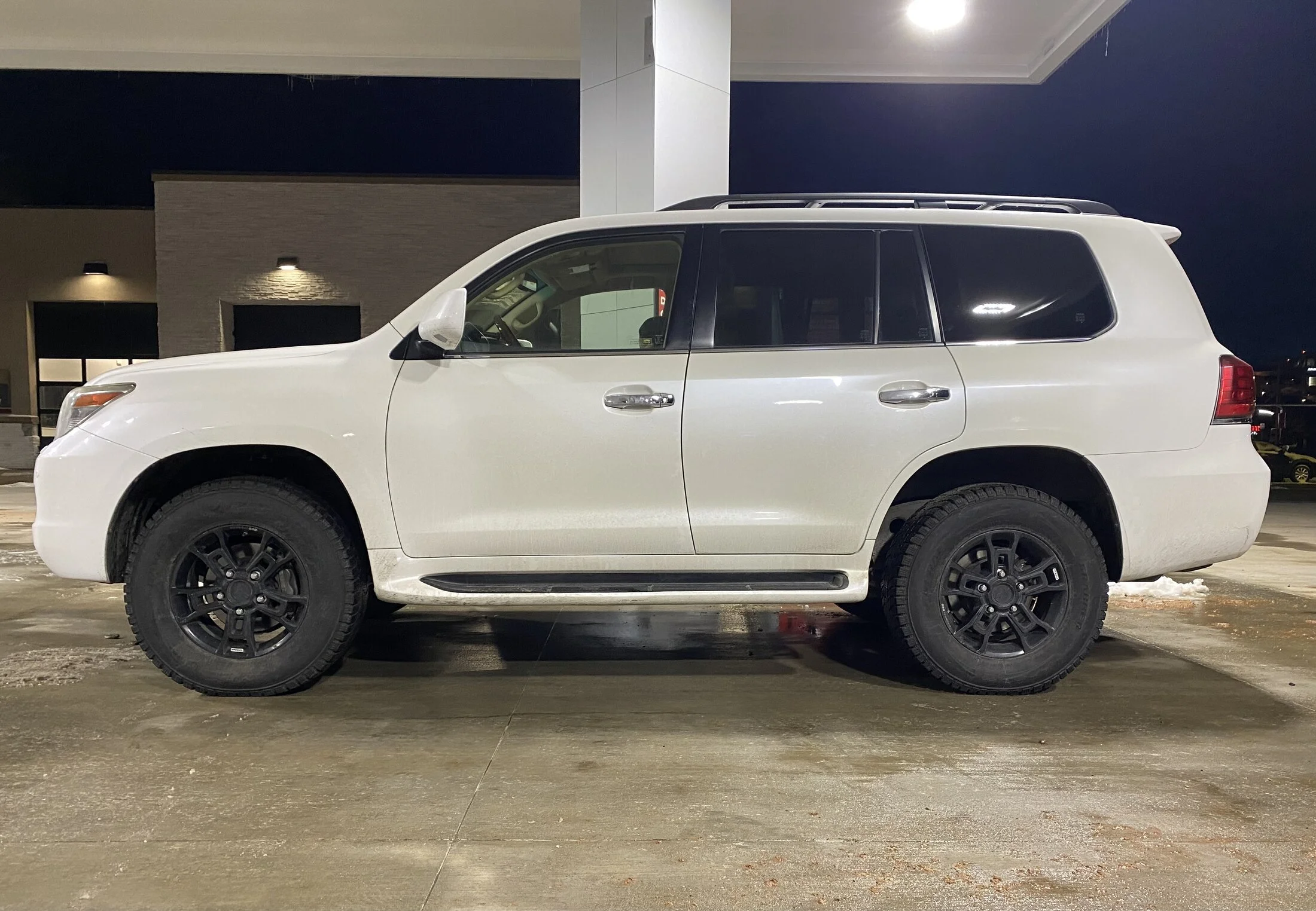

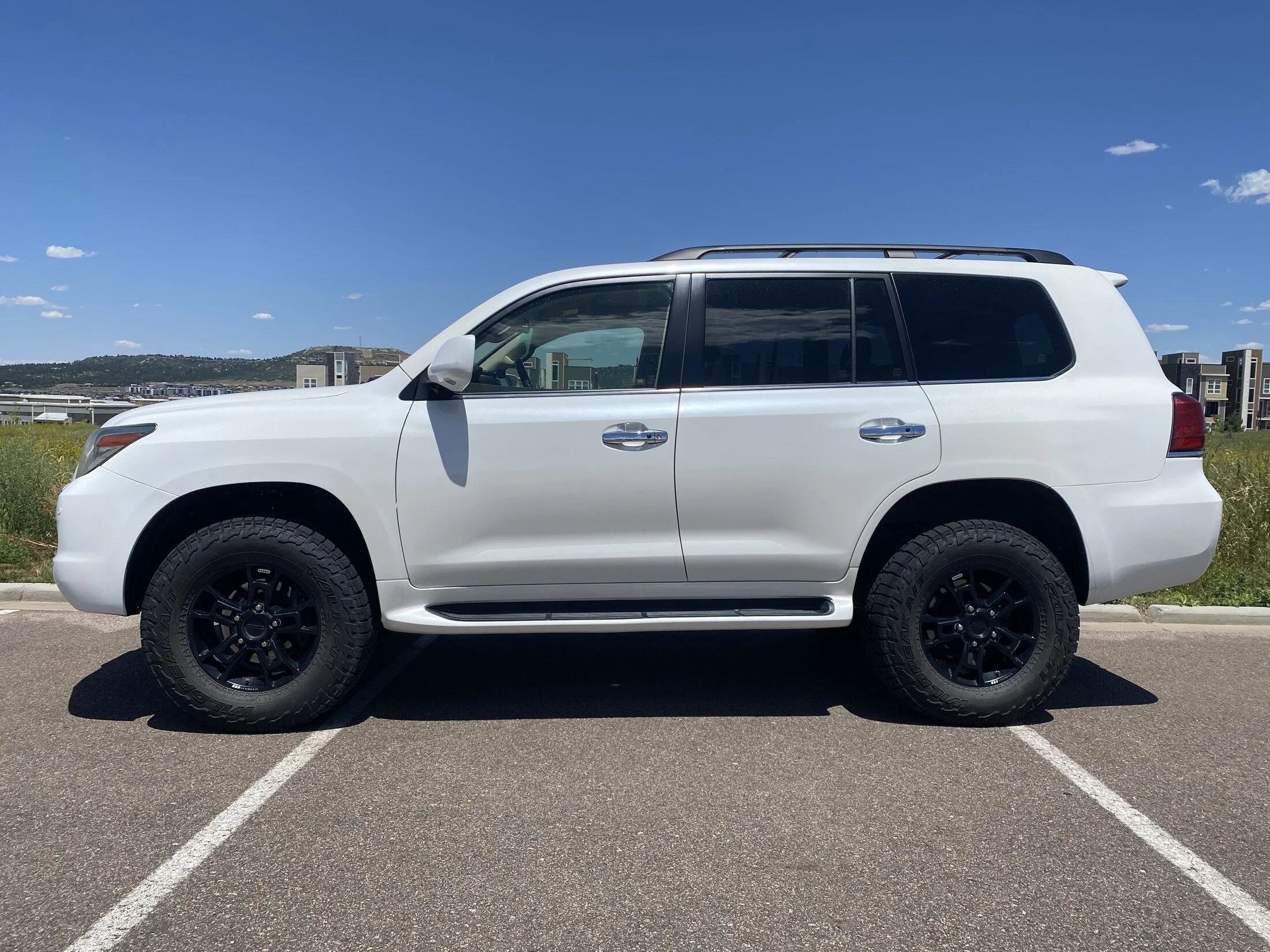

I run 275/70/18 winter tires and 295/70/18 in the spring/summer/fall. ~2.5" bilstein lift. Visually I much prefer the 295 with the lift. Certain angles make the 275 look good sized, but imo it's the narrow width that just make it seem small at other angles. A lower offset helps. It is easier to fit larger on an LX though. But even with the LX I do rub a little on my front swaybar under full lock and braking.
Of course now that I type this and have these photos right next to each other, the difference doesn't look all that much... But in person the 295s just give it so much more "presence". It looks and feels much bigger. I do plan to go up to a 35/11.50/18 next year when these 295s are worn down. I don't wheel hard enough to need more than a 33, but it looks cool and gas ain't too terribly expensive where I'm at. I'm a poser, I'll freely admit it haha
