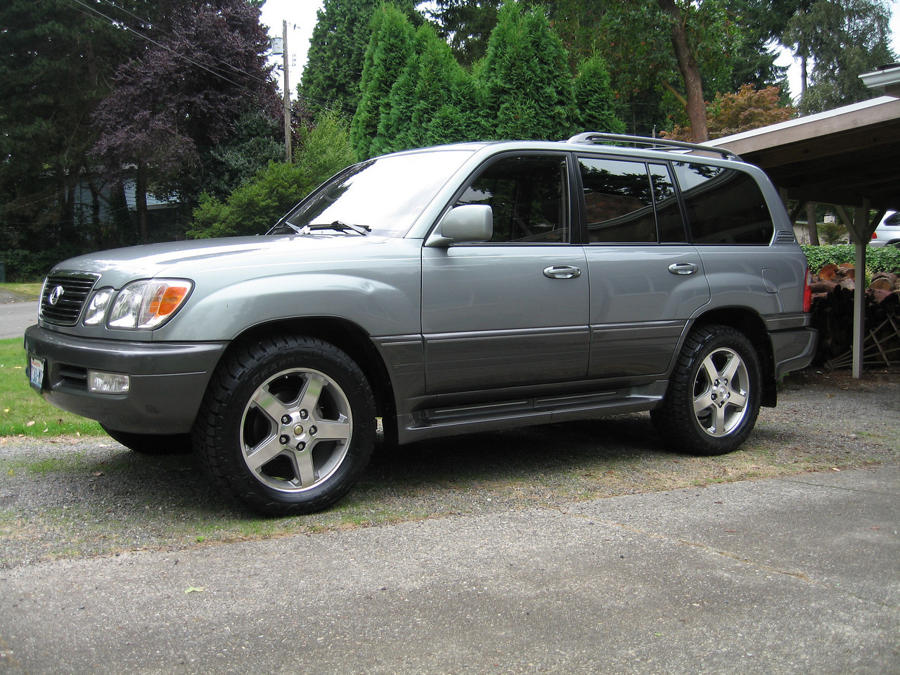

JayM sure looks good. He went with 305/55/20. I've checked the tire comparison chart, but wanted to confirm, would 275/60/20 also work for me?

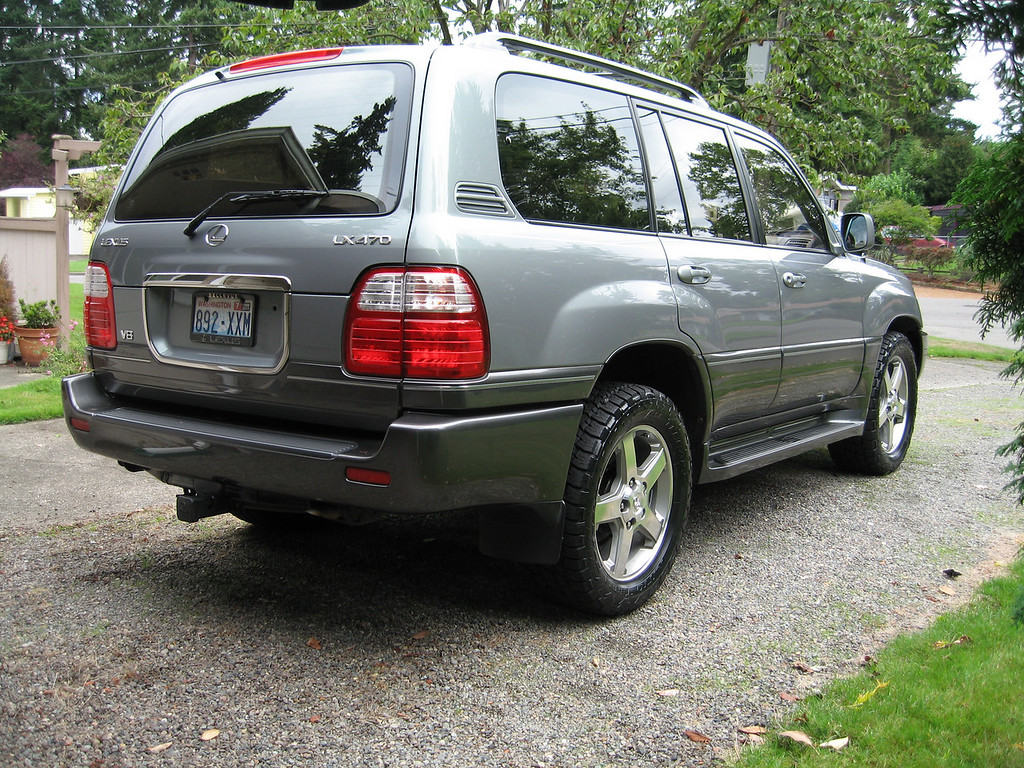

I went form 16's on the rig I pictured to that setup and never noticed a difference much. Snow was great and it could handle mild offroad stuff. Airing down can be an issue with limited sidewall. Big issue really is lack of options for tires. Not many choices and the price for tires is spendy. I have run 275 on the 20's and they just don't look as good. In fact I have a set of the same wheels pictured with 275's Michelin ltx's on them sitting in the shop that I would part with.

I have not run that size but, it is 33 inch and should fit without issue in stock wheel offset. The wheel I pictured is a +50 offset 8 inch wide do you know what your wheel specs are? Running a 275/60/20 with a +20 offset would likely rub the fender liner down at the pinch weld and on the top outside middle edge under full compression. You can use a heat gun to reform the liner at the pinch weld and use your fingers to push the fender tab flat with the liner attached on top to take care of clearance issue. Long story short if your wheel is 9 inch or under and between +20 and +60 offset that tire will work. Good size choice in 20 inch rim.
