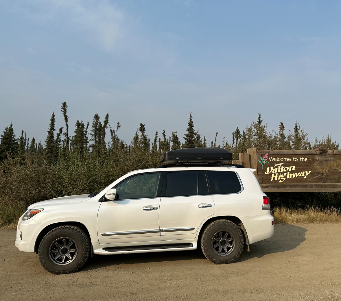

I run 285/70-17 on alphaequipt +35 rims. I did have to bend+heatgun+drill+zip tie the rear portion of the front wheel liners.

Sweet looking rig man, and thanks for the input! I was definitely leaning towards the +35 offset, seems more practical and closest to the stock wheel.
