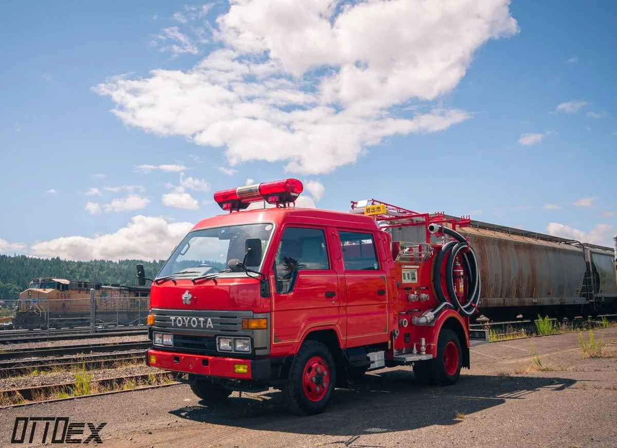

Tire Suggestions for my '94 Dyna Fire Truck

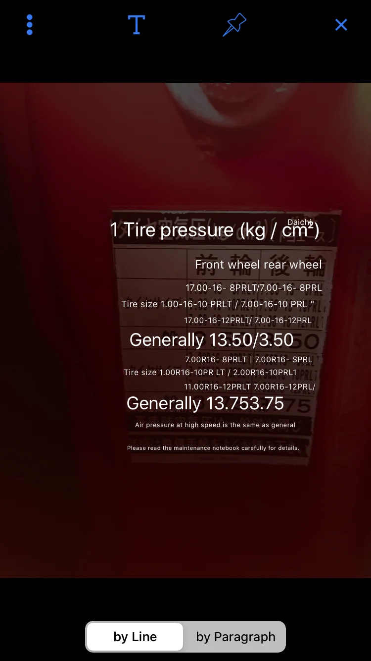

I am looking to get some new pretty aggressive looking tires for this beaute. Suggestions? 7.00-16 tires. Does the listing of 8, 10, and 12 PRLT mean that any of those ratings would work?
Presumably that’s the number of plies. I think where different versions are available of the same tyre, the more plies the greater the load capacity and the stiffer the sidewall. If you want off road performance you don’t want too stiff sidewalls.
