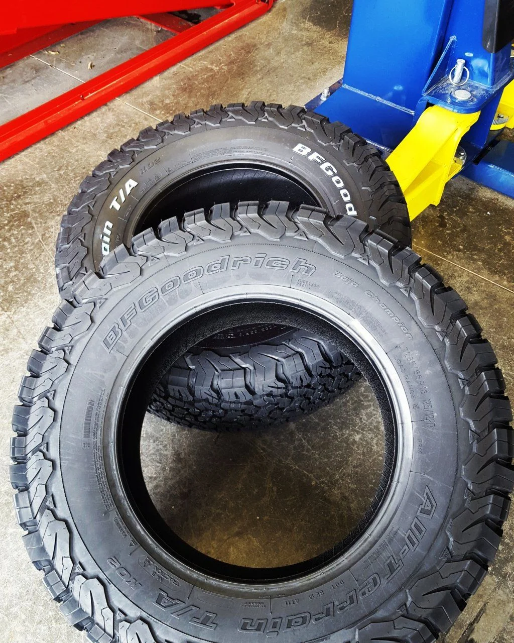

I have been running BFG 285/65r18 KO's just blew out a tire on Friday so I moved up to the new KO2's
No issues with about 50,000 miles on the KO's I expect the same from the KO2's. The tread is beefier than the original KO's. No increased tire noise that I can tell.
