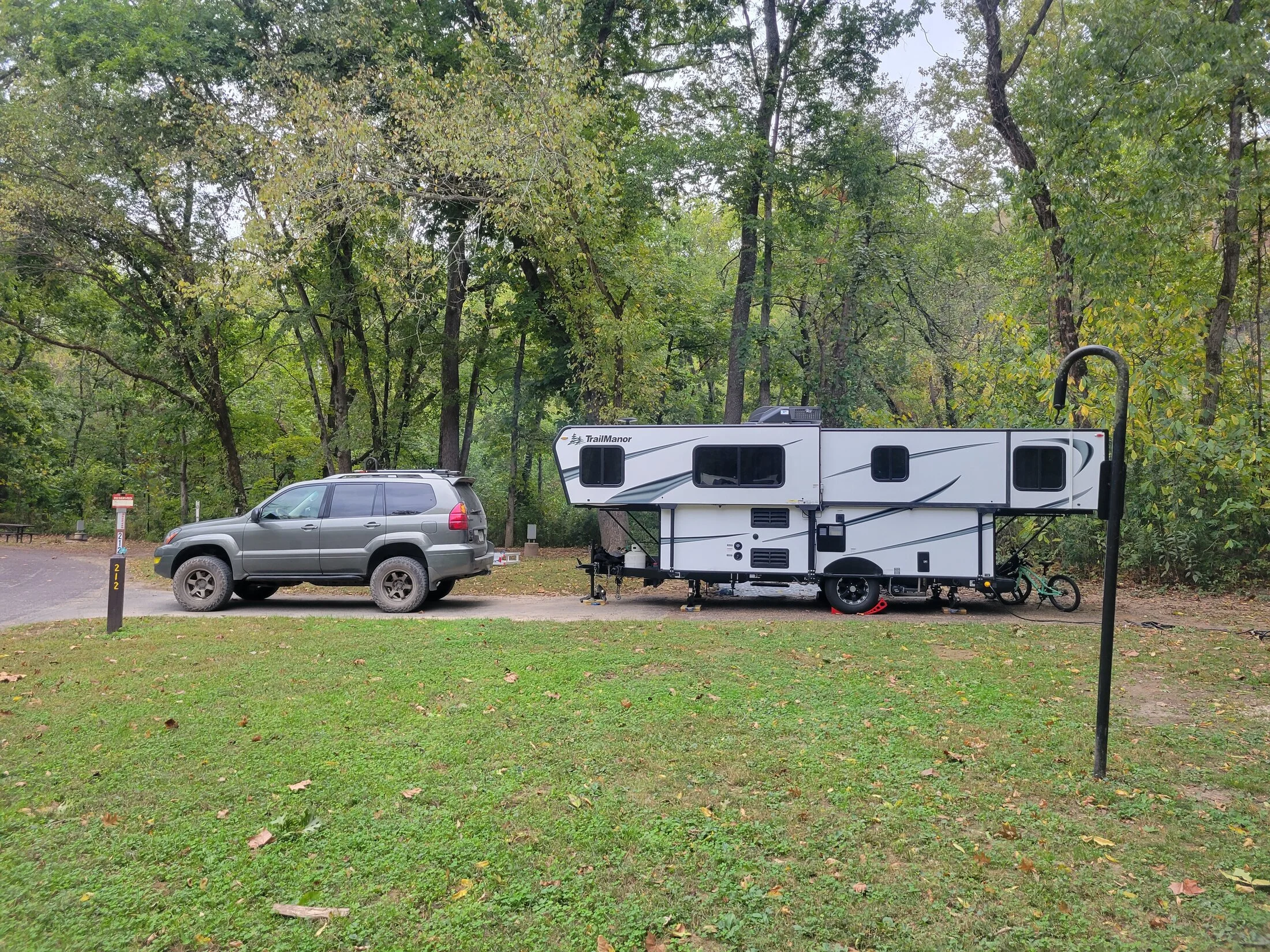

Or, consider a smaller camper. We have a TrailManor. It's really close to a perfect setup for a GX and fits our family of 4 no problem. They aren't cheap new but hold their value a lot better than most mainstream, mass-produced campers. For a >4K dry camper a pickup would be a preferred tool, although many people on here do tow trailers that big and tow them long distances.

I initially wanted a off-road camper, but they were $$$$ and heavy. I found a few that looked OK-ish but Mrs. Rednexus quickly nixed them on overall usability (there are just too many compromises to get them off-roadable). You definitely aren't going to want to drag a TrailManor down anything more than a groomed gravel road. But, there have been exactly zero times since getting it that I've wanted a camper when in the backcountry. We set up at developed campgrounds (dozens within an hour of here) that have at least electric hookups and enjoy the weekend. Sometimes we unhook the GX and go wheeling, then come back later in the day. Otherwise, we spend the day hiking, on the river, or on the bikes.
We've pulled it all the way up to Lake Superior and all of the way down to the Gulf. Next year, it will make it to Yellowstone and Glacier.
