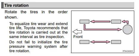

Tire Rotation--Is including the 5th tire (Spare) a bad thing --2019 LC
it could if the other tires are worn down, but it would be unlikely. a better question would be why rotate the spar into the mix unless you like buying 5 tires at once, dosnt really serve much purpose unless your only replacing 1 tire and working that in to save the cost on a tire and making an old one the spare
You get another 25% of life if you rotate in the spare, and your spare never gets old.
