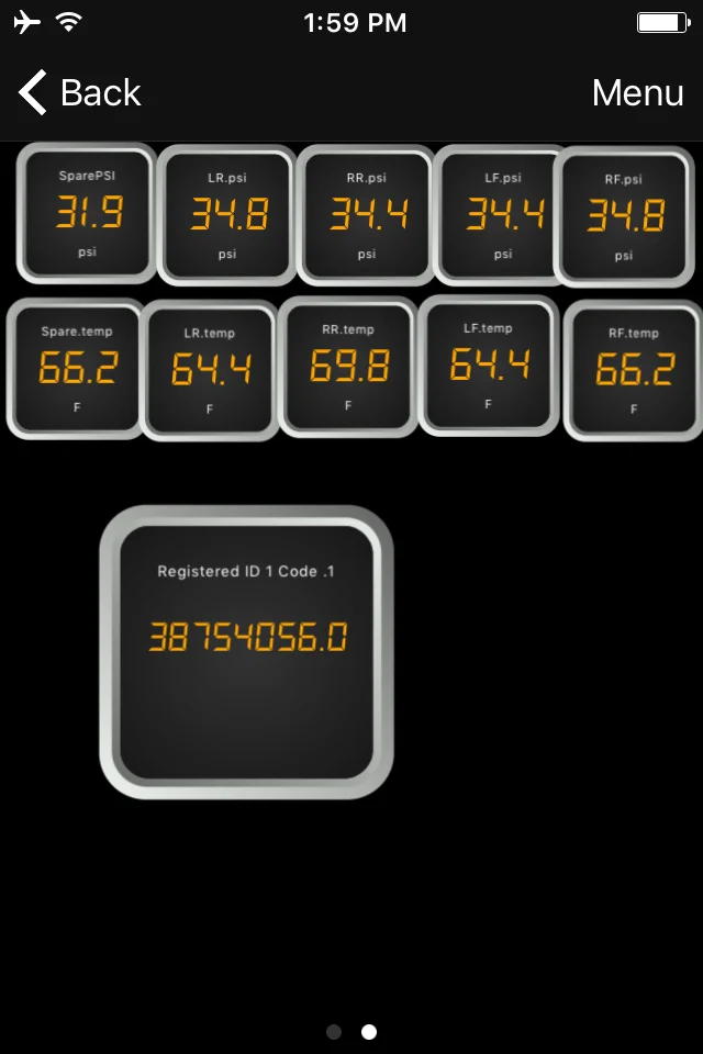

My OBD Link+ screen for my 5 tires
If you ever need to obtain your TPMS IDs and you don't have TS you can use OBDLink for that as well but have to do a decimal to hex conversion.
