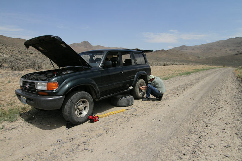

Well since I put a pointy rock through the tread on my worn Michelin LTX M/S, it's probably time to consider something more durable. I'm looking at upping the tire size to 285/75 at the same time. I know Dan likes the LTX A/T2. I'm also looking at the Wrangler Duratrac. Any local experience with the Duratrac, or anything else recommended? My biggest concerns are rocks, nails, rocks, longevity, and maybe snow. We'll be driving lots of gravel roads and trails. I'm asking for local advice mainly because of your experience with pointy rocks and also the local climate- I've had performance tires weather check alarmingly fast here, but I haven't had to buy A/T's in a long time and don't know if the harder compounds are as vulnerable.
@KWalkerM has experience with the Duratrac in our area. It all depends on what you want to do with the tires? Are you planning on doing any major crawling with them or primarily sticking to dirt roads and whatnot like your photo seems to point to?

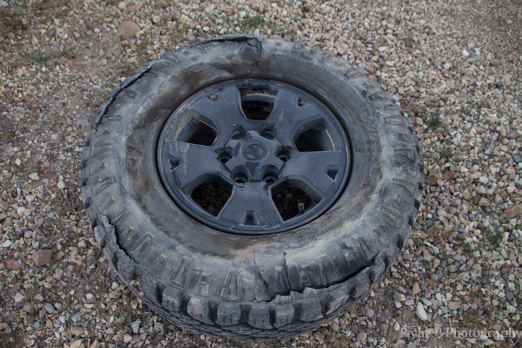

I wouldn't recommend duratracs.
