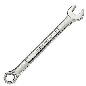

Just for this, I bought a Craftsman wrench that has 6 points instead of 12 points from Ebay so I do not round the bolt. Local Sears dont have it and took longer for them to have it ordered. Also I sprayed the bolt with PB Blaster several days before I start working on it. I
just work slowly, and manage to get the bolt out. I replaced the old bolt with new one.
