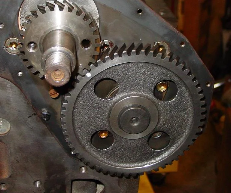

attachment.php
A solid steel gear belongs in any hi-performance 2F...........

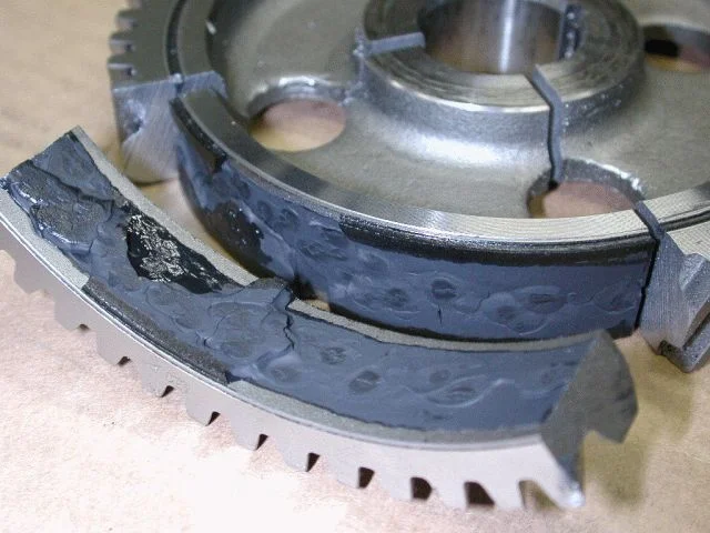

attachment.php
It takes many,many thousands of miles and years to kill that gear.... most fail because of high HC levels in the crankcase that deteriorate the rubber.... HCs are mostly controlled by the owner through maintenance of the engine...... but I see you took the short-cut and sawed it into.....
