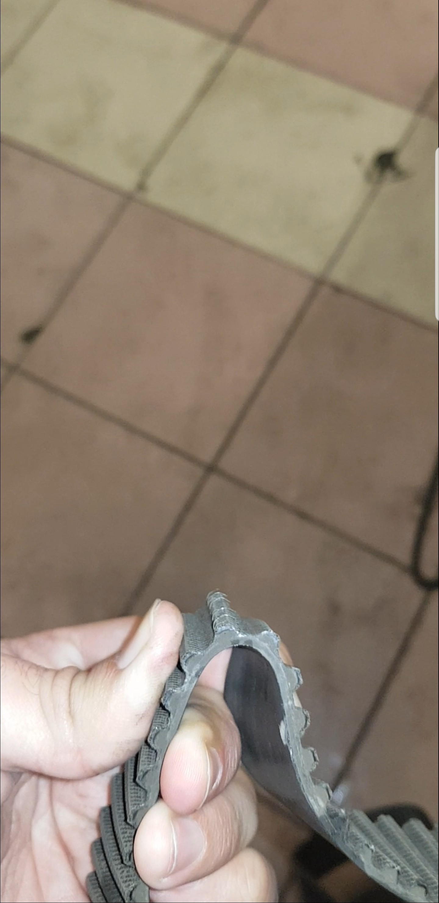

So let's take it short, everything removed, then I inspected the belt, it didn't make me feel in good shape. I am sorry for bad English I don't know the exact word to describe it but when I squeeze it in between my fingers, it's chipping off rubber like dust. And also seen some structural damage at inside of the belt, the surface which touches the cam gears.
So ok then, I am happy, I'll install a new one, but another thing draw attention, which is timing... it was a bit off. Very tiny, one tooth... But never ever done anything to the engine, we've concluded that its due to belt extension... Maybe not, I don't know %100 of the correct reason. But sure that factory won't let that engine go off the line like that. Something happened and jumped.

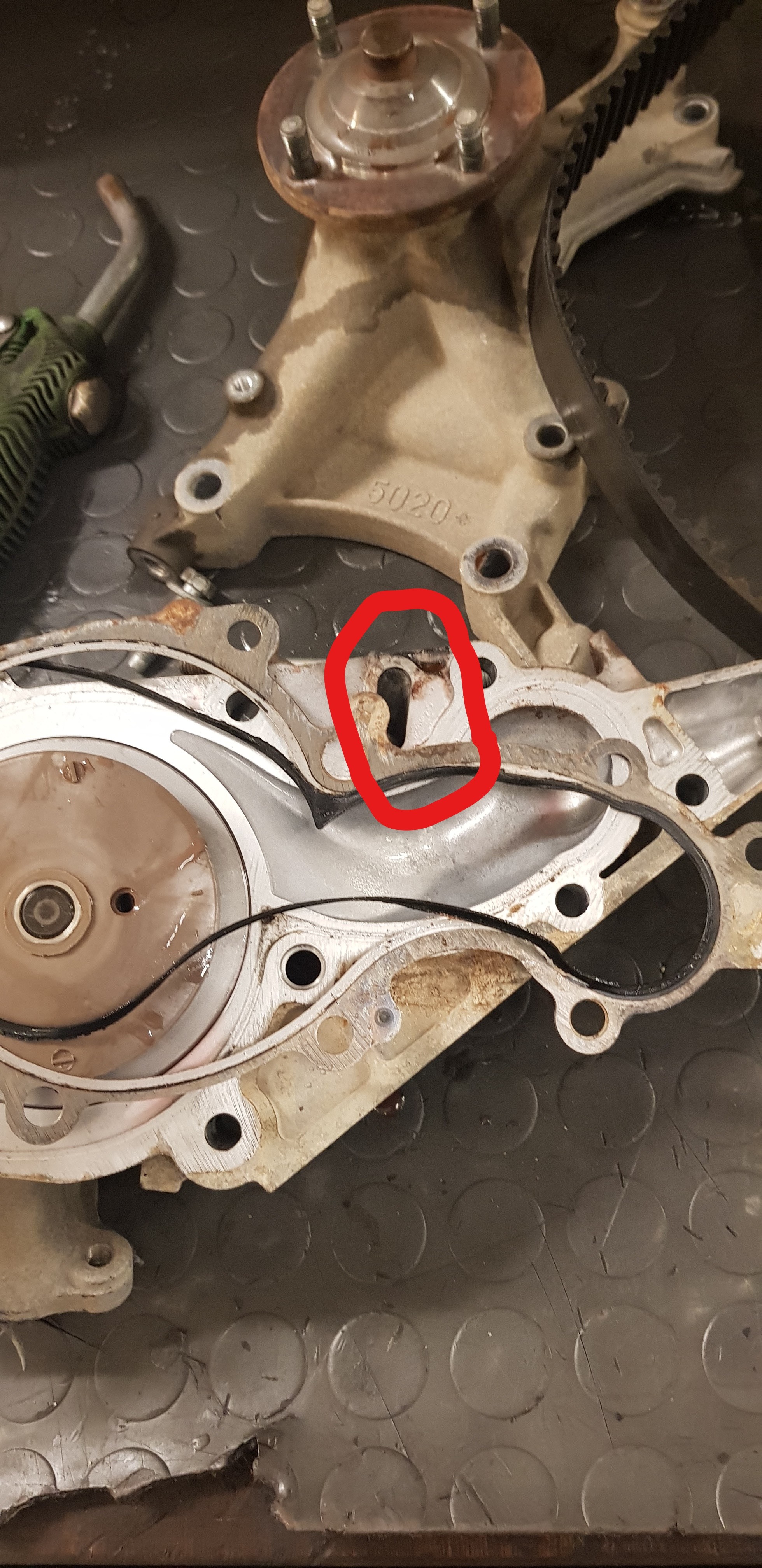

I never had water leakage, overheat or anything related to that. All was fine. But after we look at the pump, It probably had a tedency to leak, gasket was about to go. I don't know again, it maybe never will break off... In the pics, here I am sharing them for you.

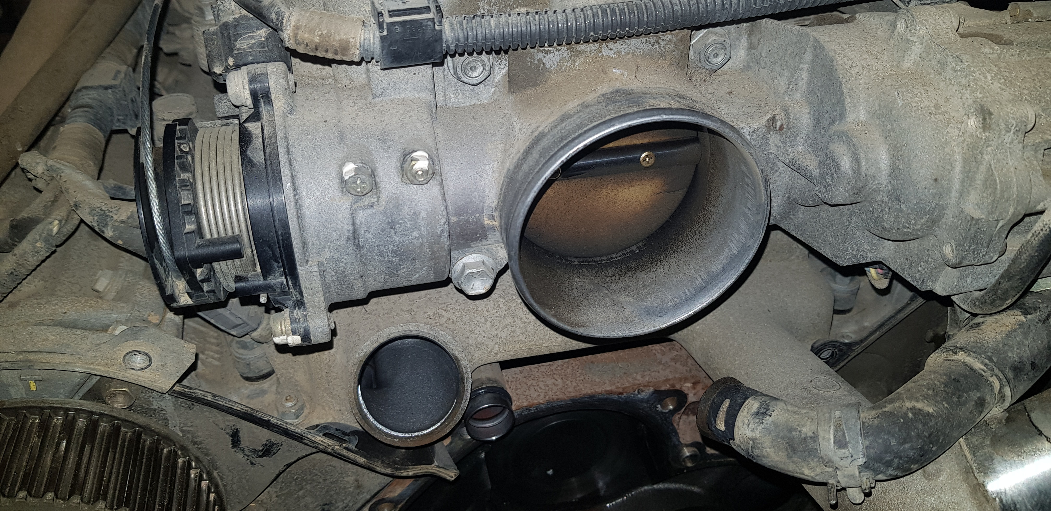

Jumped timing at the passenger side, the belt, water pump gasket the area that I marked in red. And also the throttle body, nasty, lots of carbon build up.
